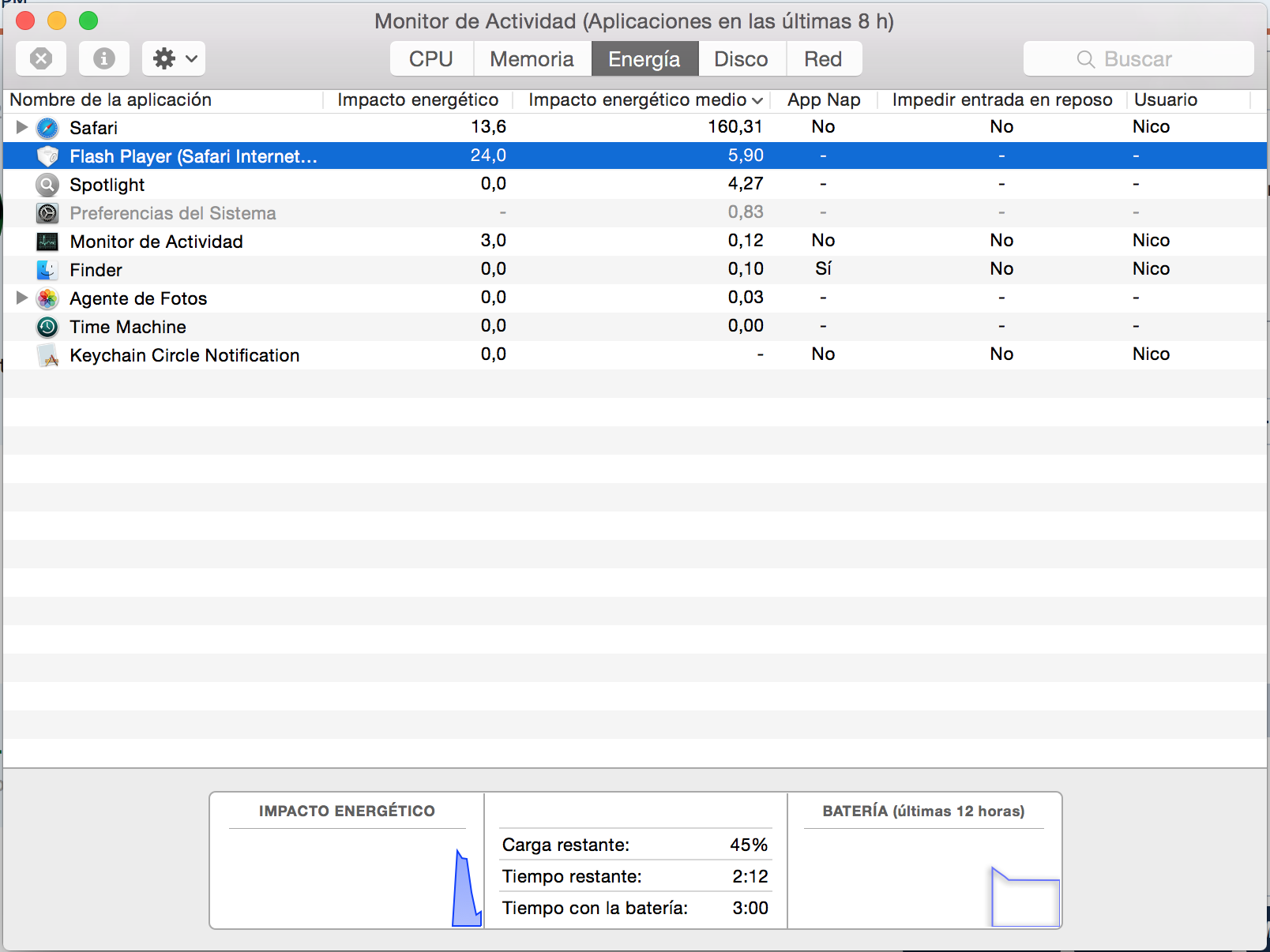

Thanks for the input, truth is I can make no sense of my battery lasting so little, I have been using it on 50% Brightness, with only safari and messages open, and after 3 hours of use my battery is 44%. The only app consuming energy is safari but a few days ago my computer lasted 9-10 hours with this type of use

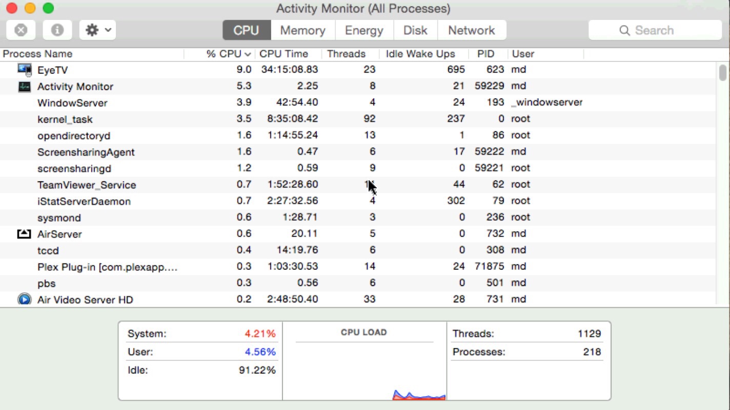

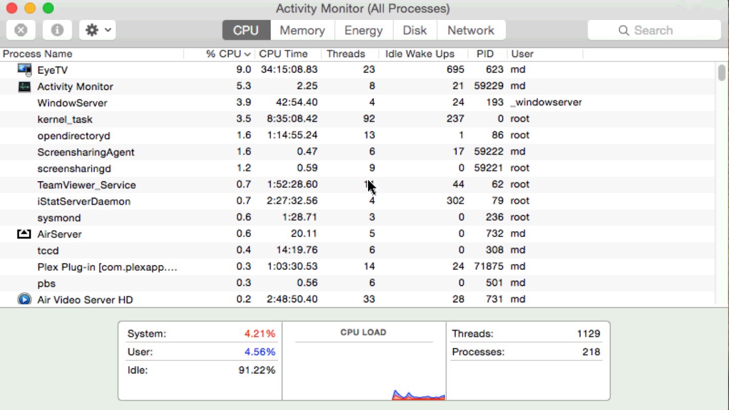

The only times I have found my MB battery badly impacted is when there is a buggy runaway process sucking up CPU. Examples of this are coreduetd and securityd.
Take a look in activity monitor at the CPU tab. Is the IDLE at the bottom of the window constantly at a very low value? Sort the %CPU column in descending order and see what the top processes are.
