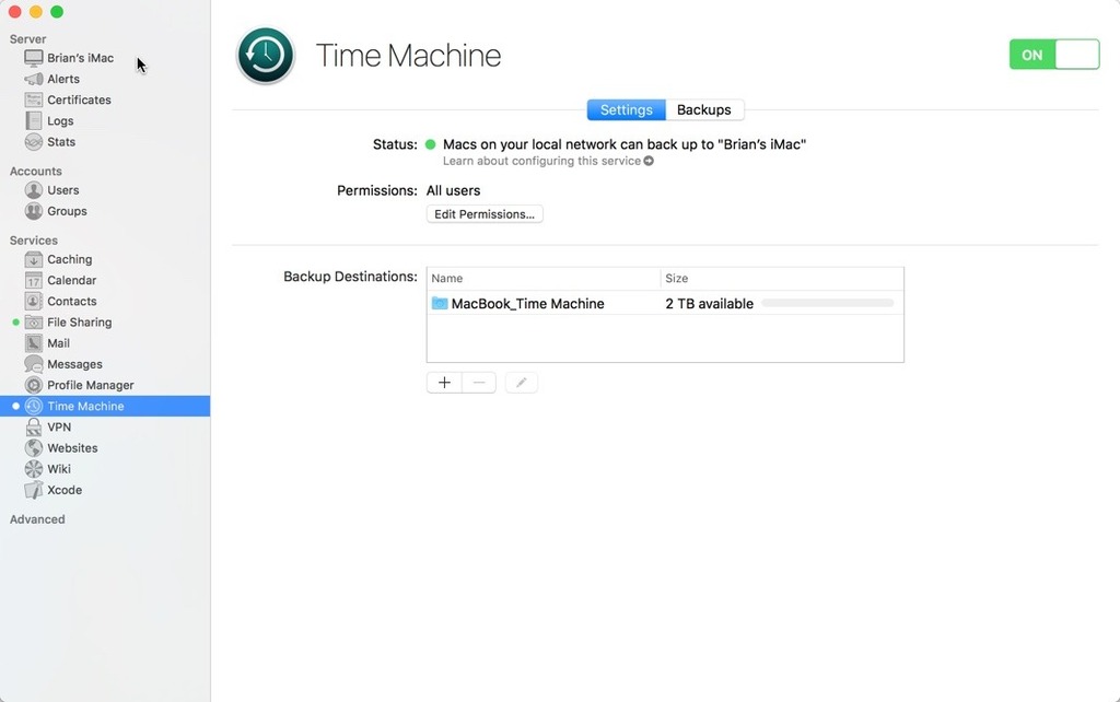

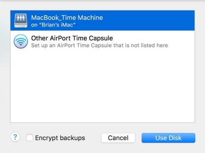

Ok, I just couldn't wait until the weekend..... 🙂
Purchase the Server for $20 and had it up and running in no time.
This is so sweet and works beautifully.....this is EXACTLY what I wanted to do.
Thanks again so much to "Weaselboy"
Some screen shots....
Server:
Client:
Client:
