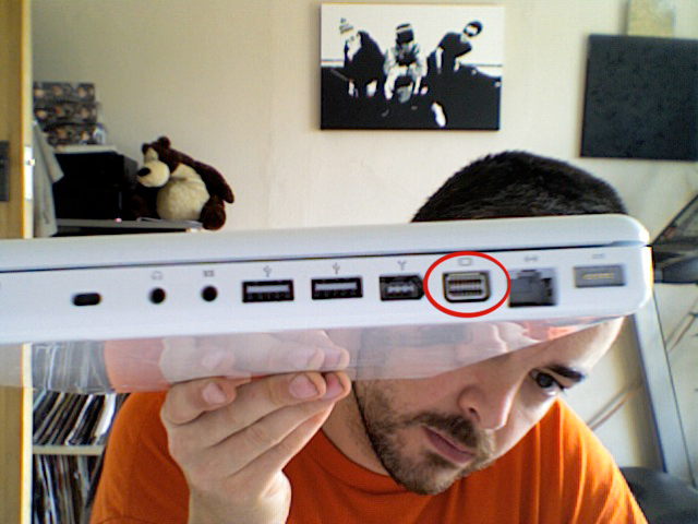

thanks but. . .
Thanks for the reply. . .
isn't the output on the Mac Book Mini DVI ?
Do i need to get a mini-DVI to DVI Converter, then do as you instructed ?
check the picture i just took to confirm if poss mate...
yours confused
Christopher

Well, Mini-DVI -> DVI, DVI -> HDMI, HDMI ----> HDMI should work, but its far from tidy!
I don't think Mini-DVI to HDMI exists, but if you can find it, that would be what you'd want.
The other option would be Mini-DVI to video adapter (Scart and Composite). But obviously with a reduction in quality.
Remember that sound will not be carried over the HDMI connection, you will need to deal with that separately.

I have the same question as the OP above. I have a white MacBook purchased in early-mid 2008. I have the mini display port (at least I think) seen here:
No, that's mini-DVI.
Demcee must have an '08>= macbook if they're using mDP (which Apple began using on the 2008 unibody macbook).
That makes this thread relevant to you, read the responses relevant to HDMI if that's what you want - you didn't mention what inputs your TV has.
