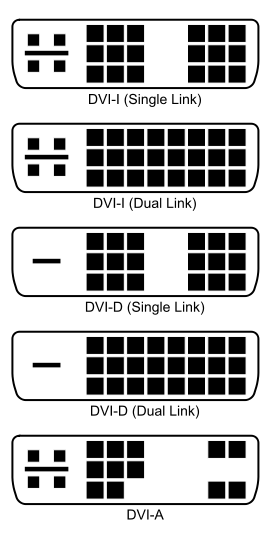

I have:
1) a mini display port > DVI adapter from apple and,
2) an older DVI > VGA adapter from apple
However the male end of #2 has four extra pins and won't fit in the female end of #1. In the picture below I have a male DVI-I and a female DVI-D. My question is this:
Can I just splice into the cable on each and connect the wires in such a way that will give me mini display port > VGA adapter? This way I can avoid spending more money that I already have on this fiasco.
Much appreciation in advance if u can help me 🙂

I was afraid of this, and I thank you for the quick response.
From what I can tell, the missing pins carry analog RGB plus sync...which is what VGA would be. I don't fully understand what that means. However, it looks like my only 2 options are to either
1) Buy a stand-alone mini-display > VGA adapter from apple or
2) Use what I have now and convert the DVI > HDMI, wich would be a higher quality video signal. My TV does have HDMI in, but for some reason it has VGA instead of DVI :S
Does this sound correct?
Your tv, actually , most TVs have VGA and hdmi (not dvi) for one simple reason; hdmi and dvi are pin for pin compatible with merely the appropriate cable, so you technically already have dvi on your TV. The VGA of course just adds compatibility. since displayport is compatible with VGA, dvi and hdmi, you can pretty much do whatever is cheapest. If you have hdmi, it makes no sense to buy more parts for lower quality video.
