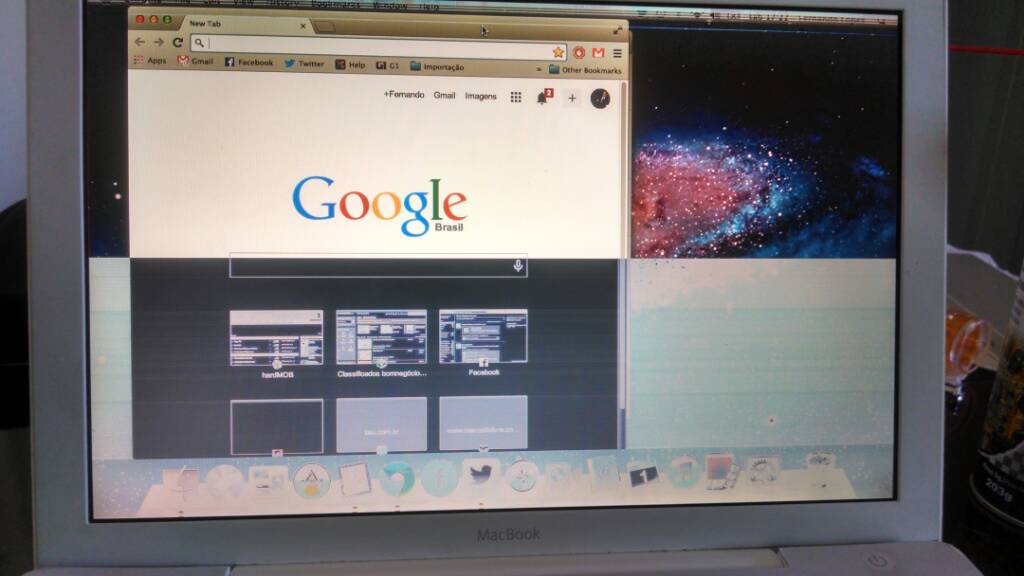

I bought a used macbook yesterday and it was fine, but today it appears overhated and in this moment the display got half Ok and half bad as you can see in the picture.
Try connecting it to an external monitor and using it for a while under quite a bit of load. This will stress the GPU (Graphics Card), and will tell you if you have a GPU issue or LCD (screen) issue.
The LCD assembly is composed of three main parts! The LCD itself which is the screen, the display data cable which carries the picture data from the GPU to display on the screen, and finally an inverter to power the screen.
Does this issue happen all the time, only when used for a while, randomly, or when moving the display. If it was the last two options, I would lean towards the data cable, but if it was the first I would say it is the LCD itself.

Thanks for the help dude, it happens all the time from the boot until the shutdown. I am on the Mac now and think that something is not good inside because fan is giving me a "bad smell". I wil turn it off now and send to a professional.

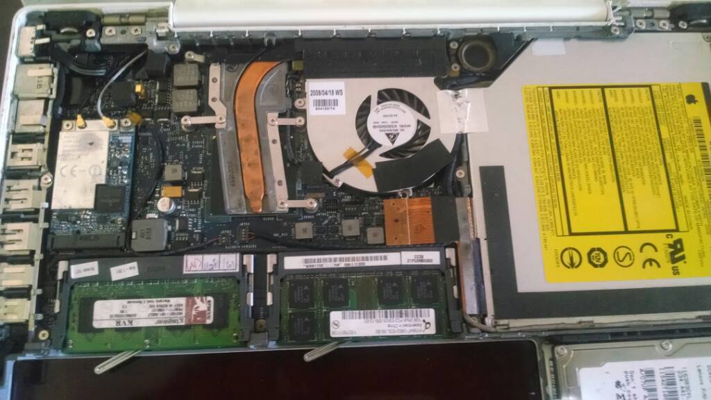

I opened and it is totally clean, the smell I told you is like a thing very hot. Look the picture attached, it's clean but unfortunately I couldn't solve this issue, I will take this to a professional tomorrow. Thank you all. uploadfromtaptalk1391373047540.jpg
The only smell I can think of is the CPU paste burning in. However, I doubt that would be the cause as the machine would have had the paste on for a while. Ask the professional to put new paste on the CPU.
Ok, thank you friend. One question please, if my problem is BGA (VGA) and not display it might appears on a print screen? I would like to try this test as I don't the the mini dvi cable to vga.
If you take a screen shot (print screen) it shows what the computer is putting out software wise. So it will not help with a hardware issue. I think the display cable is crimped in the hinge.
Ok thank you dude, after the professional result I will came here to tell you what happened. Cheers
The problem is on display, he will change it and I will take the Mac tomorrow, the cost was 500 BRL (Or USD 215), thank you all.
I opened and it is totally clean, the smell I told you is like a thing very hot. Look the picture attached, it's clean but unfortunately I couldn't solve this issue, I will take this to a professional tomorrow. Thank you all. View attachment 459354
The cloth like strip glued over the main fan. Have you lifted that up and taken a look underneath. If there's any compacted dust cooking away that's where it'll be. Worth a look although from what you're describing it's likely something more serious.
I only suggested what I did as it's always worth starting with the basics.
