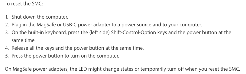

You have to use the keys on the left side.
Those three + the Power Button:

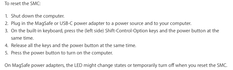

Here's a screenshot from the link posted above with the relevant information for you:
I tried but doest work but when I press shift,option,control and power button together the MagSafe LED changes its color to green from orange..then again comes back to orange.
Not good. 🙁 At least we can say that the power button isn't defective because the SMC reset worked if the LED color has changed.

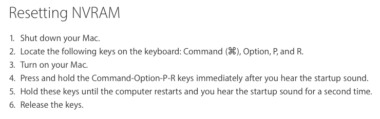

You could also try to reset the NVRAM with holding cmd+alt(option)+P+R. Before that get sure it is really shut down by holding the power button for maybe 10 seconds and after that push the power button just short again like you would turn it on normally and hold those four mentioned keys. Normally it will reboot after several seconds and you should hear the startup sound even if the speakers volume had been turned off before the last shutdown of OS X.
https://support.apple.com/en-us/HT204063

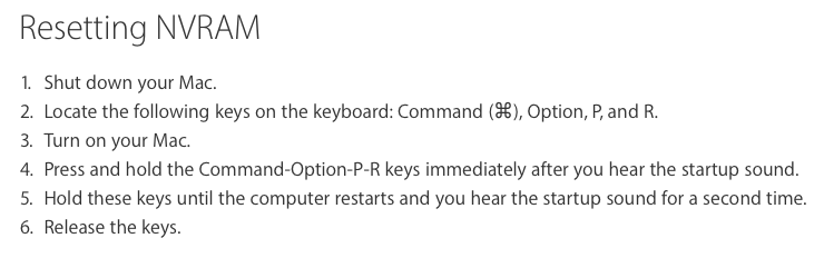

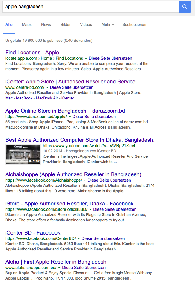

Or just use Google, it seems there are a few options in Bangladesh:

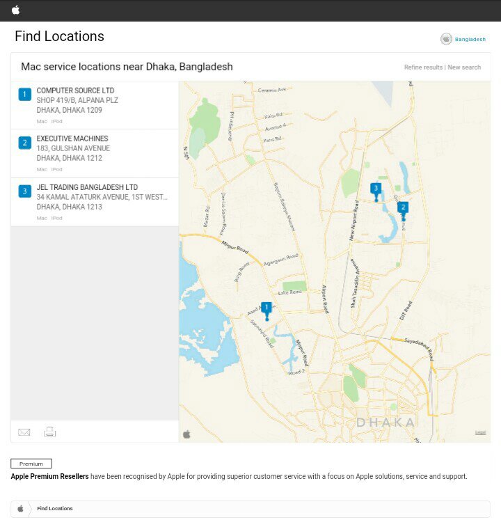

when I visited locate.apple.com/country I was asked for my City and what device I want to repair. after giving this info this three shops came out. that's means from these shops I can get warranty services. is it like that?
one more thing...there is a point regarding PREMIUM store at the bottom of the page.
one of the shops is premium. should I go to them?

All of those shops are certified and allowed by Apple to open your Mac to check what could be wrong with it and replace parts without voiding your warranty.
But I unfortunately can't say if they also can do Apple's warranty repairs for free. Probably not and they have their own warranty in addition when you have bought anything there.
But maybe they can have a quick look at/in it and for free and can send it to Apple for you if a repair would be too expensive.
I would call them and ask or look at their websites for information. Or simply just call Apple at first place and ask them what to do.
