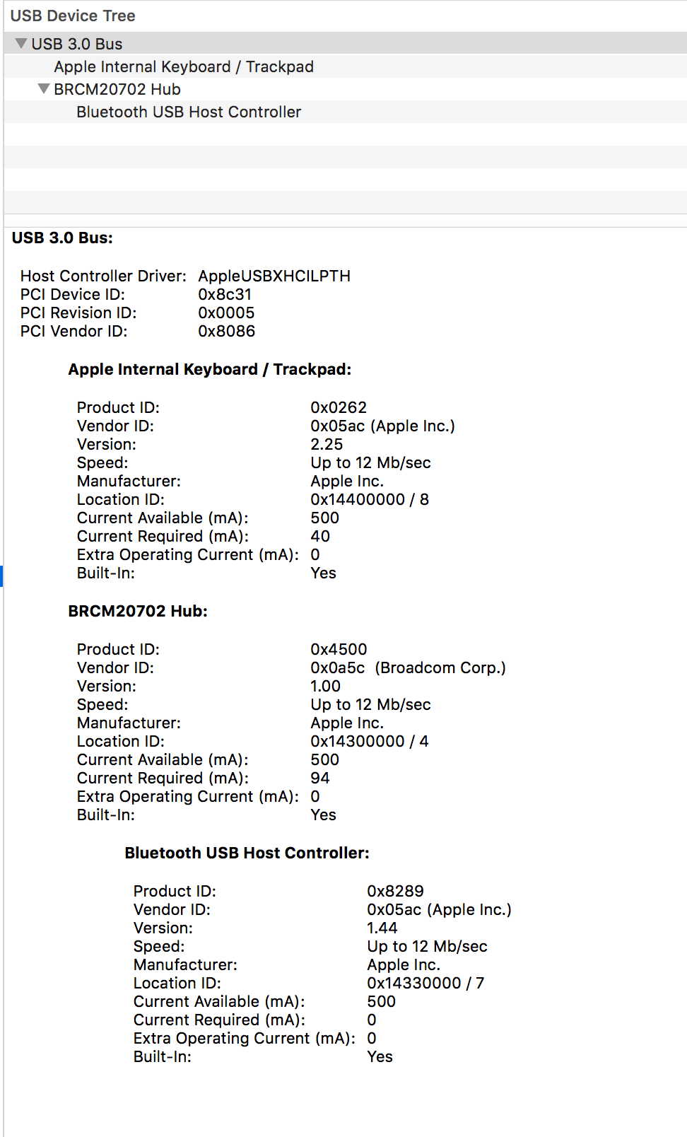

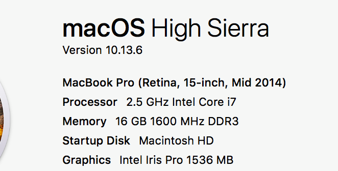

Alright, Guys. I think I need you on this one.
I just bought a MBP Second Hand from a dealer, who promised 90 Days Warranty.
After a month of using this, mainly for music production. {Spec, See Attachment (2014 with Nvidia Graphics Card)}
The right USB port acted funny, my controllers couldn't be connected.
I tried other controllers and USB cable. With my old MBP, it worked fine.
So I decide to connect my external drives to the same port, it's lit but not connected.
I try various size, drivers ranged from 8 Gb to 2 Tb, didn't appear on the desktop.
The next day both of my ports stop working so I decided to do SMC and nvram reset.
The left port came back to life. but the Right port still is in dysfunction. So I reinstall the Mojave Os without wiping the data.
Now, nothing changes.
So I called the dude who sold this and right up the next day another guy came to pick it up.
Return it on the same day in the evening, showing with his SSD external that appears on my desktop that it is solved and reconnect.
I then, went straight back to my room, only just to find out, the same problem persist.
Immediately, I called the Repair guy.
He suggest it's a software problem, that I should delete re-install and try other Os version
So, I did try out, delete the whole thing, reinstall it with both Mojave, High Sierra and the same problem persists.
The right USB port doesn't sent data, or to say very slow that a normal hard drives or controller wouldn't make it.
Now I called back to the dude. He insist that it is a SOFTWARE problem. He claimed that he checked the USB port, it still transmit 5v.
He said he would have to do some research then disappears for three days. Once I contacted him, basically, he is out of clue where the problems lies, in which he still keep going on with the SOFTWARE bug.
Then, the guy who sold this to me suddenly avoids my call.
What do you guys think ? Is it a software or hardware ? Or any suggestion to this USB problem ?
Right now, I'm drafting everything what I've got to get them to warrant my product or re-solved this issue.
But still will be very appreciated for any advice and suggestion if it will have to come down to me fixing it myself.
Ps. All of the information about the USB Port and Mac details is attached.

Tried a USB mouse on the port?
Tried a powered USB hub with your drives?
Tried running the internal disagnostics?
Hello Audit13
Yes, I've tried the belkin hub that's plugged in with the 5v adapter for extra power, no signal.
The Mouse on port did work. the cursor moves and can be clicked.
the internal disagnostics came out with no issues found with Reference code ADP000
Suddenly, out of nowhere, the port seem to work. This happens after one of many erase, reinstall, switching from Mojave to High Sierra. Now I try to use it as much as I can to see wether it will go out again. very odd.
This is very odd. It sounds to me like there is something wrong with the USB bus rather than the port.
I assume the port is flaky at times even with the Magsafe attached.
