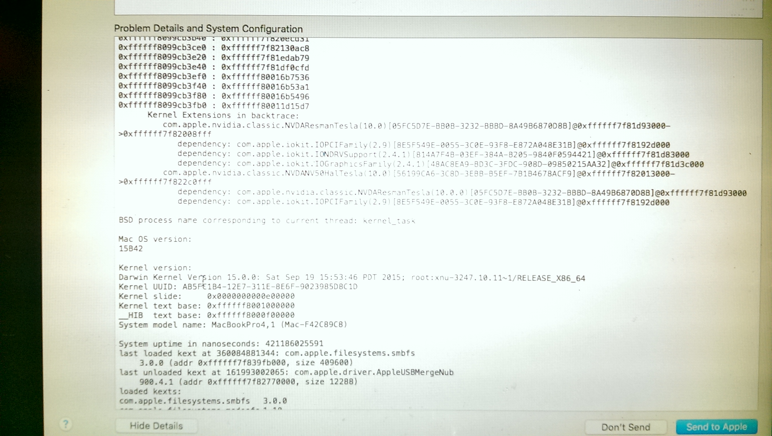

I have an A1260 MacbookPro. It's an old model and I think it is suffering from a graphics chip problem and was hoping someone can confirm from the crash report I managed to snap before it shut down again...I have attached the photo I took, sorry its overexposed but you can still read what it says.
The screen goes crazy colours and/or pixelated and becomes impossible to use, usually straight after boot.
Please let me know if you can decipher what this crash report means. Thank you so much 🙂
There's not much that you would need to decipher. The hardware problem that you have likely says it all
And, a few lines from your picture
com.apple.nvidia ....
com.apple.iokit.IONDRVSuppport...
com.apple.iokit.IOGrphicsFamily...
com.apple.nvidia.classic/NVDAResmanTesla
etc.
most (maybe all) of those are connected in some way with the graphics chip, which makes sense with what you see briefly on the screen.
The graphics chip is failing.
