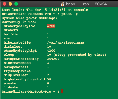

Safe Sleep / 3 keeps RAM powered up but adds "safety" by creating a sleepimage, just in case. It seems like a Moj/Catalina update this year has made Safe Sleep eat a lot more power per hour, perhaps intentionally or perhaps not. Hibernate / 25 turns off power to RAM, so waking will require repopulating RAM from the sleepimage no matter what. Setting standby mode to 25 saves power during sleep and resolves, for some, the fast-sleep-drain issue, but at the cost of slower wakes. 25 was designed for Apple's proprietary SSD PCIs, not SATA, which is why I don't use it.
Here's the eclecticlight "manual" on pmset. But, it misleadingly describes "Standby" in pmset as referring to "Hibernate". In fact "standby" refers to whatever is set for "hibernatemode," which can be either 3/Safe Sleep or 25/"hibernate". Hence, my sloppy previous post.
There's no 25/"hibernate" use at all by default in 2nd-gen MBPs, unless you use the pmset command line to enforce it.
So, when I hit 70 minutes of sleep, I switch to safe-sleep. RAM stays powered and battery still drains pretty fast (as of the mysterious mid-2020 change).

So for your issue the question is whether you're even getting to the standbydelay timer. If so, you shouldn't be having kernal panics, but also, the main instigator for the problem could be that your machine died (powered off due to drained battery) in the first place. In which case, the hanging progress bar during hibernation is a separate issue, as 25/hibernate is not even happening when you close your lid.
