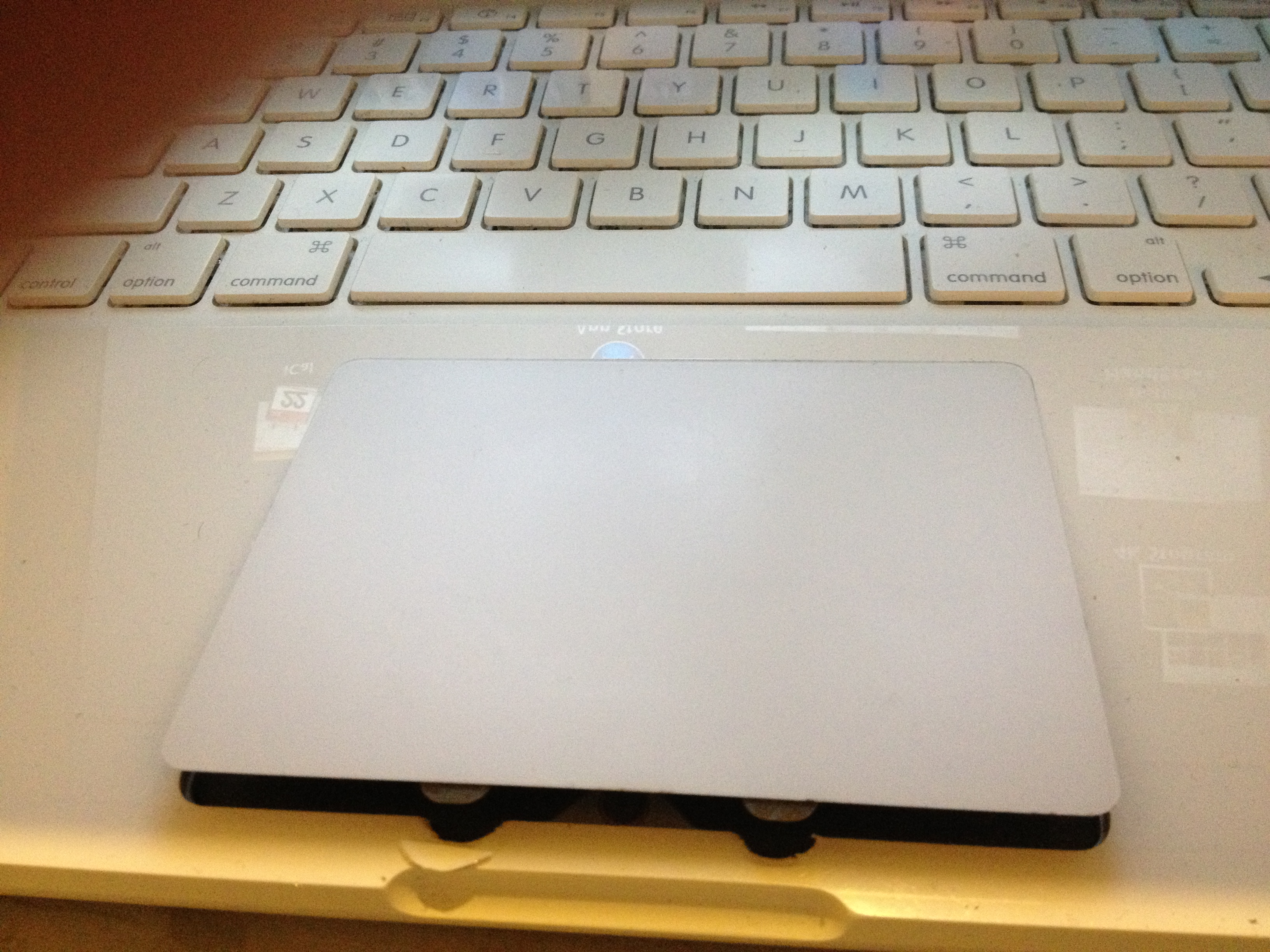

here's what I'm observing during the past week or two with my Macbook White Unibody 2010:
Two symmetrical places of plastic started to cracking without no reason. Furthermore, the trackpad has raised a little above the body in its left bottom corner (you can see this on the first picture).
White Unibody owners, have you observed something like this? What is the reason of this?
Check the battery to see if it has begun to swell up. The easiest way to check would be to pull out the battery and place it on a flat surface to see if it wobbles. A swelling battery could push up against the trackpad forcing it upward and crack the case.
As post #2 says, this is most likely due to a failed battery that has swelled up and caused the trackpad to push through the top of the computer.
You should at least inspect the battery and if it's swollen get it replaced. If you don't intend to continue using the computer, take the computer to an Apple Store where they can take the battery out for you and recycle it.

Those broken pieces are in the precise location of the trackpad "click-limit" tabs. So, those are upper limit stops, breaking though the relatively soft case. Something is pushing from underneath. The only item under the trackpad is the main battery. The other tell-tale sign is the left edge of the trackpad is pushing out - more pressure from underneath.
You will likely have difficulty just to remove your battery, and the trackpad is not going to click properly until the upper case is replaced - big job on a MacBook.

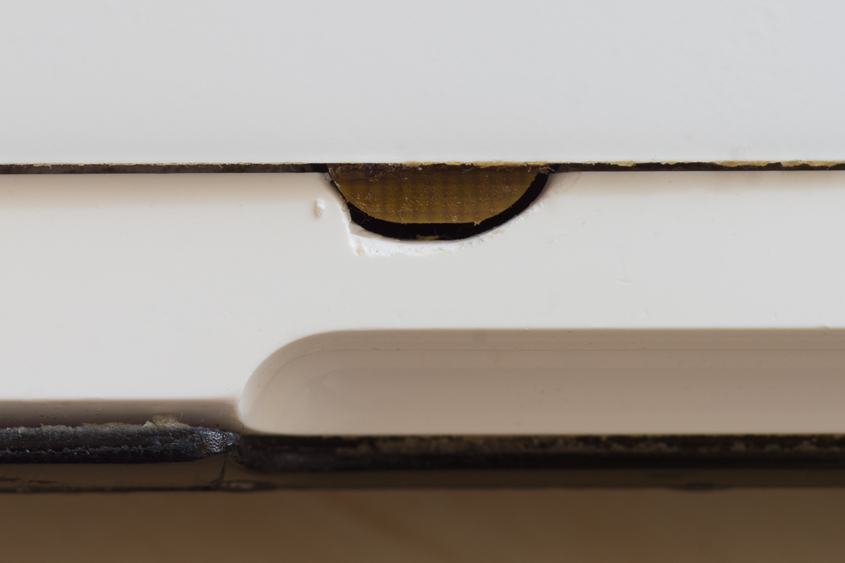

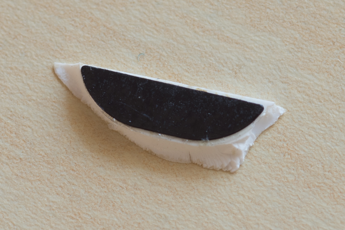

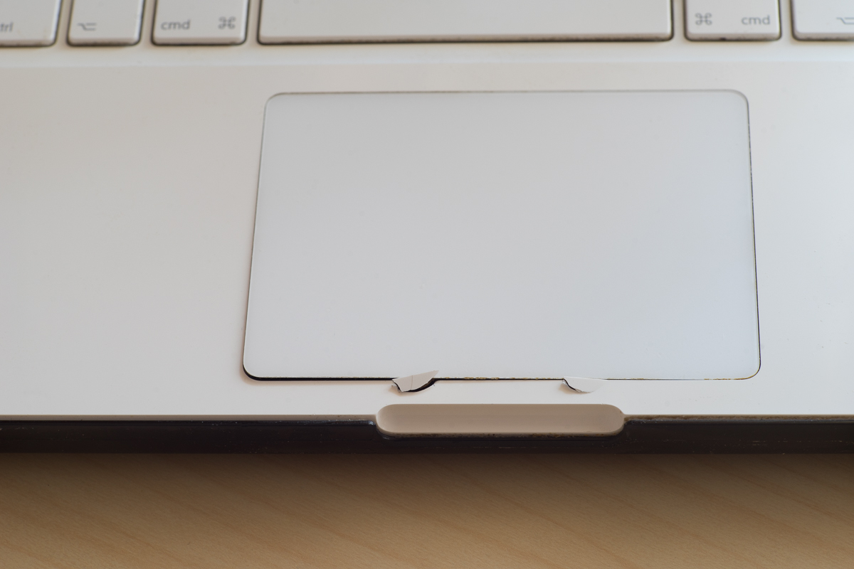

I know this is a very old post, but I still have a 2009 white unibody macbook that I still use, and this just happened to me recently.
I will be changing out the battery, but, does anybody know how I might be able to fix the holes that were made in the plastic case?
