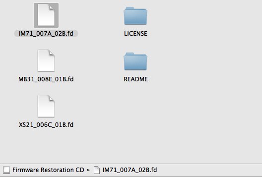

Got to turn a FirmwareRestorationCD.dmg into a CD.
Might be able to open the .dmg file in windows and burn it to a CD, but I don't know if it'll work for something so critical.
If it is just the FirmwareRestorationCD.dmg file on the drive, it needs the stuff "inside" that disc image file to complete the firmware upgrade.
You need to burn a Mac OS Extended CD with 3 files and a couple folders on a Windows machine. 😉

I hope when you created the firmware restoration CD you didn't just copy the .dmg file to it. If you did, that's the problem with the CD.
The dmg file is a disk image and must first be mounted as a drive. Then you create the CD using that drive as the source to burn to the CD.

Easy mistake, not everyone knows that .dmg files are disk images.
And you are looking to burn this...
