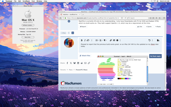

Pleased to report that the previous build works great on an iMac G4! Will try the updated on my iBook later today.

Great! glad you get to use it on your Imac at least. I assume it has FX Go 5200? Both that and the ATI Radeon 9700 work for sure. It's other GPUs that I am not sure my fork works on.

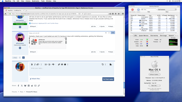

Able to load many websites but interaction can be hit or miss. Typing this message, for instance, crashed the browser. Restarting in safe mode allows me to type. Similarly, loading ChatGPT crashed the browser but it will load - albeit painfully slow - in safe mode. Can provide you the error message if you believe it would be helpful.
Regardless, phenomenal progress! You're really making waves and you should be very proud.
