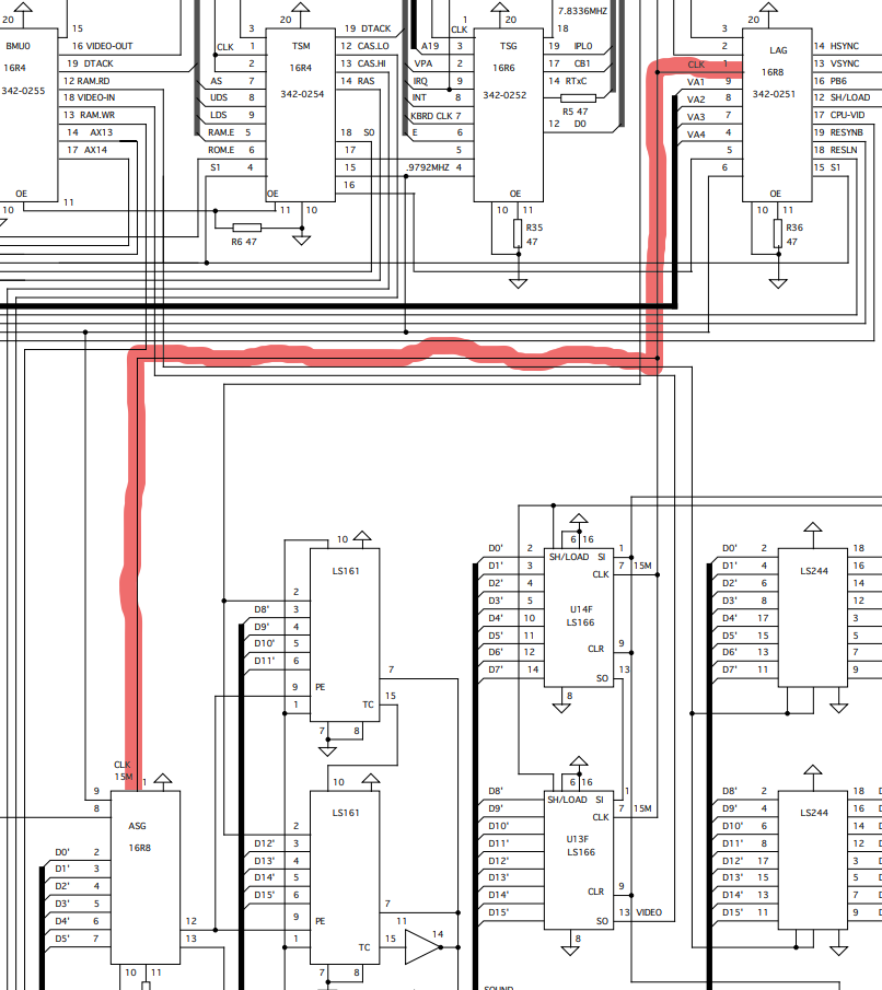

I can get my fat mac 512k to work with floppy emu but not a real drive. I probed the lines to identify why the floppy emu worked, but the actual hardware did not. I determined the ASG was not generating a PWM. There is continuity between the ASG and pin 10 of the DB19 connector. However, there is no PWM signal.
It will be difficult to source an ASG chip, so I wonder if anyone knows of a datasheet for the IC. Or if anyone has specifics about the commands from the 68k to the ASG. If I know the 6-bit binary commands, I can reproduce the PWM with a small microcontroller.
Ideally, I'd like to get an ASG 16R8 and replace the chip. But I can reproduce one if needed, given that I can get enough information about the commands.

I've also been fighting a screen issue. I figured the screen issue might need a recap. So I ordered the kit. While waiting, I just thought I would tackle the disk issue. However, the two issues may be connected. The ASG receives the clock from the horizontal retrace, which it uses for timing. I also noticed the Mac no longer has the startup BING. This is also used for the sound generator.

So the next step is to dive deeper into the LAG and ensure it operates correctly as it feeds the clock to the ASG and video.
Alright - rather than editing the second post as I started to dive deeper into the PAL ICs, I'll keep it open for historical purposes. I traced the clock, and it led to the 15mhz crystal. I probed the hsync and vsync to find that there was data on the oscilloscope. I noticed that all the diagrams I could find showed the hsync and vsync leading directly to the connector. However, my mac 512 has a 220ohm resistor for the hsync, which isn't documented in the schematics.
I then swapped my flyback from the SE/30 to the 512k and resolved the screen issue. So the LAG is functioning fine. My second post can be ignored about thinking it was a clock issue on the ASG.
However, now that I have a working mac with the floppy emu, it will not work with physical floppy drives. This is because the ASG is still missing the PWM. I'd love to see a datasheet that explains what the 6bit address lines are instructing the ASG to create for a floppy PWM signal. I could easily make a small microcontroller to replicate the PWM based on the 6bit address commands.
