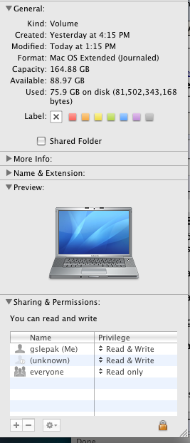

I'm confused, you copy a file from your desktop to the drive? Are you booted from this drive?
In other words are you doing this:
/Users/<your name>/Desktop/file => /
Or are you doing:
/Users/<your name>Desktop/file => /Volumes/SomeDrive
Either way, this sounds like a permissions/owner problem. Can you post screenshots of the location you're copying to? Here's what my boot drive looks like:

Okay. After messing around a bit I clicked on the "plus" button on the the bottom of the "get info" HD icon box.
It took me to a user list where I was able to "add" myself as a user. (Even though I already had admin privs)
What was strange, is that the "user" that I thought was already "me" was listed as my admin password.
Still confused.
But functional.
