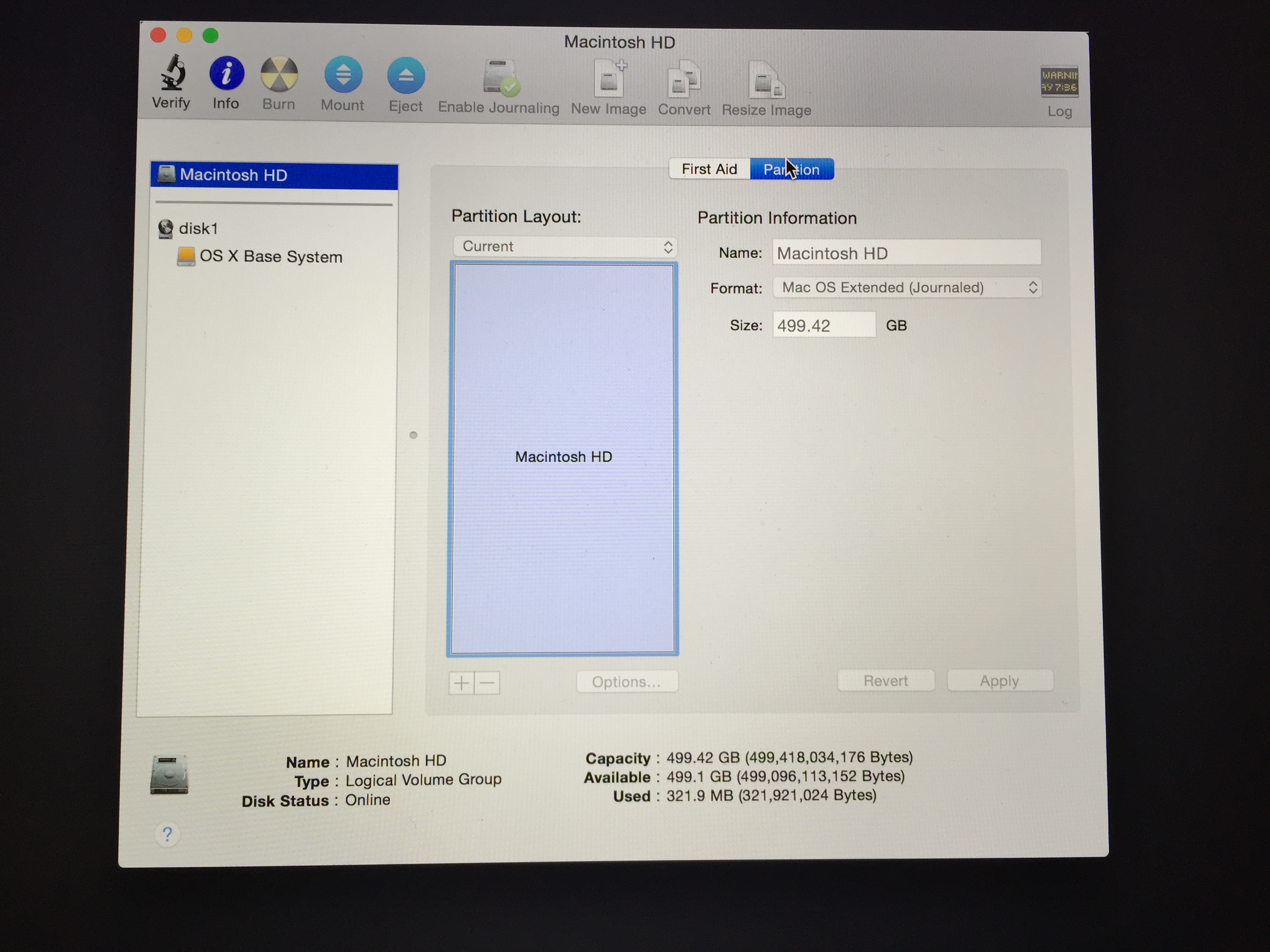

I was trying to format OS X because firevault encryption was paused thanks to Yosemite...Anyways, I think I have f'ed up and all I see in disk utility after booting using CMD+R is this:
attachment.php
There is no partition and there is no way to add one. I can not install a new version of OS X or do anything because there is no disk.

Its a Core Storage volume so Disk Utility can't manage your partitions. I had the same when FV2 hung on mine, full format and reinstall (then revert the Core Storage back to HFS), worked for me. You can see at the bottom of the screenshot they "Type" is Logical Volume Group - ie Core Storage.

I tried internet recovery using command+option+R and the same thing happens. I get to the OS X utilities page and I have the option to go to disk utility/Reinstall OS X/Get Help Online/Restore From Time Machine.
And the same thing happens in Disk Utility. There is no partitions under Macintosh HD. Basically there is no startup disk and no where to install OS X using any method.

I now booted from the USB and have a disk utility menu, but is identical to the DU menu if I boot into the internal drive. There is still no way to format the internal SSD...
In that case follow the commands in the thread I linked to to delete the Core Storage Volumes. You would still need to be booted from an external disk or USB so nothing wasted so far.
Go into Terminal and run:
diskutil cs delete disk1
That should remove Core Storage, then you can select the drive with DU and partition as normal.

You are awesome!!! It got fixed doing what you said!
