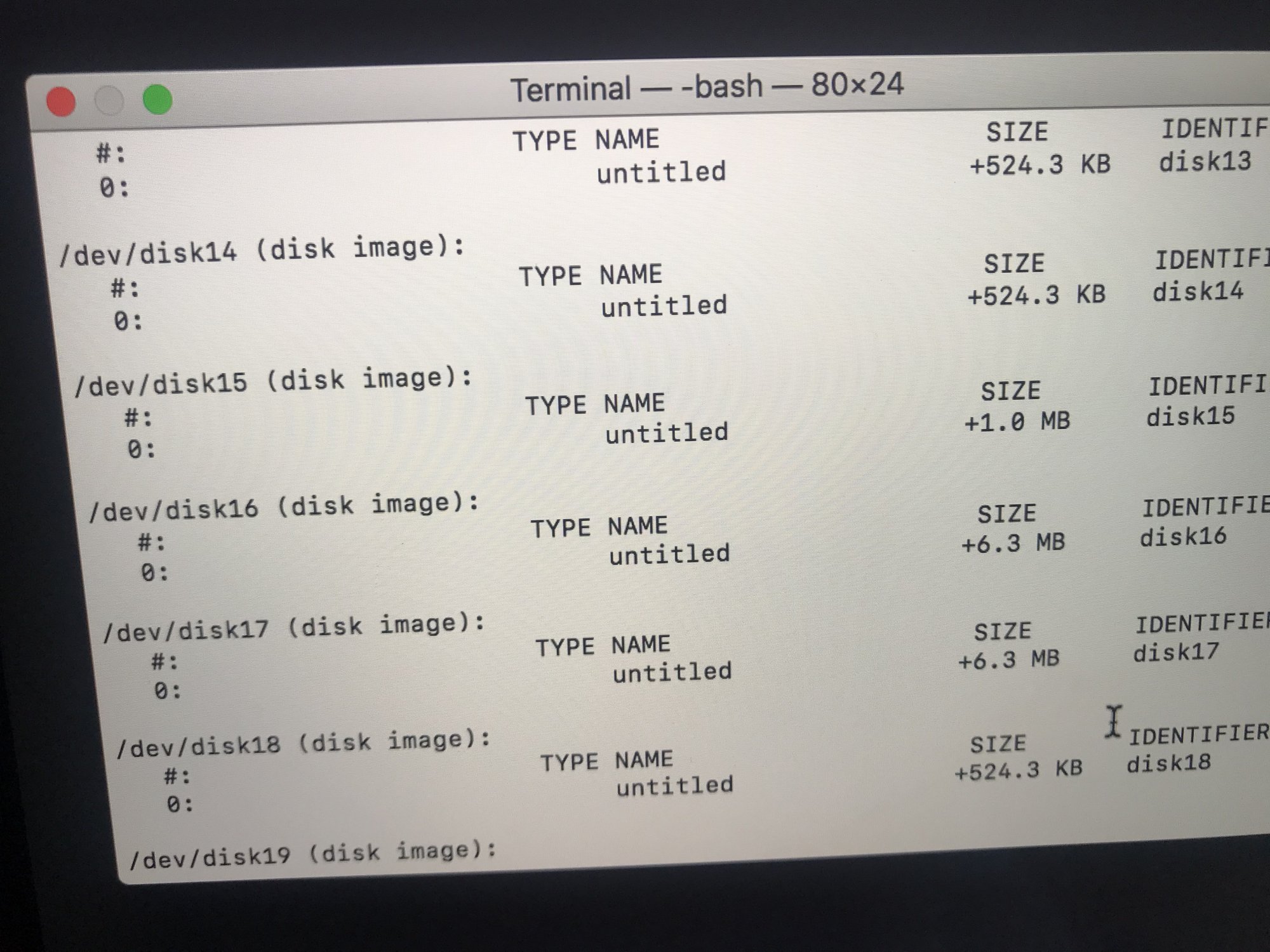

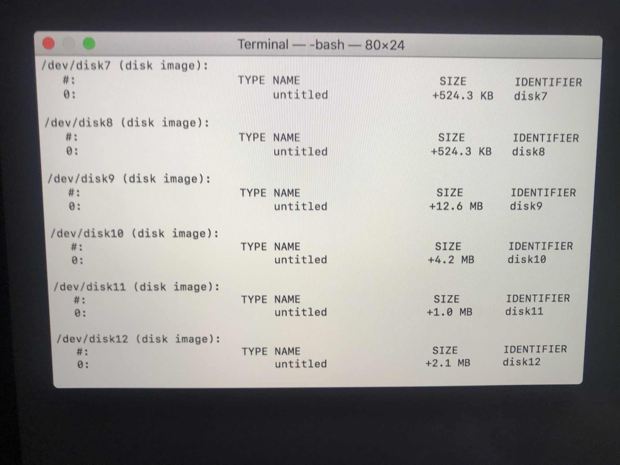

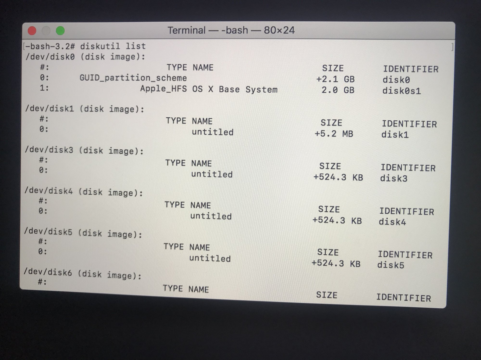

On the terminal, when I type in "diskutil list", this is what comes up.

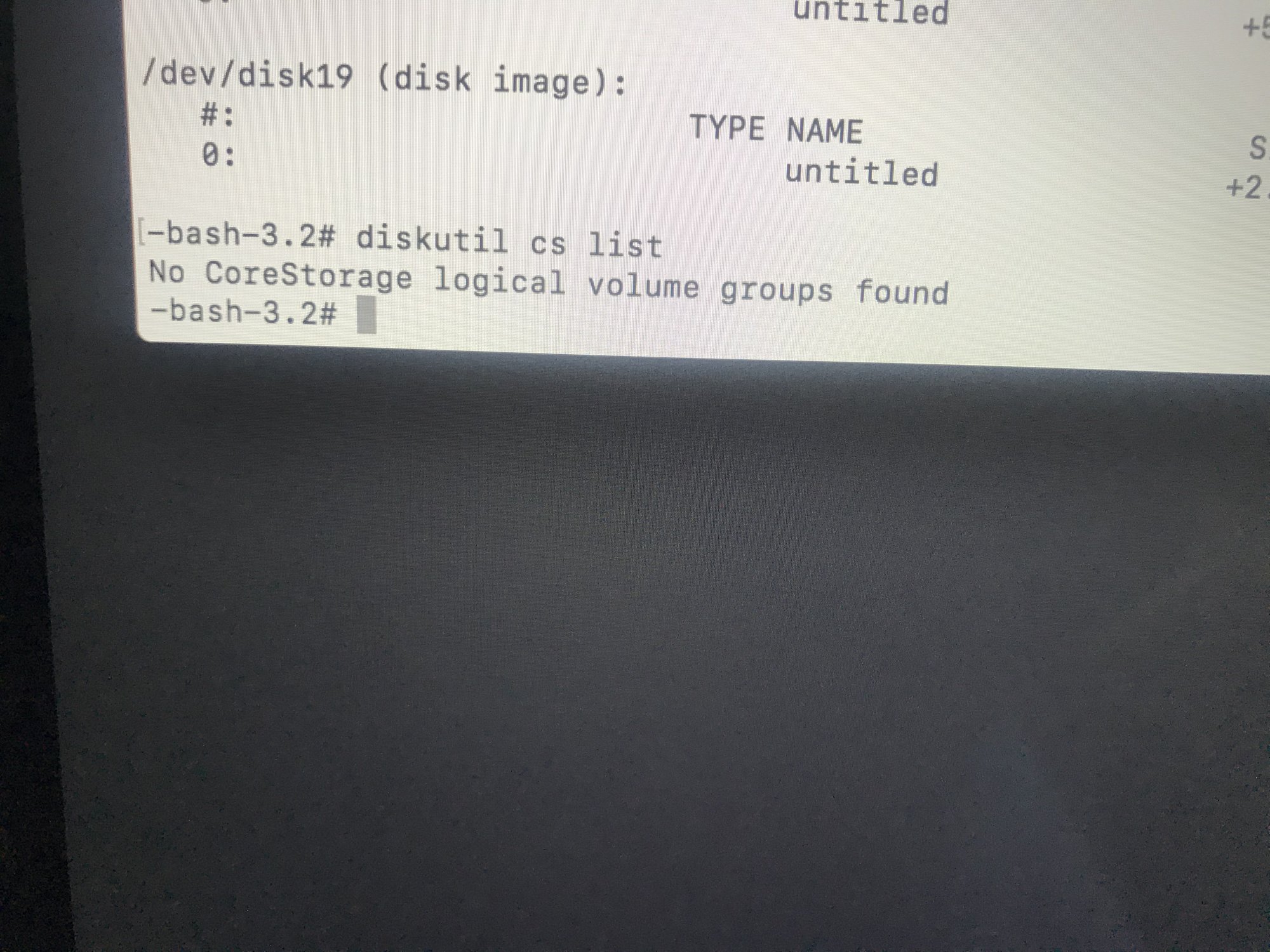

And when I type in "diskutil cs list", it shows this:

If the drive doesn't appear in the Disk Utility (be sure to try the View icon, setting that for "Show All Devices")
And, the drive is not listed in anything that you try in the terminal (diskutil [whatever command]), then you can assume that the storage drive has failed.
If, as you said, you have a 2016 MacBook (not a MacBook Pro), then that boot/storage drive is soldered to the logic board. You have to replace that logic board to fix, and the data on that drive is (probably) not recoverable.
I think the only 2016 MacBook Pro that has a replaceable drive is the 13-inch with function keys (not the touchbar model)
