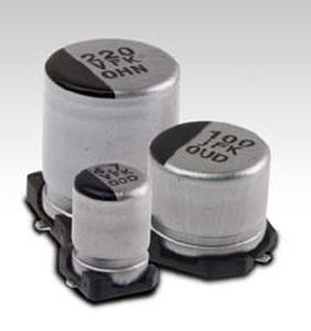

Another possibility is capacitors that have leaked on the motherboard. They are unfortunately very common. 🙁
If you see the capacitors pictured below with what appears to be a wet "stain" around them, they need to be removed, the board cleaned and new capacitors fitted. It's not a task for the beginner and requires pretty good soldering skills.
Sometimes these bad capacitors can prevent the sound circuit from working so hooking up a monitor AND fitting some RAM may be required to see if anything is working.
