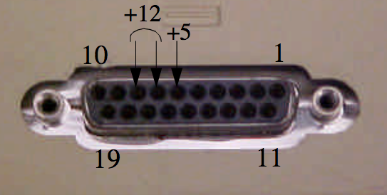

You can check the voltage without removing the case using the floppy drive port. Use the outer shell of the connector as ground (black probe) and check both the +5volt and +12volt with the positive (red probe).
