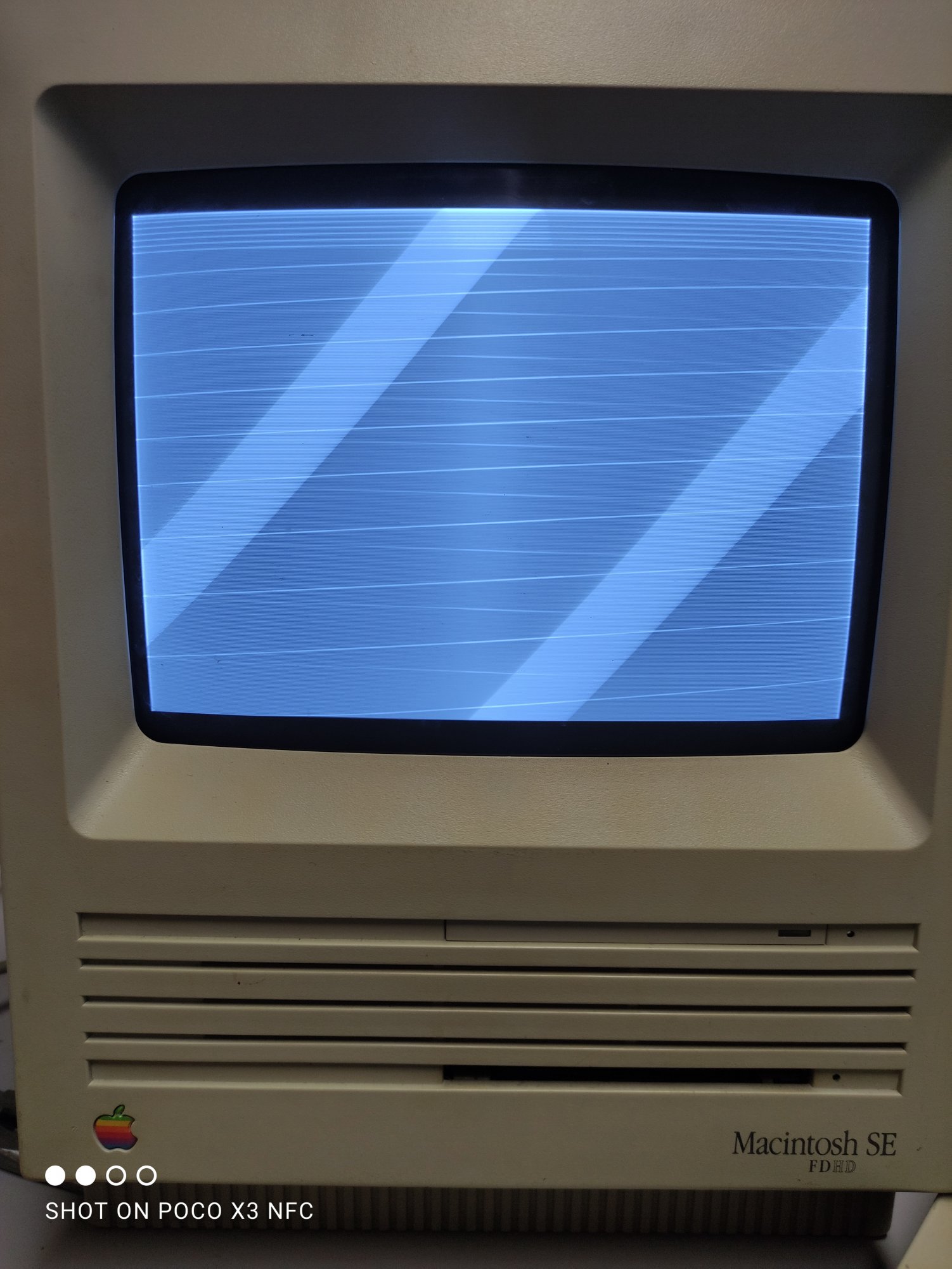

I replaced the CRT (purchased used on eBay) of a Macintosh SE. It turns on but looks like in the photo. Can anyone help me solve? Thank you.

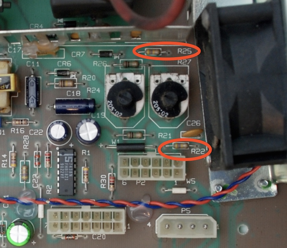

Check R25 (470k ohm) Check R22 whilst you're there too (also 470k ohm)

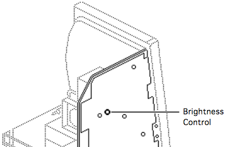

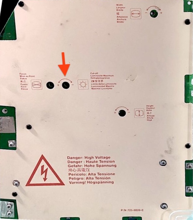

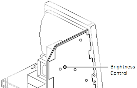

So the lines OR background you see on the screen DON'T change in brightness when you adjust the Cut-Off (Labelled below as 'Brightness Control')?

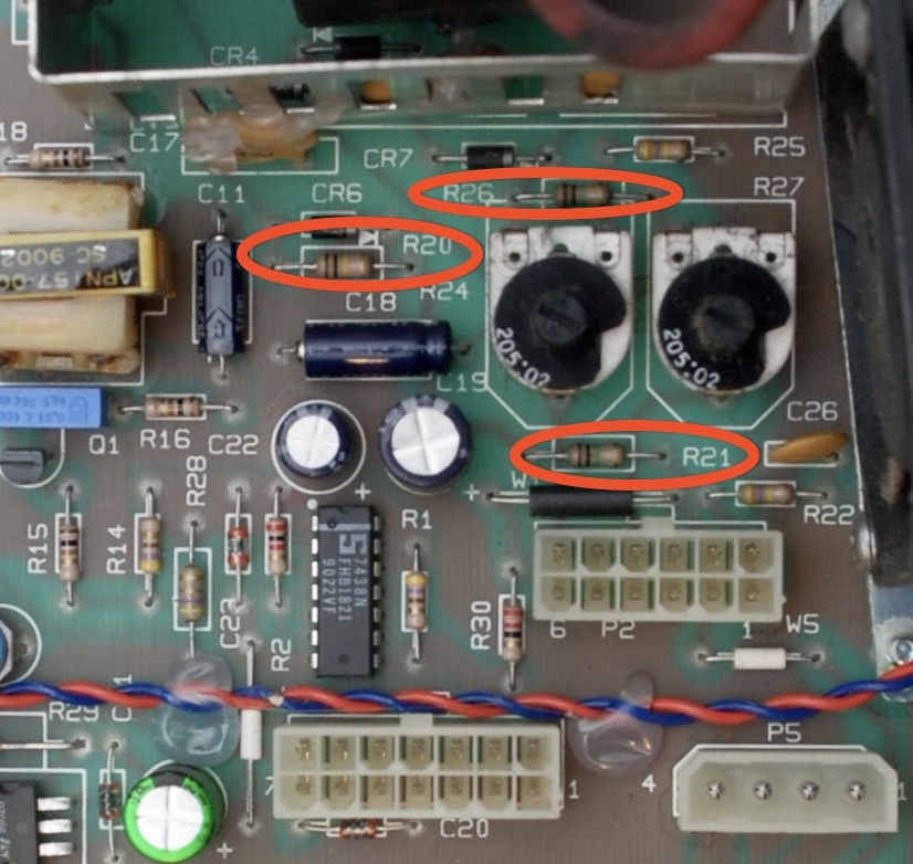

Check all resistors on the CRT Neck Board.
Also check:
R20 100K ohm
R21 1M ohm
R26 1M ohm
