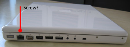

    maybe someone here can help me:
    i think my little macbook's ethernet port is screwed. I have done the following tests:
    plug in the same cable to my macbook pro. (working)
    plug in a different cable to the macbook. (not working)
    check the port see if anything is broken. (pins are fine)
    wireless on the macbook (working)
    Restart the computer, repeat the tests (still not working)
    what is happening here? all of the sudden... well after i unplug the cable, plug it back in. Any suggestions here? Appreciate your time.

    The Ethernet port is soldered to the logic board. If you had the tools and the talent you could de-solder it and solder a new one on, but standard procedure is to just replace the logic board because it is quicker and easier.
    I expect that the failed board is then sent to a specialist facility to have the RJ-45 jack replaced and the board is then sent back to Apple for future replacements.

    I have a similar problem. I think it has to do with the pins inside the port being broken or bent. when i put in my cable and force the cord's pins to touch the pins inside the cable, then it connects, but when i let it sit idle, sometimes it disconnects. what i do is try to wedge something underneath the cable while it's in your macbook.

    My ethernet port started failing quite recently, the cable would randomly connect and disconnect while working. A close inspection of the port showed that one of the pins had been bent flat. A small scratch inside the port suggested it had taken a knock while the cable was plugged in.
    I used tweezers to very gently lift the pin and bend it back into shape. It now works perfectly again. I'd suggest checking this first before taking the mac to the shop. :apple:
