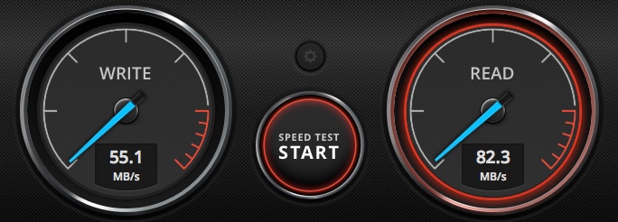

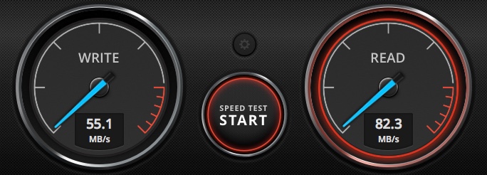

Thanks for the feedback. So, I have downloaded BlackMagic Disk Speed Test and plugged in a USB 3.0 WD My Passport Ultra. I am not getting anything like a USB 3.0 speed:

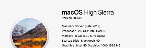

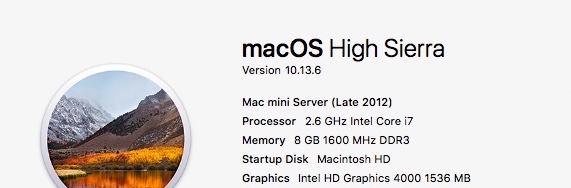

Here is my system:

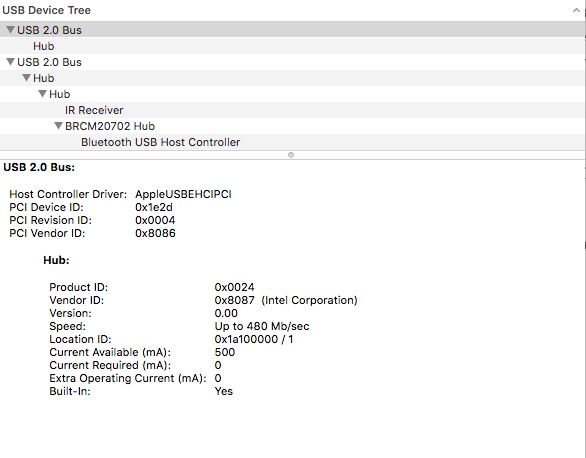

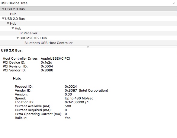

USB details from the system profiler:

So I am not sure what is going on as the specs say USB 3.0, but mine seems to be USB 2.0.

I’ve got a 2012 Server and System Information shows the same 2 USB 2.0 entries as yours, but I scrolled further down and there is a USB 3.0 entry as well.
Devices on USB 2.0 speed will show up under a 2.0 device tree in the system profiler, at least it does for me, while 3.0 devices show up under a separate 3.0 device tree. Do you have anything more showing?

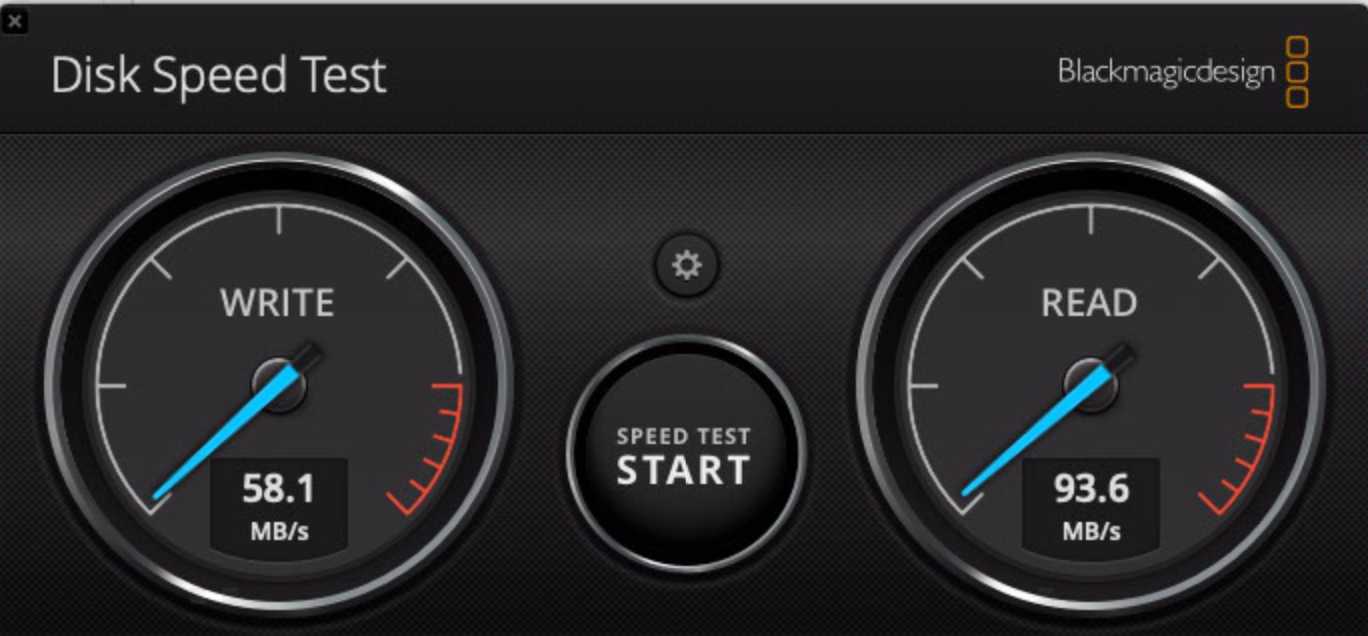

For an external hard disk, those speeds look about normal. The speeds @Boyd01 was showing were from an SSD. Here's what I see on a 2012 Mini from my Time Machine backup disk.
If you had USB 2.0, you'd be getting tops around 35Mb/s

It still seems a bit strange that I couldn’t easily see a USB 3.0 tree. For any of you that have this as a separate tree, can you look at the image from system profiler that I have put above and compare it to yours? In case it should be in the same place.
Sure you are. I also have a couple Passport Ultra's, and they're slow bus-powered hard drives. On USB 2.0, you would only be getting around 30-35 MB/sec. On a full sized USB 3.0 3tb hard drive with its own power brick, I get around 150 to 170MB/sec. You will need an external SSD to take full advantage of the USB port speed.

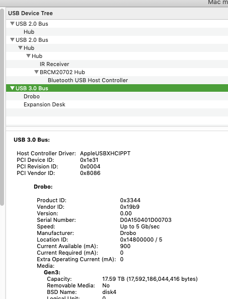

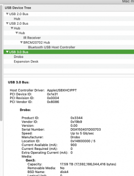

I've just checked the system profile on my machine. If you click and hold / drag down on the little dot below the 'bluetooth USB host controller' it will show 'USB 3 bus'. Have you tried this?
I think you just need to scroll down 🙂
There are two USB 2.0 busses on the USB Device Tree, then the USB 3.0 bus is below those. At least one of the 2.0 busses is internal; it has the IR receiver and Bluetooth controller on it.
