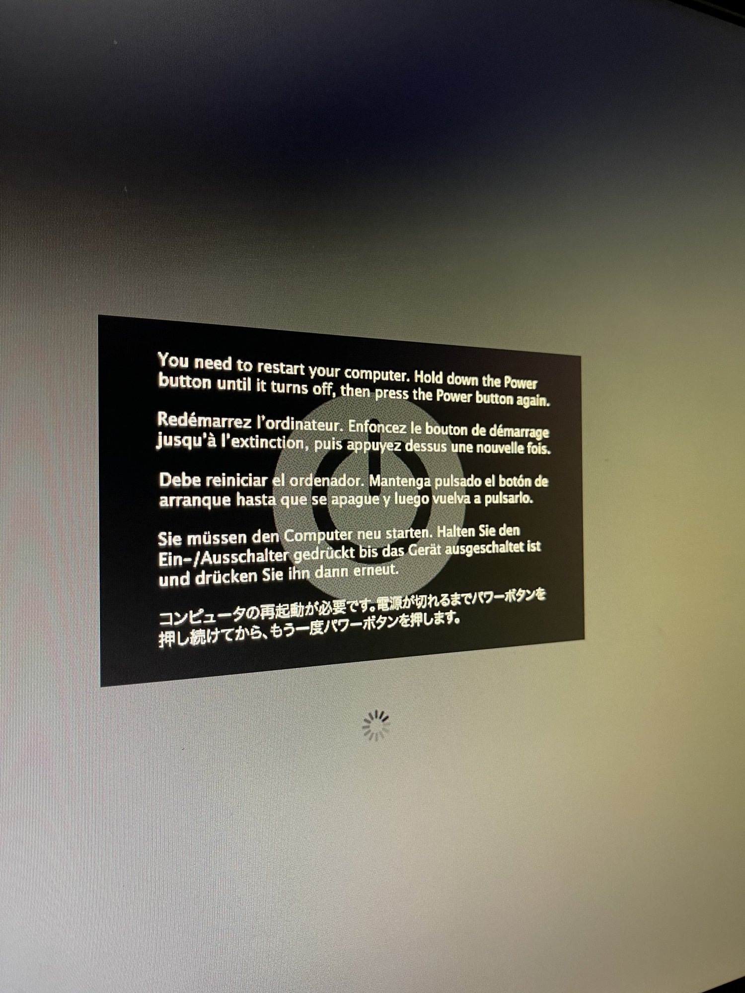

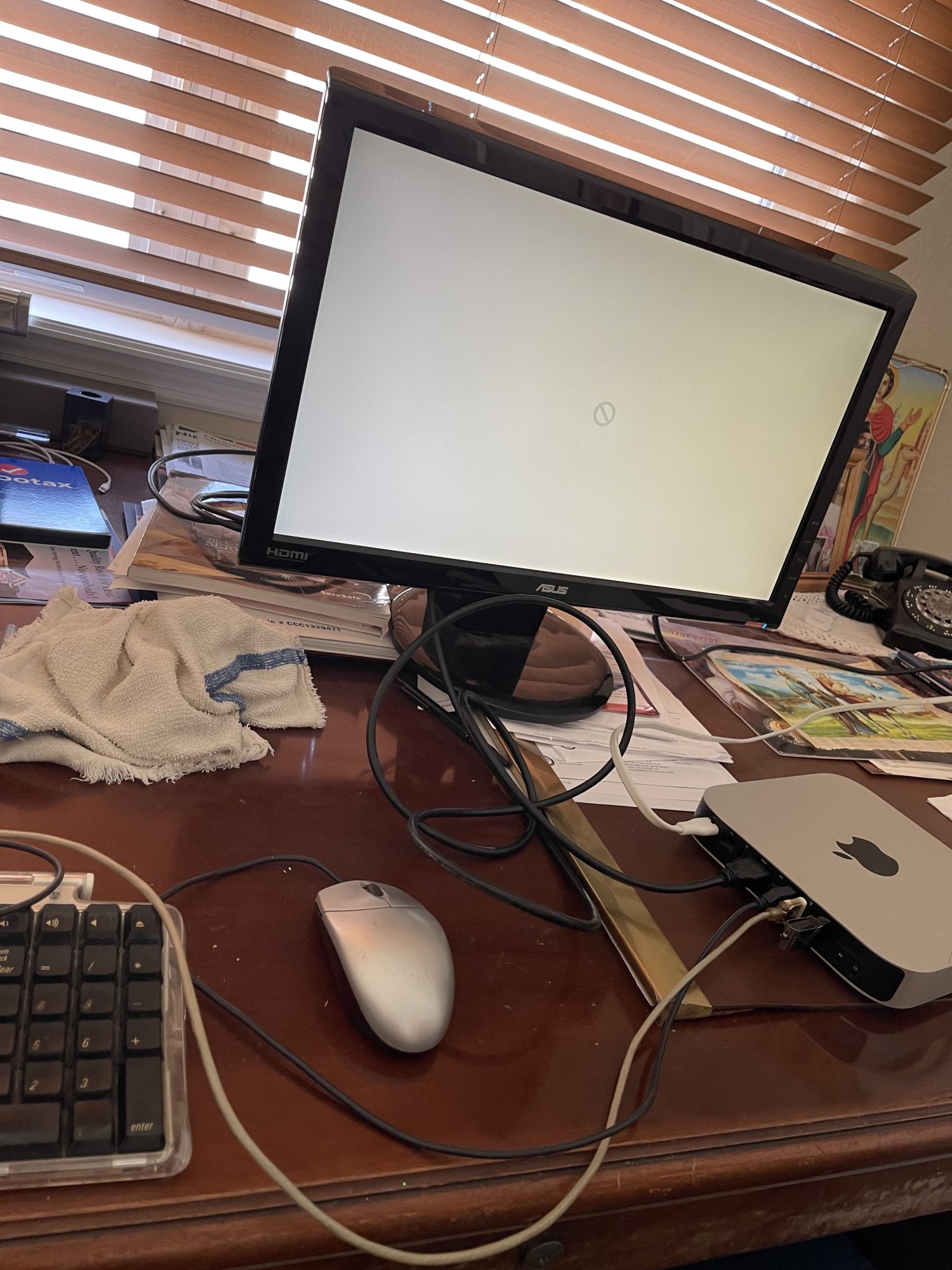

Guys, how’s it going. Any way to reformat this system? I got this message with a usb stick created in windows with transmac; I tried lion and El Capitan too. Also cleared nvram with nothing. Help please !

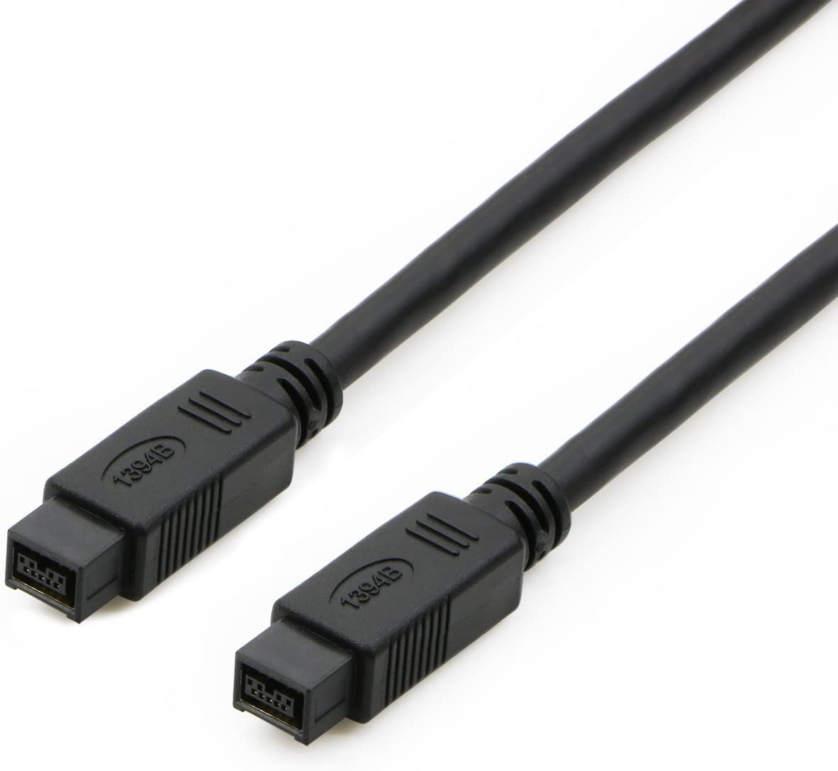

  1. The FireWire Target Disk Mode method I described earlier in this thread (requires a FireWire cable, which fortunately are still available to buy online — either FW800-to-FW800 (pictured), or FW800-to-FW400, if your other Mac lacks FW800);

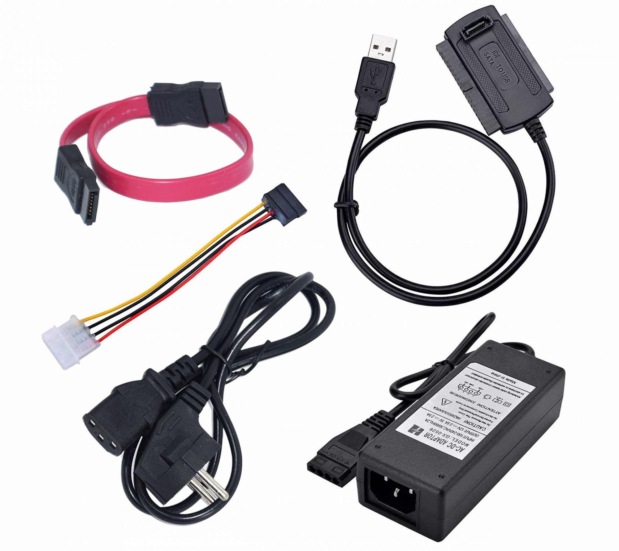

  2. Taking out the Mac mini’s hard drive and connecting it to a SATA-to-USB adapter, then connecting the hard drive to the adapter and connecting the USB cable to your working Mac (also available to buy online, but has more components than a FireWire cable), to install either using the above method or the dosdude1 method;

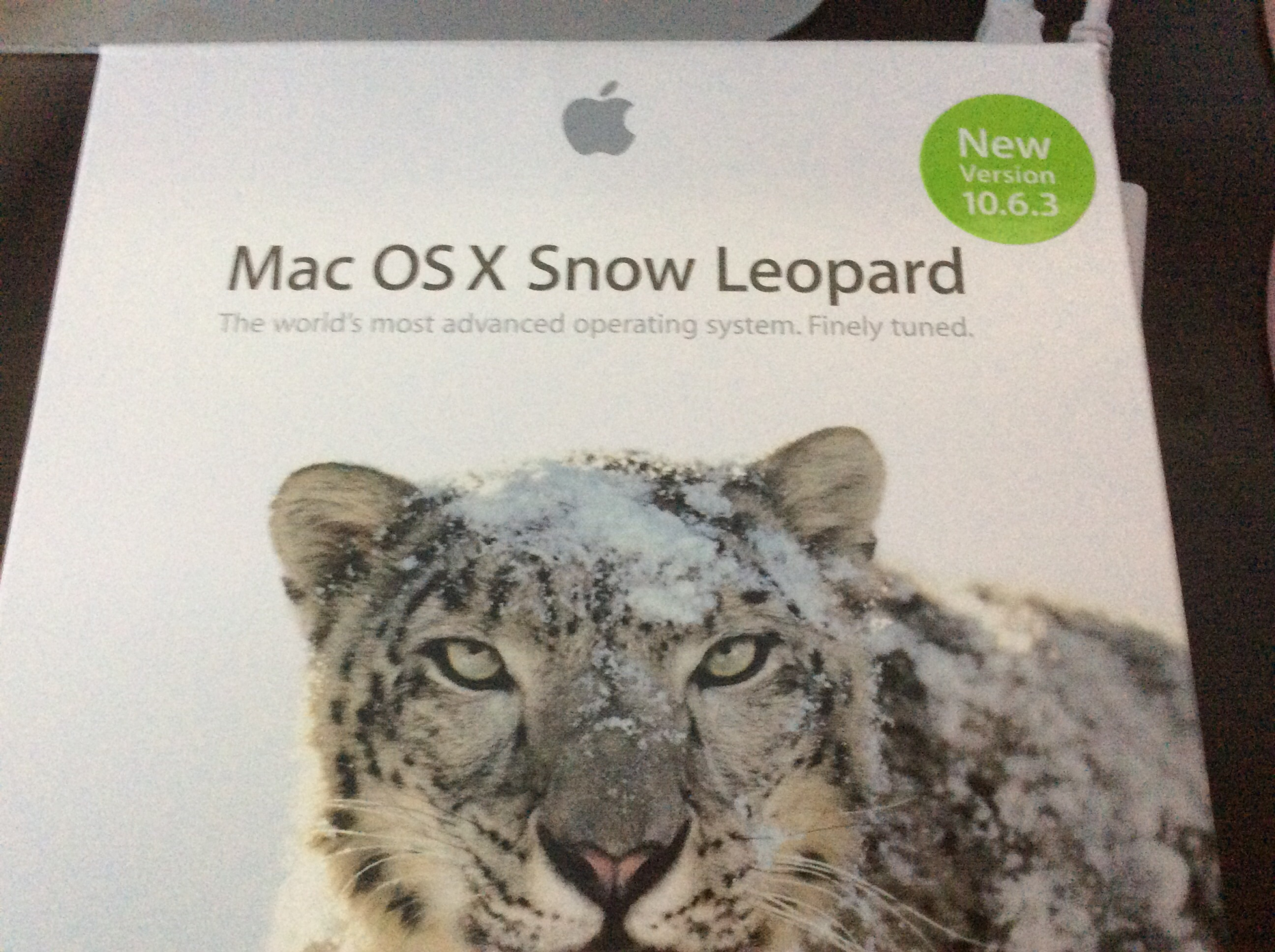

  3. Procuring a used Snow Leopard retail DVD online and inserting it in your Mac mini.

(1)
(2)
(3)
Kind of interesting tho. I ran the createinstallmedia command in terminal and it seems to successfully created a bootable install disk. However,
The good mac is a pro dual Xeon. Slow as molasses tho, only 2gb ram. it reads the disk as “install macOS high Sierra”
the mini sees this as “macOS base system” and still fails
I get my only options. But why, what happened to cause this ?
