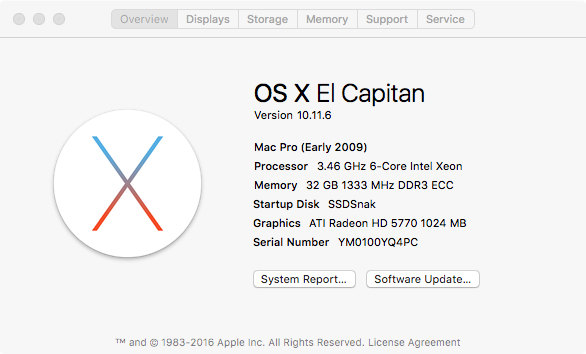

Possibly a stupid question, but can I expect any issues going to Sierra from my upgraded Early 2009 Mac Pro (6 core & 5,1)?
