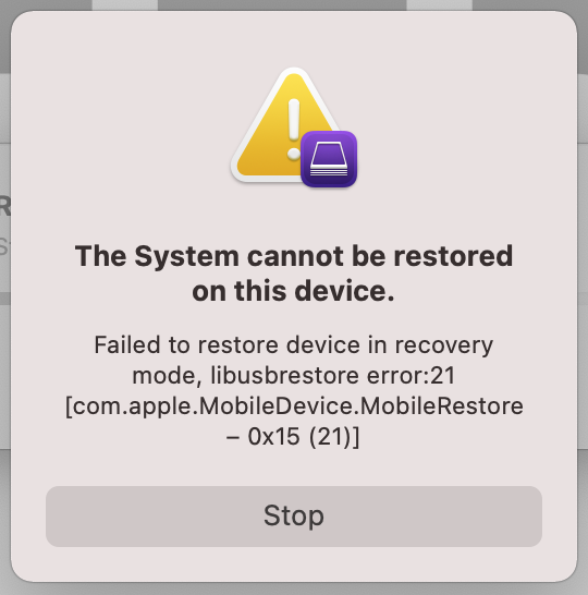

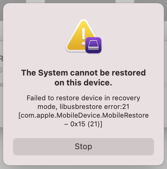

Updating to macOS 11.3 has bricked my M1 MacBook Air, it continually reboots and only gets as far as showing the Apple logo. Apple Configurator is unable to revive or restore, failing with "Failed to restore device in recovery mode, libusbrestore error:21 [com.apple.MobileDevice.MobileRestore – 0x15 (21)]". Has anyone else had this issue?

Yup same error every time, probably > 5-6 tries now.
Also should note that I can't get to the boot options screen either, it shows "Loading startup options..." and then reboots.

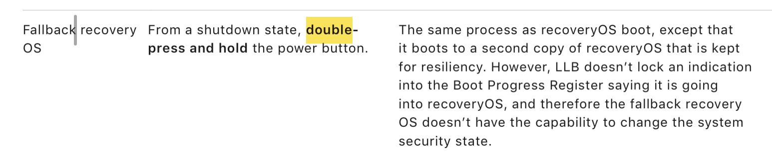

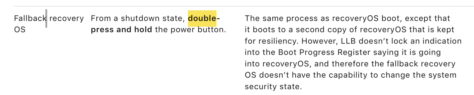

It is documented. On page 29 of this Apple security guide PDF.
Reactions: Mike Boreham
Very interesting! Thanks. This is the relevant bit:
This doesn't seem to be at all well known. I don't understand why not. The way it is described does not sound like the same "1TR" that Howard Oakley mentioned.

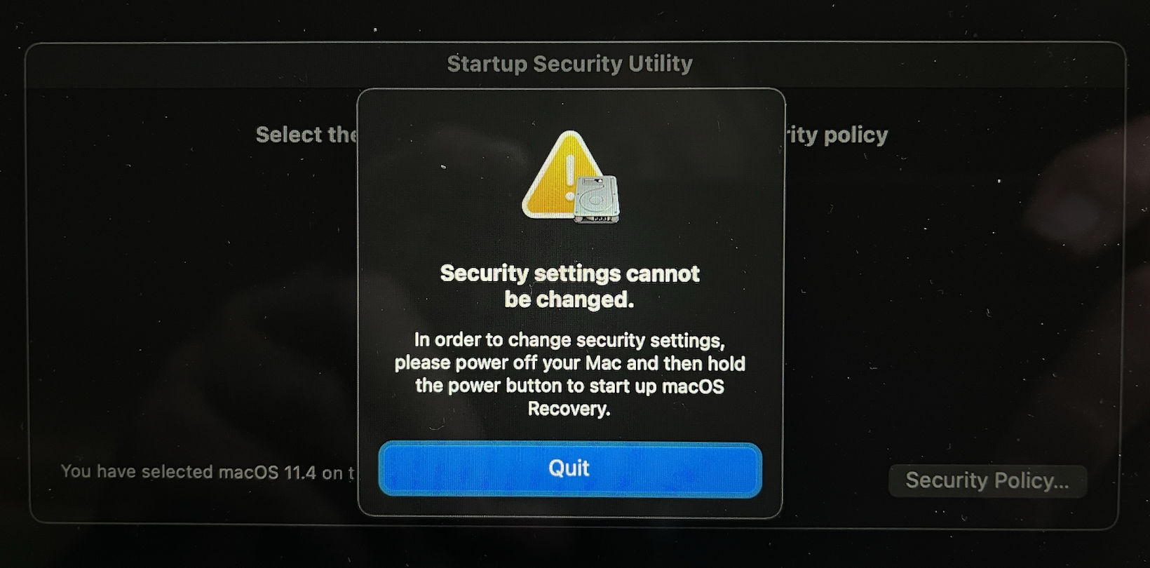

I just tried this and it worked! I know I was in Fallback Recovery, not regular Recovery, because when I tried to change Security Settings I got this:
