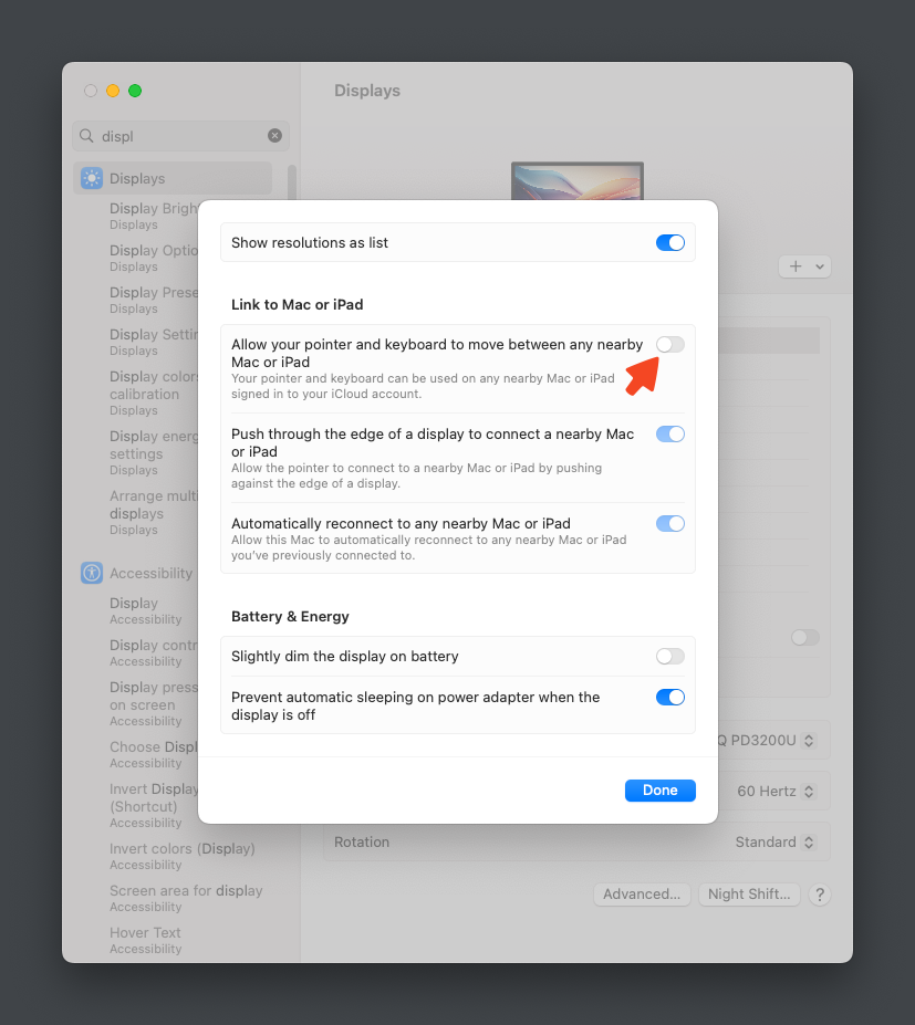

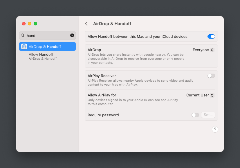

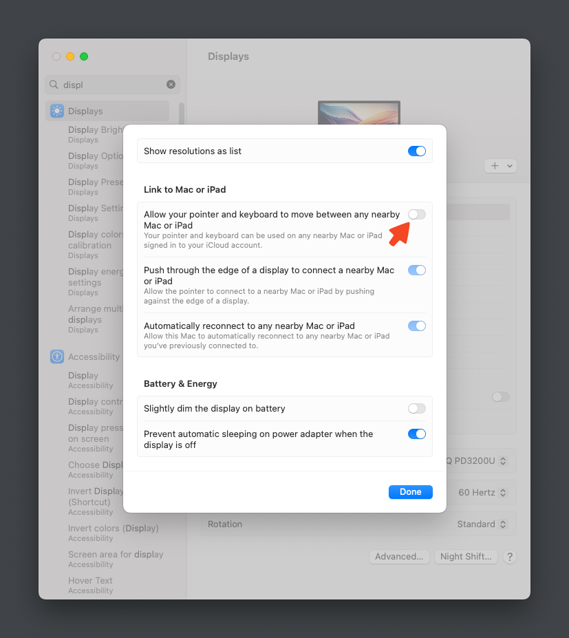

I am using Universal Control between a Macbook Air M2 and an Intel iMacPro.
The following just helped me:
1. Disabling Handoff
2. Disabling the Allow your pointer and keyboard to move between any nearby Mac or iPad
3. Rebooting both computers
4. Turn the above features back on.
I also wanted to clarify that it is not necessary for both computers to be connected to the same WiFi network for Universal Control. In my configuration, only the MacBook Air is connected to WiFi and the iMacPro just has WiFi enabled but no network connected.
