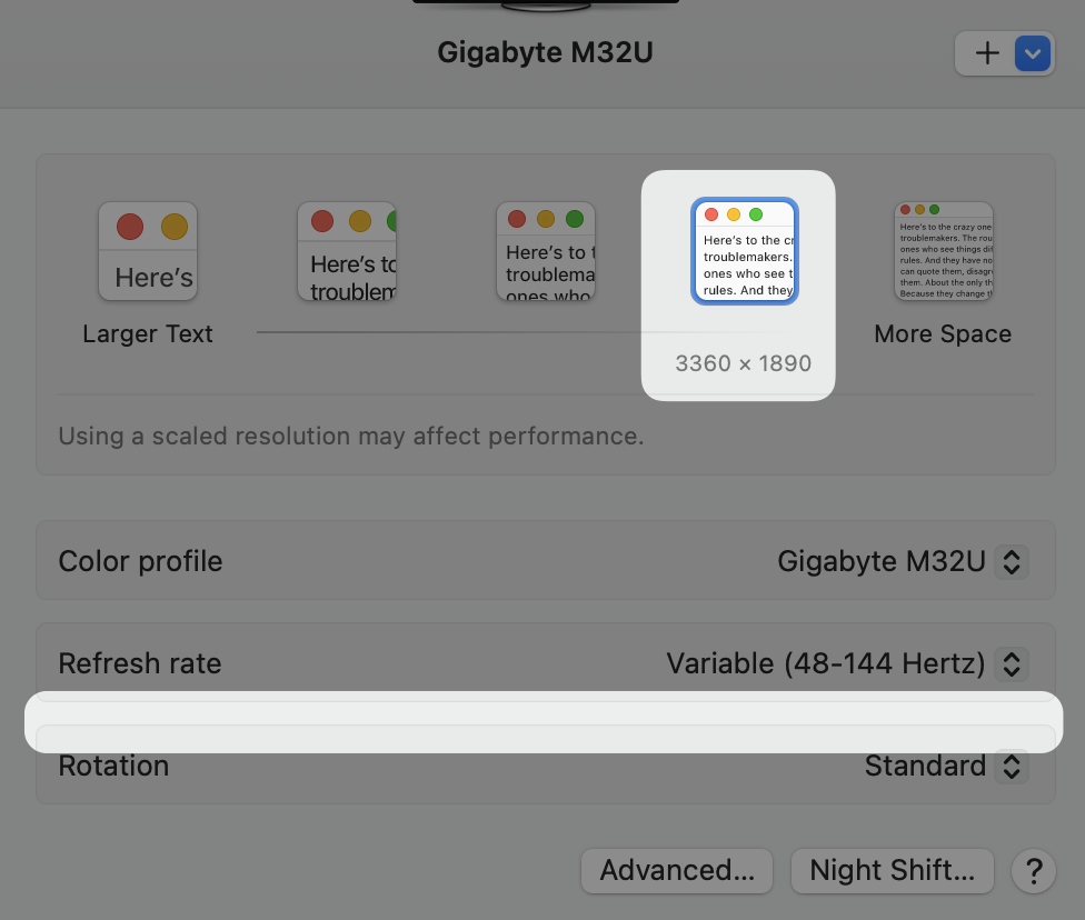

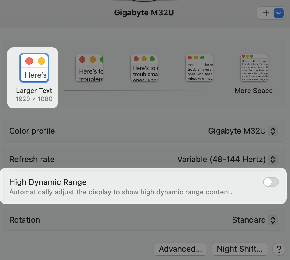

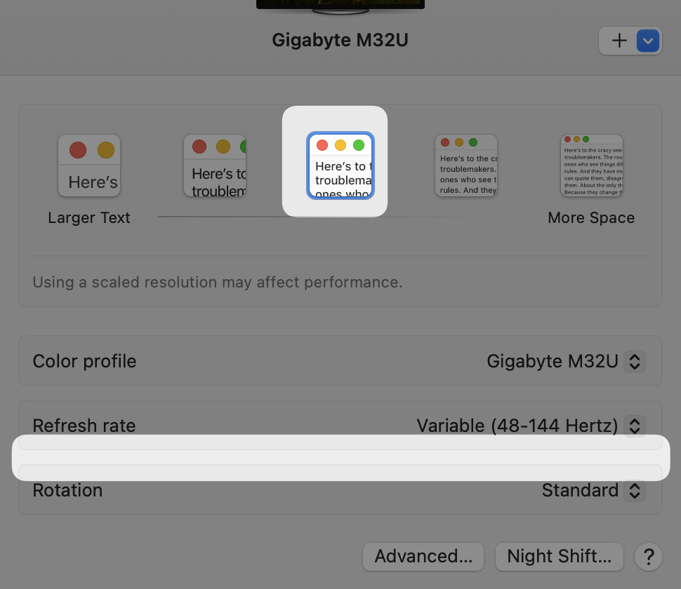

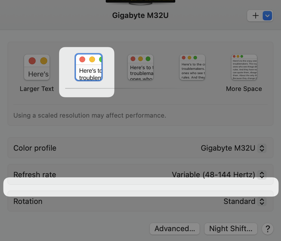

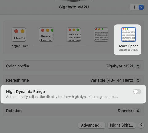

Having the same issue with a Gigabyte M32U.
Still cant seem to switch on HDR @ 3520x1980@120hz anything other higher than 60hz

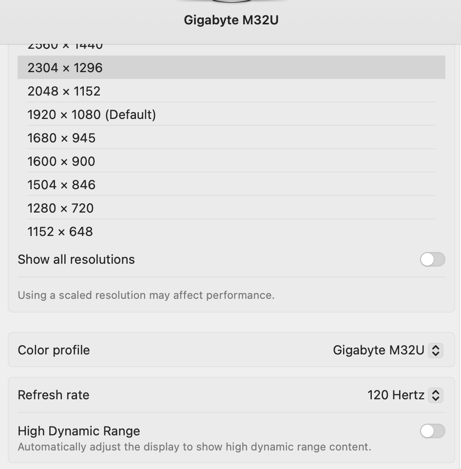

Just replaced my monitor with an ASUS PG42UQ OLED and ran into this exact same issue on my M1 Max MBP using thunderbolt to DP1.4 port.
Highest res I can maintain 120hz and HiDPI is 2304x1296, at 100hz it's 2560x1440. anything above that requires a drop to 60hz - havent done much tweaking this is just with better display, so perhaps there is a fix by butchering plists?
