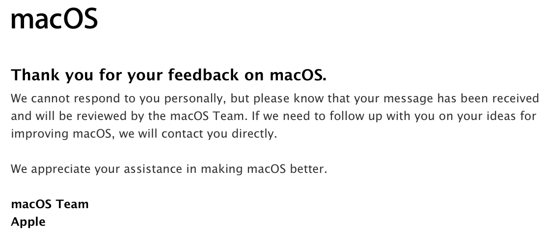

Bug reported...

I will submit this as a bug and encourage everyone else who has this issue to do so as well.
