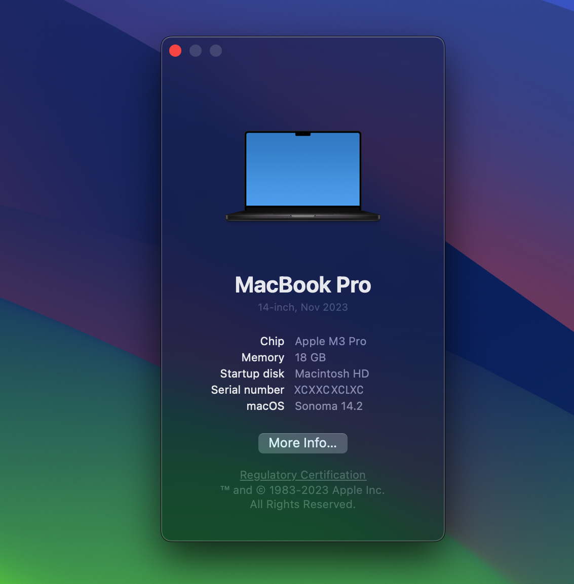

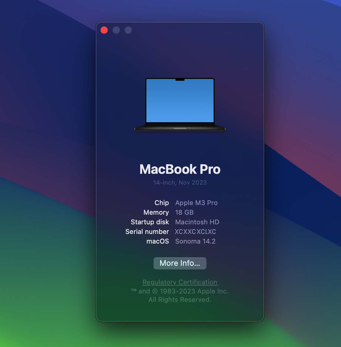

Well, I have installed Sonoma 14.2 and I have tried TG Pro, Mac Fan Control and iStatMenus.
I cant control fans before CPU gets to 77C, and only in the range over 77C I can set RPM to fans, but its not the way it should work.
Well, I have installed Sonoma 14.2 and I have tried TG Pro, Mac Fan Control and iStatMenus.View attachment 2436071I cant control fans before CPU gets to 77C, and only in the range over 77C I can set RPM to fans, but its not the way it should work.
Wait I just read that you updated to Sequoia and then downgraded. Some people also say that they downgraded and they can't control fans up until CPU gets into high temperatures.
So looks like Apple did something on purpose with Sonoma 14.7 and Sequoia that even when you downgrade to older MacOS versions you are not able to control fans when they're off.
