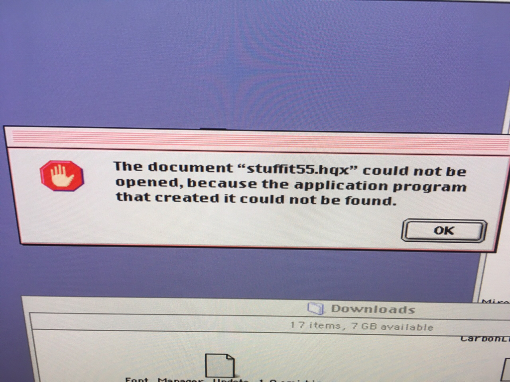

Hey all,
Just got a 300MHz Powermac G3 Beige. It is mint and came with Mac Os 8.6 already installed (it has also the original CD).
I am trying to install a pair of 3dfx Voodoo 2 cards, but everytime I try to run the .hqx file it says "the application "stuffit deluxe" could not be opened because Carbonlib could not be found."
I also tried to install other files (.bin) and .sit and it says the same. Any hint?

Thanks for the suggestion. It gives me this error. Any hint?
You have a chicken and egg dilemma. You need Stuffit Expander to decode the BinHex (.hqx) file, in order to install Stuffit Expander 🙂
Try the link to Stuffit Expander 5.5 (or 4.5) here:
https://www.gryphel.com/c/sw/archive/stuffexp/
These versions are in .bin (MacBinary) format. I just tested downloading the file on my Mac Pro (El Capitan) and double clicking the .bin. It decodes safely and is ready to transfer to an HFS or HFS+ volume to run in the classic Mac OS.
Just be aware that you probably can't use a FAT formatted USB drive (or a Windows system) to transfer the installer to the G3 as the necessary resource fork would be lost in the transfer.

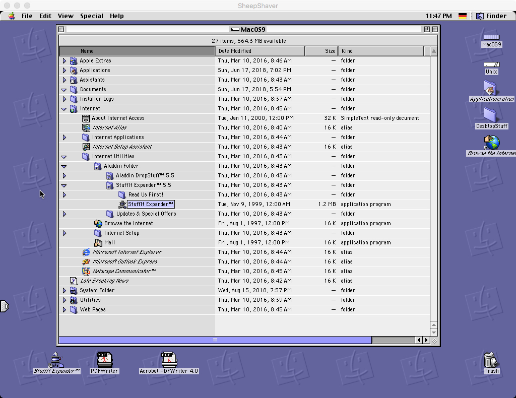

For some reason double-clicking onto a compressed file also sometimes does't launch StuffIt-Expander on my os9 machines. There ought to be a copy of StuffIt-Expander with os 8.6 too. With os9 it's in a subfolder of "Internet-Utilities". After I've put an Alias of StuffIt-Expander onto the desktop, drag&drop worked well on certain archives while double clicking the very same files always failed.

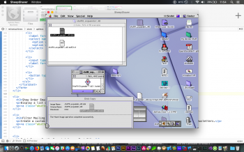

On the link I posted, try the .zip file near the top of the page. It has a disk image file within which you may be able to mount on Mac OS 8.x using Disk Copy, which is found in the Utilities folder (if it is installed). You could then decompress the zip on Windows, copy the image file to the G3, launch Disk Copy, mount the image file and install StuffIt Expander from there.
EDIT:
I just tested this idea in SheepShaver (Mac OS 9.0.4) and found I had to manually drag and drop the .dsk file from the zip archive onto the Disk Copy window (see screenshot) because the Mount command from the Image menu wouldn't show the .dsk file in the open dialog box.
