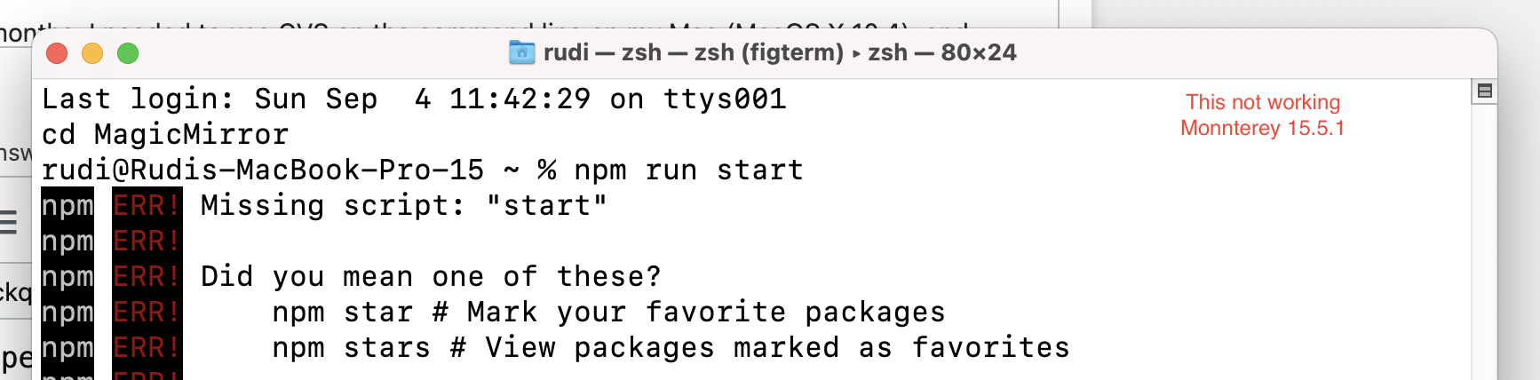

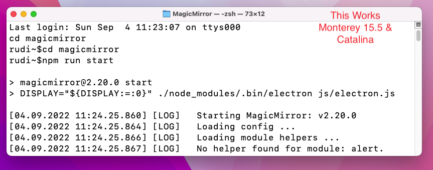

This simple script suddenly stopped working on my MBP Monterey 15.5.1. However it still works in my mac mini Monterey 15.5 and my MBP Catalina. The script refuses to Change Directory (cd) no matter what I try. The result being the "npm run start" command is presented to the normal command line not the MagicMirror directory. Thanks for any help/advice.
AppleScript:
tell application "Terminal"
    activate
    set shell to do script "cd MagicMirror"
    delay 1
    do script "npm run start" in shell
end tell[/CODE[ATTACH type="full"]2050866[/ATTACH][ATTACH type="full"]2050867[/ATTACH][ATTACH]2050866[/ATTACH]
Mimic of that working for me (cd with an ls in folder).
Might want to try this:
Code:
    do script "cd MagicMirror; sleep 1; npm run start"
    activate
end tell

While neither of your suggestions worked, bogdanw you nudged me in the right direction in that i thought is there anything else i can disable.
Turns out I had forgotten a small util I had installed, an autocomplete app called Fig.app, broke Automator.
Uninstalled Fig my Automator app worked normally, reinstalled it stopped working.
