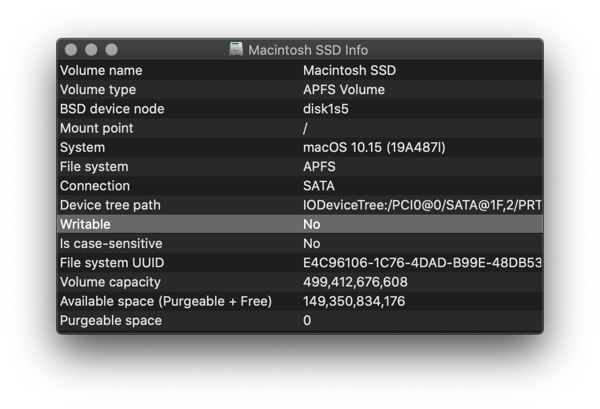

Can we make it writable to system partition?
It still mounts as writable if booted into a different OS, but this is going to be a huge hassle for system theming, etc. if simply disabling SIP isn't enough to always make it mount as writable.

Haven't seen the video, but the following command seemed to work:
Code:
sudo mount -t apfs -wu /dev/disk1s5 /Volumes
For anyone else wanting to try this, replace disk1s5 with the identifier for your system partition (you can find this in Disk Utility by clicking Info with the partition selected, then looking next to BSD device node), and follow up with killall Finder to restart the Finder.
[doublepost=1560876925][/doublepost]Thanks, going to quote this here. Definitely a bit cleaner than my command, but either one works. 🙂
Just discovered that if you run sudo mount -uw / in DP2, you can delete/modify files in the protected partition. (Might have to killall Finder afterwards for it to detect the change.)
[doublepost=1560877401][/doublepost]One-line solution that works once logged in (with SIP disabled):
Code:
sudo mount -wu /; killall Finder

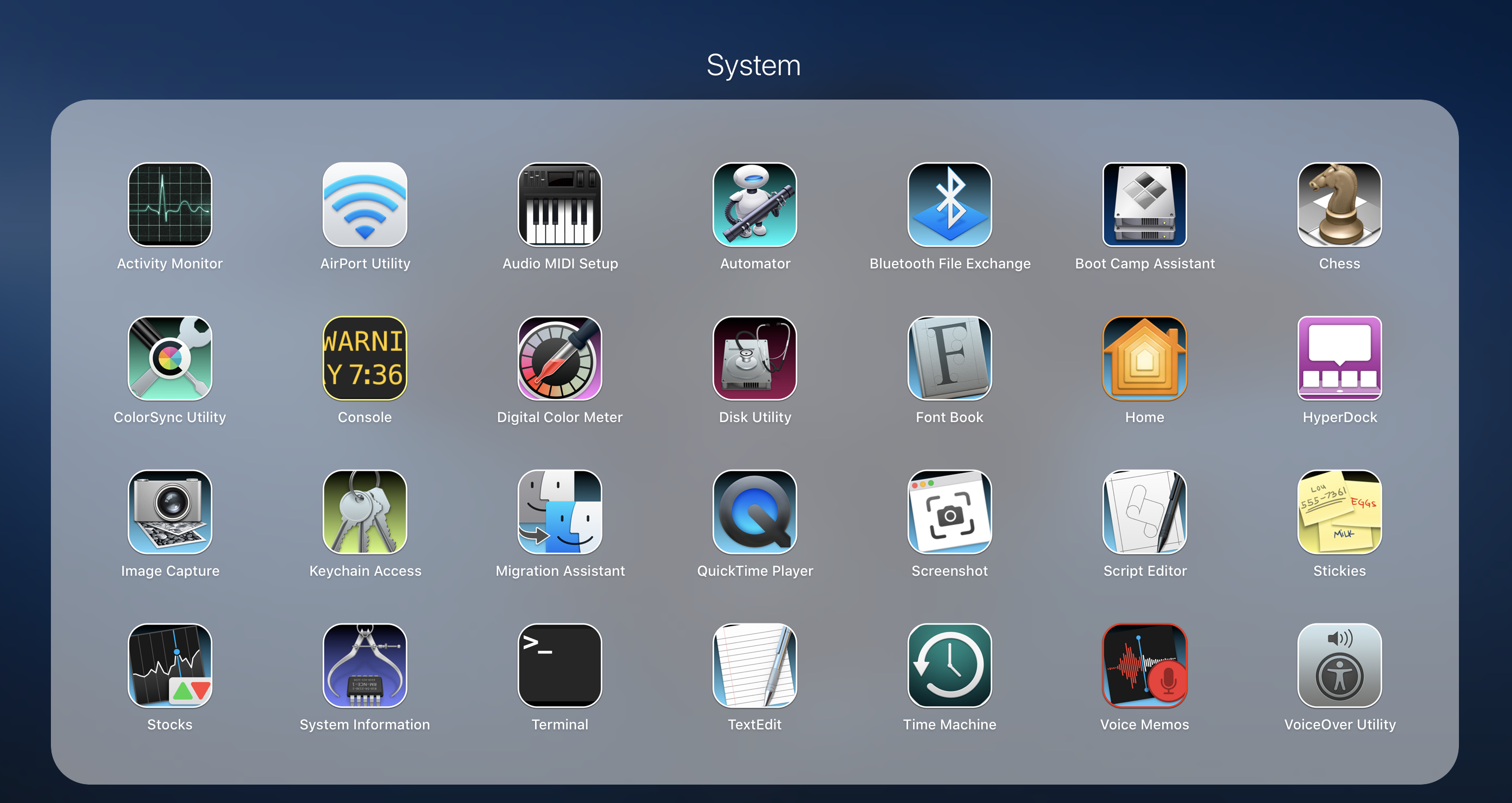

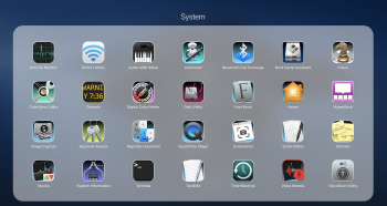

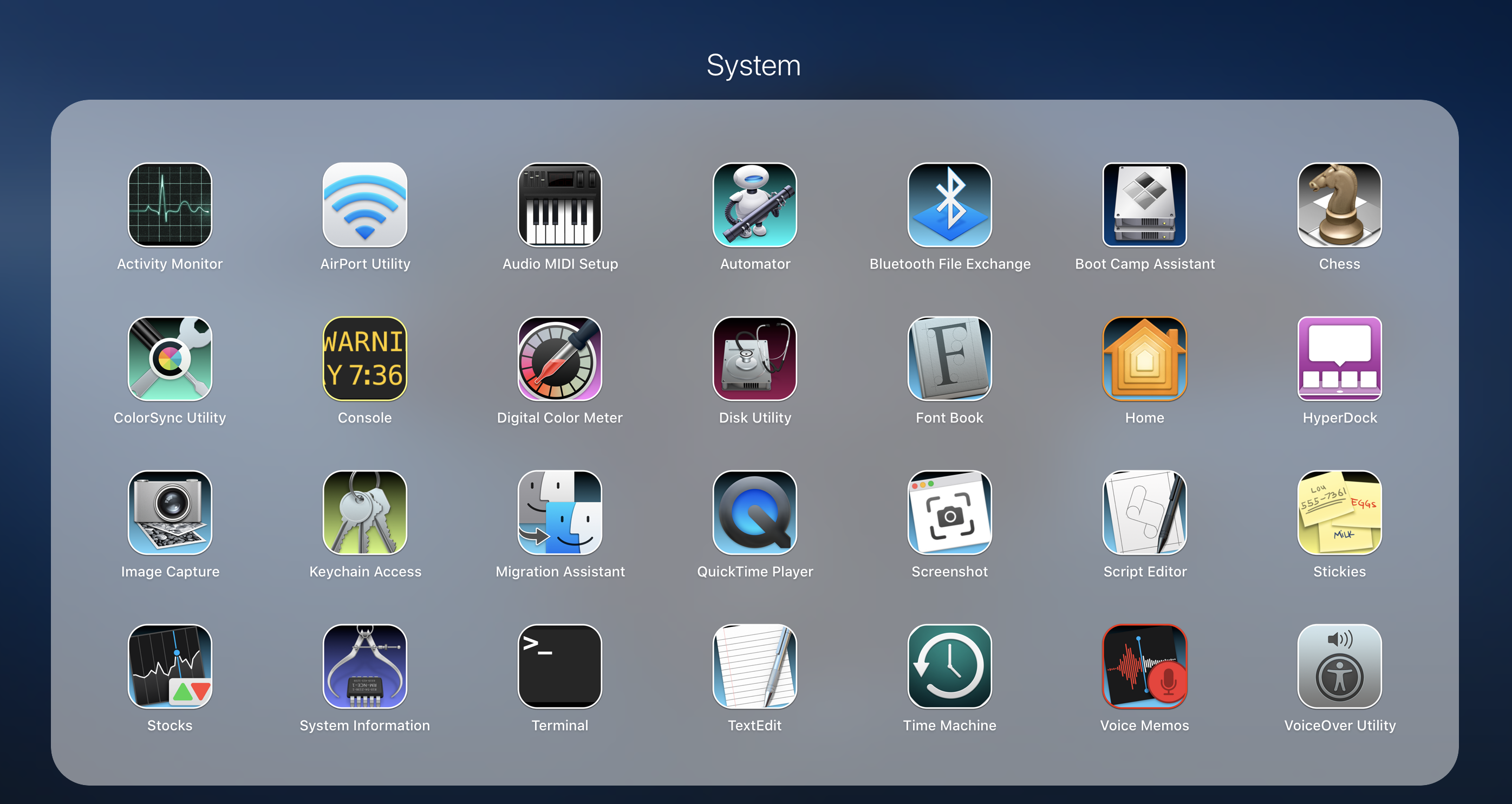

I know this is going to sound silly to all you macOS geniuses out there, but I like to customise my system icons and wrap the originals in an iOS-like shape so that they have a uniform appearance when placed on the Dock or viewed in LaunchPad. Since I was no longer able to do this even with SIP disabled, I'll give that Terminal command a try to remount the system volume with read/write access. Thanks so much for the tip and I just wanted to say I'm very grateful for all the expert advice given here!
Cheers
Edit: The command worked! I received the following error message in Terminal, but was still able to modify system application icons or replace them outright.
Failed to stat file //AppleInternal, error No such file or directory
Thanks!
Cheers
Thanks!
Glad you found a workaround to it. You can also do it through NSfile commands as a replace command for the apple resources container but I would check it repeatedly through the DP process because I'm not sure if it will be persistent after a point. It should be if they are apps on the secondary volume and not system volume but I would check after each new DP anyway
