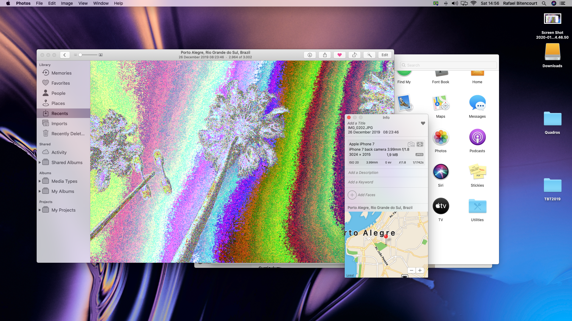

Hello everyone! I've successfully installed Catalina (21.5 inch iMac Mid 2010 - ATI Radeon 4670) using dosdude1 patcher.
Everything works perfectly fine, except for the Photos app, I have no idea of what may be causing this issue, because when I open any kind of image file using the Preview app, it's displayed correctly, but the Photos app is showing some photos with this (very exotic "filter") - couldn't find better way to describe this... :

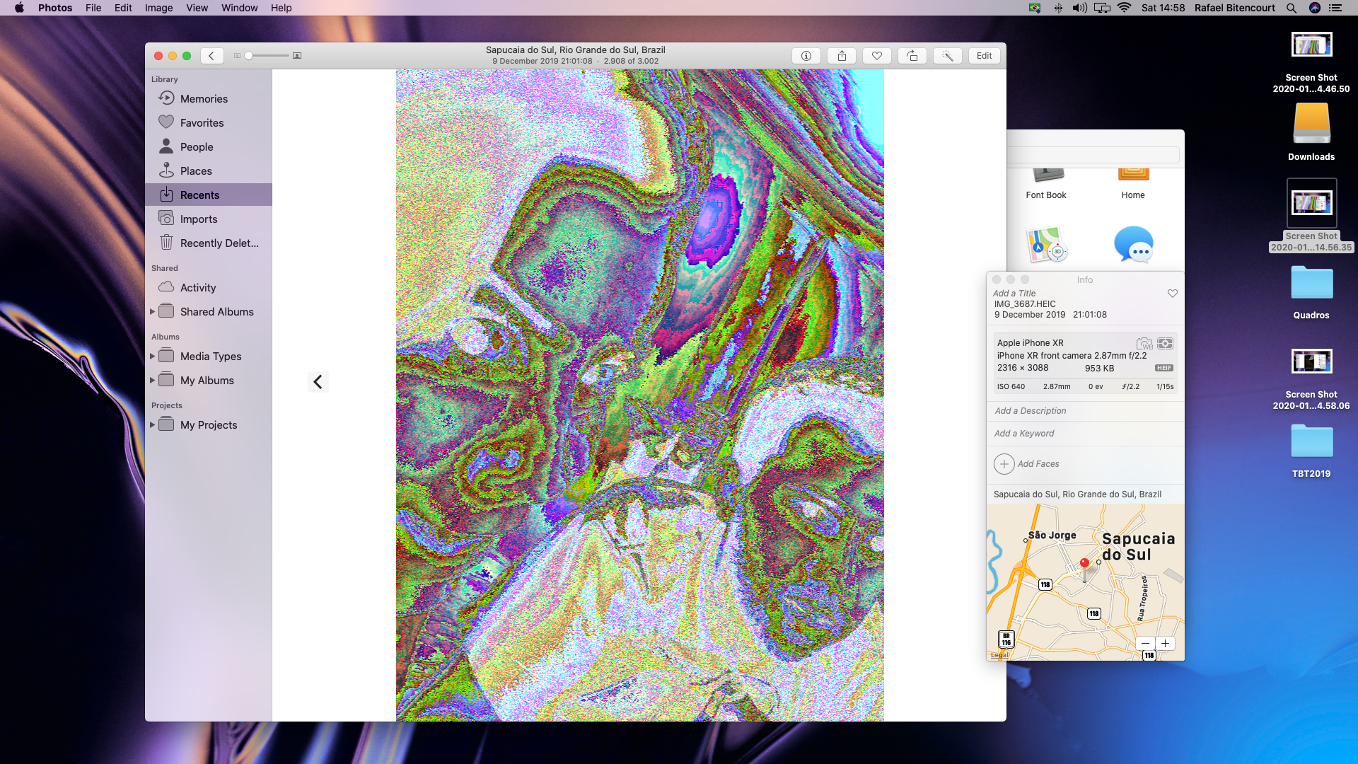

I tried checking if it wasn't related to the file format (JPEG or HEIC) and apparently it's not the cause, it happens with both of them. Interesting is that videos, and so Live Photos are played correctly.
JPG:
HEIC:

@MacTobi, thanks! It worked here, but in my case, it was from 8bit to 4bit...
[automerge]1584806803[/automerge]
@nonno, @MacTobi 's solution worked here me, hope it works for you as well...
[automerge]1584806999[/automerge]
@MacTobi, even editing the photos is possible now... thanks again! I really thought it was never going to be fixed.

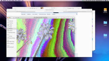

So, I decided to run that tool as well. However, I still have issues:
New photos that I import into my computer from my camera SD card look like this. And when I go into edit mode on older photos, they also look like this.

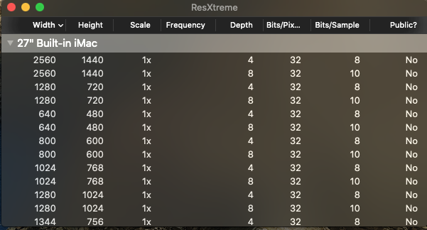

Following the instruction by @ASentientBoton on reddit led me to this tool, which I used to force the colordepth to be 8bit, rather than 10bit, which solved my issues. It should solve your issue aswell
