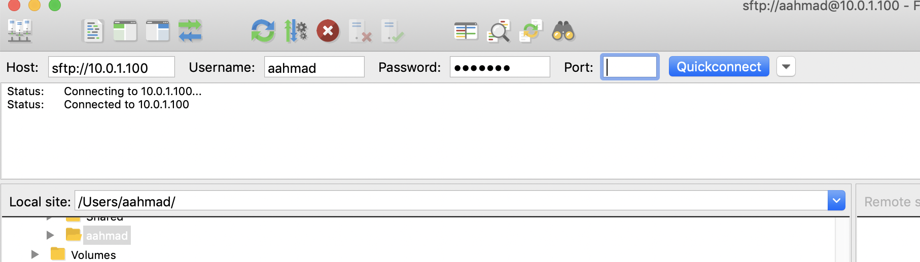

When I try to connect to my server from another laptop (Linux), it connects, but does NOT show me any directory listings on the server (Remote machine running MacOS).
Anyone have some quick ideas on what to try to get things working? TIA.
What are you using to connect from the Linux machine?
What happens if you just ssh to the Mac from the Linux machine?
SSH works fine, with no issues. I'm using Filezilla on my Linux machine.
What is the initial path FileZilla is set to use?
When you connect via SSH, can you change directories and see the directories you want to access?
If you look at the last line in the output on the top, it DOES say connected for the last status message.
It doesn't look to be connected. Can you scroll down in the status panel at the top?
You don't need to do any special configuration to use sftp on a mac if ssh is enabled- by default sftp will just work as long as your credentials are valid.

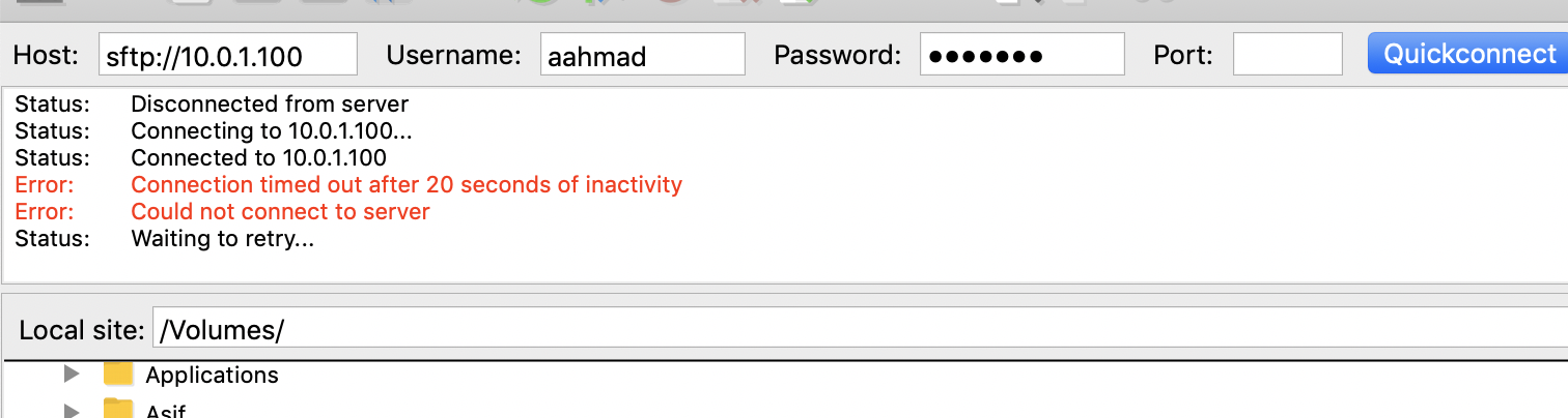

Restarted the app, and tried re-connected according to the status panel:
It looks like it disconnects after about 20 seconds? Unsure what's going on...it appears to connect initially. Thoughts?

Ok so @A4orce84 @brock-2021 I just ran a quick test in a Debian VM. I installed FileZilla, plugged in my host OS IP, username and password, and sure enough it failed to connect, failed to show me any prompt about accepting the server's fingerprint etc.
I stuck a port number, and it connected and showed me the prompt for the fingerprint. Alternatively I tried it with sftp://<ip> and no port (as @A4orce84's screenshot shows) and that too worked.
If you can define some more attributes about your setup (specific Linux distro & version you're using, FileZilla version, macOS version) we can no doubt find out why it doesn't connect properly.
Upon closer inspection: @A4orce84 appears to be running FileZilla on a Mac: It's showing very macOS-specific paths in the local pane.
