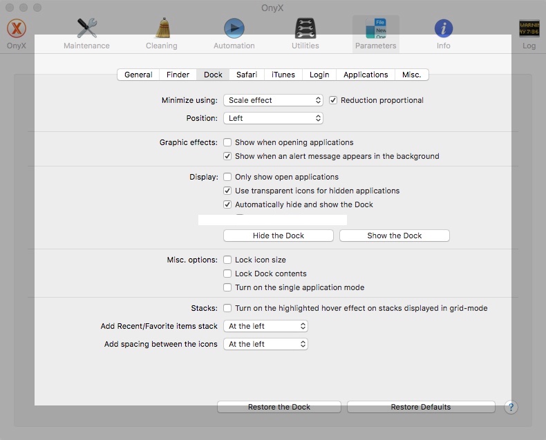

what's the minimal pixel that is possible for the bar at the bottom?
does that permanently hide it without leaving a placeholder? cos the bar at the bottom is something built into the os
cant find a screenshot on the site. if so how did you find out about it?
If you were asking me...I think it hides it until you change it back with Onyx (or Terminal, I would presume).
I tested that OnyX hiding the Dock. It appears to keep the Dock off. Doesn't appear at all, and apparently is not automatically triggered by moving your cursor into the Dock area. You CAN make the Dock appear even then by pressing Option-Command-D. Press the same keys again to hide the Dock. But, in my test, I could not trigger the Dock by moving the mouse cursor into that area.
@whichimac: even if there is a placeholder (I can't tell), you can move the normal location for the Dock to either the left or right side, so nothing can happen unless you choose to use that edge of the screen. Again, as far as I can tell, there is no residual placeholder when using that option from OnyX. I never knew that could be done with such a small disruption.
