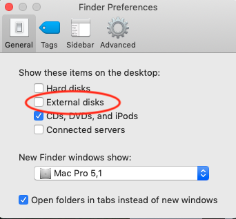

Try going to "Finder->Preferences->General" and deselecting "External Disks".
