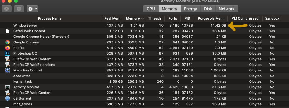

Pray tell, why does the Window Server eat RAM like crazy? What does it do with it? How does it benefit me?
It currently keep 14 GB (21%) of cached RAM that is said to be purgeable, that cannot in fact be purged. It is a black hole of wasted RAM.
Evetually, you need to reboot or kill the WS to get back to normal.

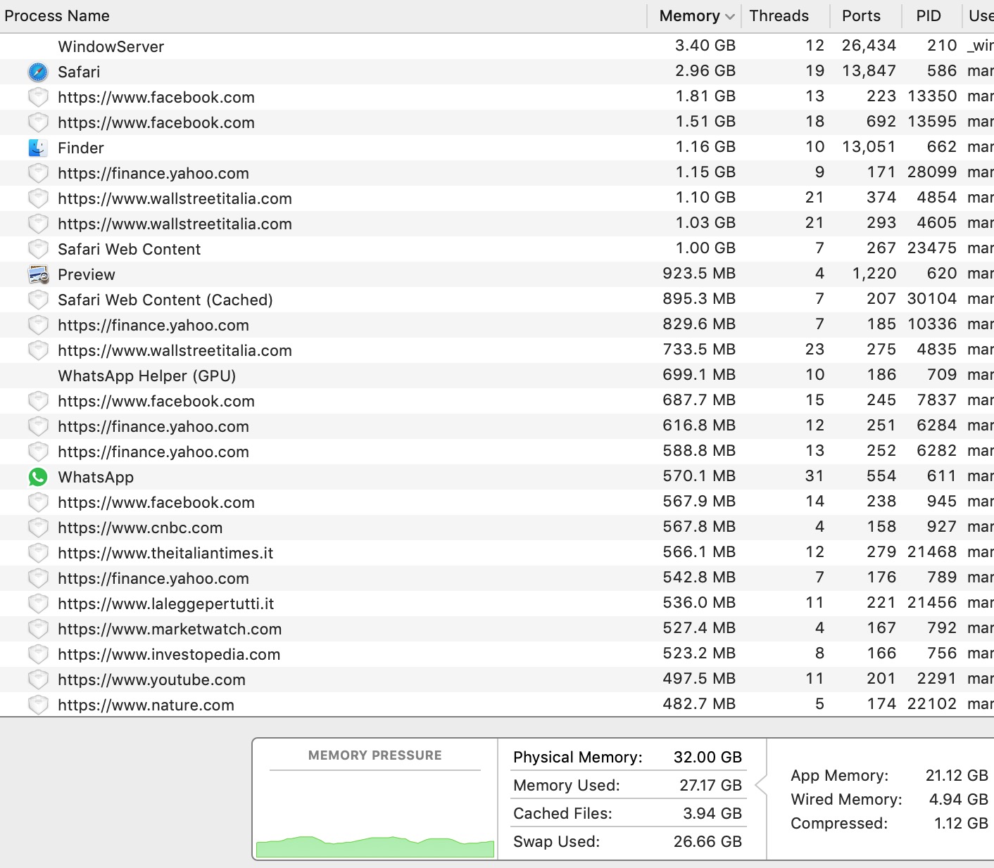

CHABIG, I have the same problem but your tackling the solution is kinda slaloming the drift you want and not what the one of the question person needs.
MacDos above is surely asking that because if the RAM runs out, than starts writing on the ROM disk AND it takes away huge amount of time and frustration! .. so the plausible question stands... especially when it is not an APPLICATIONS like MacDos is complaining (where we cannot ask an APPLICATION to be RAM Sensitive?! or can we?) but my problem is that I run 100s general finance/telecom/social/ portals/statistic/trading websites and crazily now, each of them, is reaching the HALFGig average and 1 starting to become not an exception! ...that is nuts! ...
The second question related is: but why when 4years ago I had 8Gig of memory the same 100 websites were just above the need in size (RAM 8 ROM 5). When 2 years I mounted 16 then the same 100 websites went about the 16 in almost no time (RAM 16 ROM 12 average).. Now 1 year ago I got max 32 and here again (RAM 32 ROM 25)!
I am ok that Companies are expanding the websites at very high speed, but it also look like there is constantly a COMPUTER MODEL trick in expansion almost to reach the point that we need to buy another computer, and if we think it is the only spot that Computer Makers can gamble with our wallet giving the fault of an OUTSIDER! The WEB! ahahah
There is something fishy! and if you computer nerds (read it as a bowing compliment!! please! we need you all the time!) cannot figure it out, who can?
Look at my Utility where www.wallstreetitalia.com it is a ONE PAGE web 1GIG ! ahahahahah
THANK YOU FOR YOUR TIME! God bless your work.
marino
PS: please don't tell me turn off and on ... if not I laugh!! ahahah
If you install 256 GB it WILL utilize all it can for caches and buffers, etc. It's designed that way. As you can see in the graph you posted, memory pressure is fine in your computer. I still don't understand why people want to have memory unused...

What I have noticed, on my system, is that the size of purgeable memory, as shown in Activity Monitor for WindowServer, does drop. I have seen it go up to several hundred MBs and drop back down to several hundred KBs. So the system does take care of releasing the purgeable memory. What you didn't show is what the memory pressure looked like on your system, that is probably a better indication of what is happening rather that just looking at the size of the purgeable memory.

I think you are looking at wrong field. You need to look at Real Mem or may be Memory field (one is footprint in RAM, the other is after uncompressing this footprint). Purgeable memory is memory which was used and is left cached "just in case the content there is needed again". If the same content is needed again, it is faster to restore from cache than recreate. Your Mac Mini 2018 system has 64GB of RAM (based on your signature), it can do that without any issues. It has RAM to spare, even with this load... Purgeable means that if needed, it can be purged and used by other applications.
WindowServer using only 1.21 GB of RAM (440MB real physical RAM used) on this loaded system is not unusual and is actually on lower side from what I have seen.
Now, if you want to complain about something really bad, look at your "Macs Fan Control" - if the name is right, all it does is control the fans to you have them faster or slower than what system wants. Why such feature should need 357MB of RAM? Nearly same as your whole WindowControl, which actually does something useful...

When RAM runs out system will purge the purgeable memory and provide it to process which needs it. This can be done very fast. Also, system keeps some fraction of memory empty, ready to go in any case. My system (16GB RAM) typically holds back about 2GB of RAM for such cases. When it needs more, it will make it available by purging and if that does not work, by compressing memory which has not been needed for some time. Eventuallyswapping it out to swap file. There are some nice descriptions on line about macOS memory management, and it is science... Google it, it is fun read.
Also, no one is ever writing anything to ROM ("Read only memory", not writeable), macOS on your MacMini is writing in SSD swap file. Apple SSDs are very fast - over 1TB/second - faster than RAM was just few years ago. So all that complicated stuff above about marketing tricks, and computer good for 6 months is complete nonsense. Ask those around here who are successfully using their 10 years old systems, with 4Gb RAM and swear by them. People even hack their old systems to get Catalina running on them and it works.

WindowServer keeps track of all windows (application and system) that need to be displayed and generates them. It does this in 3D space, so it requires a decent amount of RAM and/or Virtual Memory. If you only have integrated graphics, it might require more working space.
Purgeable Memory isn't for the user to purge. If Real Memory becomes full and Virtual Memory space is unavailable, Purgeable Memory can be purged, sections at a time. If Memory Pressure changes away from green, you will likely see such memory purged.
If the machine is not suffering actual performance problems and it is only your perception, you should let the machine continue. Starting again means that you are probably causing performance problems because the stored attributes and conditions of windows have to be re-created.

Is it normal that 10 Websites are 1 GIG big?
HOnza, do you ever have to turn off your computer because it gets stuck and slow? If you answer no, it is because you do not have my needs or you know how to keep it smooth. BUT THE AVERAGE and let say also the MOST 98% of the consumers do not know that procedure, therefore why Apple didn't automated it? maybe because they want to create the problem and the stupid consumer like me need to buy another one?
THANK YOU AGAIN,,

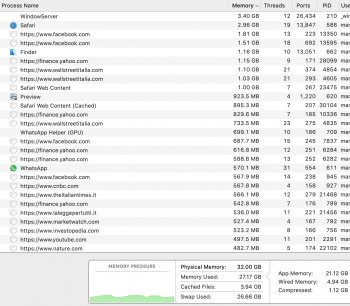

You write that all 5 Macs you own have that problem. Millions of Mac users do not have that problem. And your Activity Monitor screenshot looks very good – nothing wrong with these figures.
Possible conclusion: you have installed something on all your Macs which is slowing them down.
Also on a side note: you do not need Acrobat Reader on a Mac.

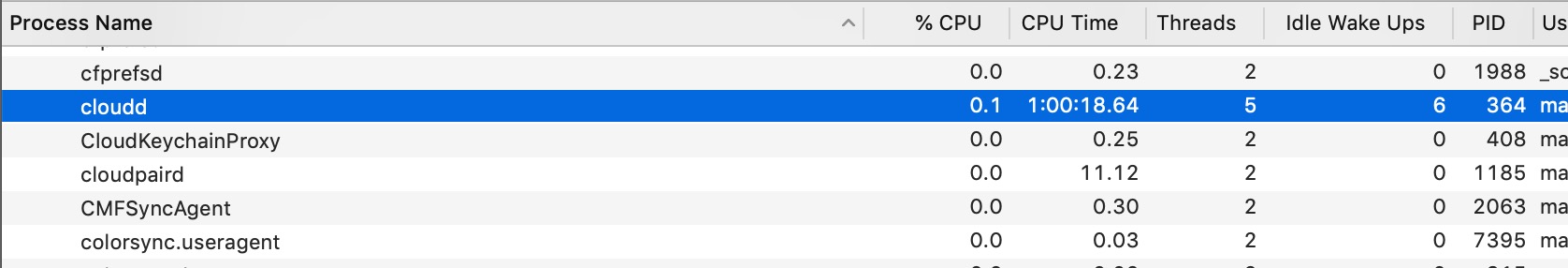

This the latest experience: Yesterday it rebooted on its own for updates .. Started smoother with all the websites running .. many opening extra to study when time is avail ... Today I open and close some many extra windows, and I quick notice what is the first signal of SLOW DOWN !! I load a set 20 Yahoo Finance stocks pages in diff tabs, and computer starts to run the FAN at max speed ...which is noisy and here that the computer start to be slow!! ... after I close some windows (and here I start to lose time and frustrated ) or I do not use the computer for a bit of time, the Fans stop and the computer is become pretty smooth ,,,, I am sure if now I go on the Finance desktop and start to go around those big webpage it will start again the fan and start to be slower ... exactly ! it did it again! fans runs and computer is slow
Is the fan running indicating something important ?
and then I find out this PIC I am attaching ... 1 hour of use of CPU .. can it be something that taking precedence to do in iCloud it slows me into the normal running of the computer?
Always grateful!

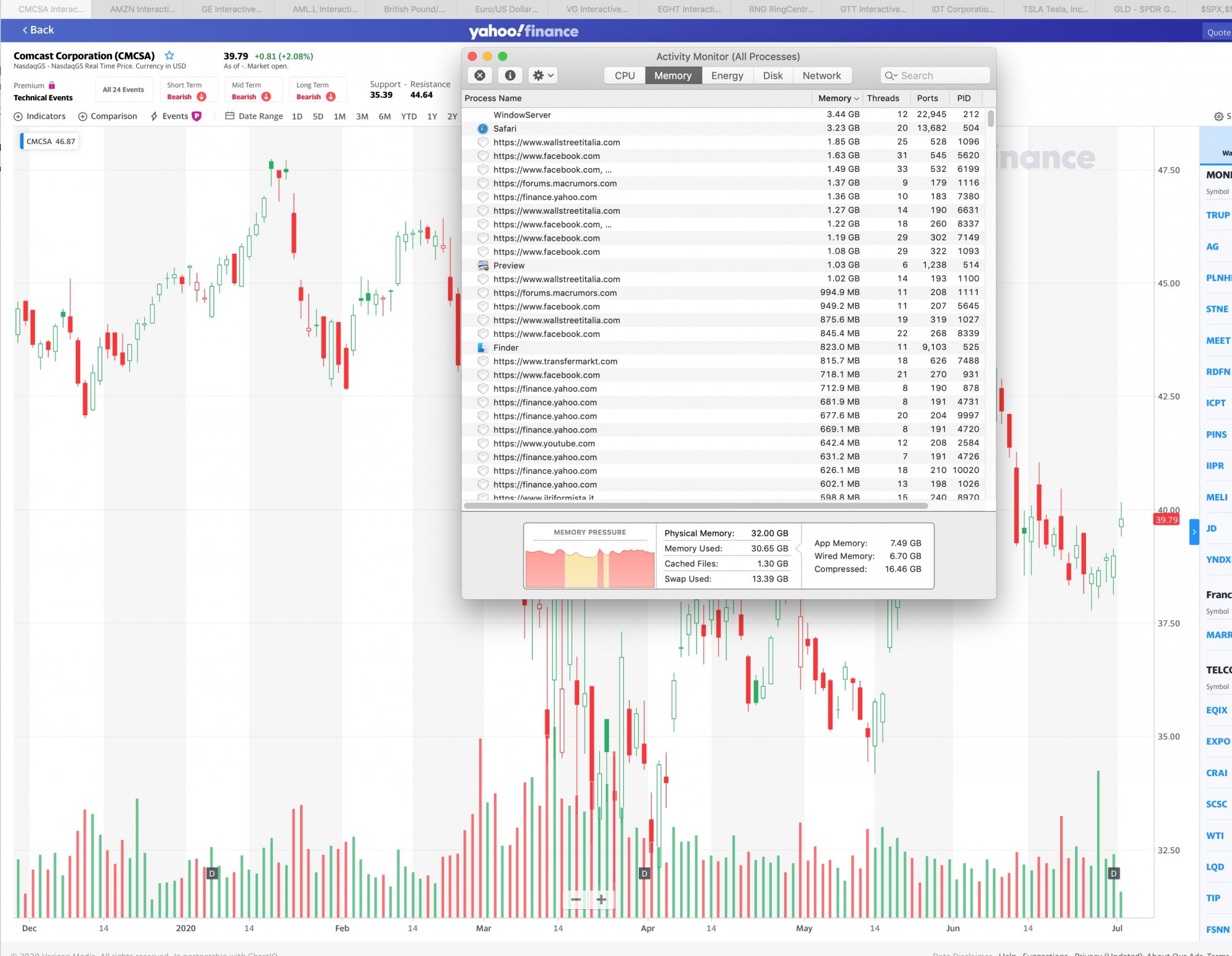

Pathonza!! Finally I found a way to prove it to you ..
maybe with this we can be more proactive than just explaining wording ..
GRAZIE!
marino
PS: I am praying for your knowledge

Based on that picture, your memory is under pressure and you will have issues. But you are complaining in wrong place... Apple is innocent. It is your software which asks for too many resources.
1 limit number of windows in Safari. Easy solution.
2 complain to yahoo that their pages are too memory heavy. Way too heavy...
Apple has no control what each page downloads and runs. Think about each web page today as small virtual machine with Java based operating system. Each tab needs its own memory, they can not share. 20x same page = 20x memory.
yahoo poorly designed graphic and memory heavy page. Works ok if you have it opened once. Open too many times and you have problem.
and since these are running and updating all the time in the background, they cannot be minimized well in memory.
Your problem is blaming computer for bad software. Web pages are software... Or you need computer with lot more Resources. But every time users add more resources, web designers waste them much faster. It is even likely, yahoo checks how much memory you have and if enough, downloads to you much more heavy version of the same page... Typically to get more adverts in front of you.
