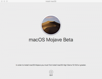

But I cant upgrade to Mojave unless I upgrade Hight Sierra first.

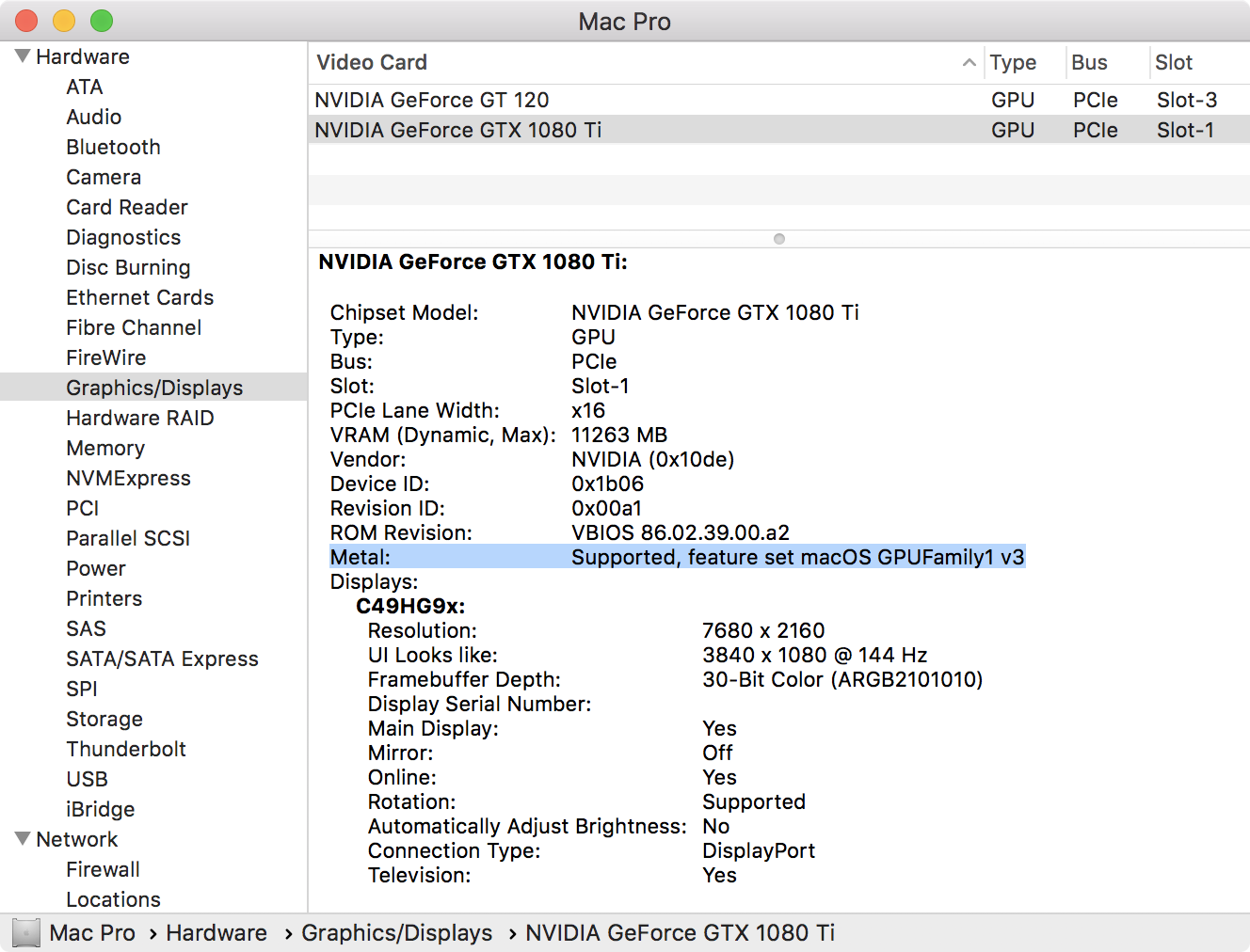

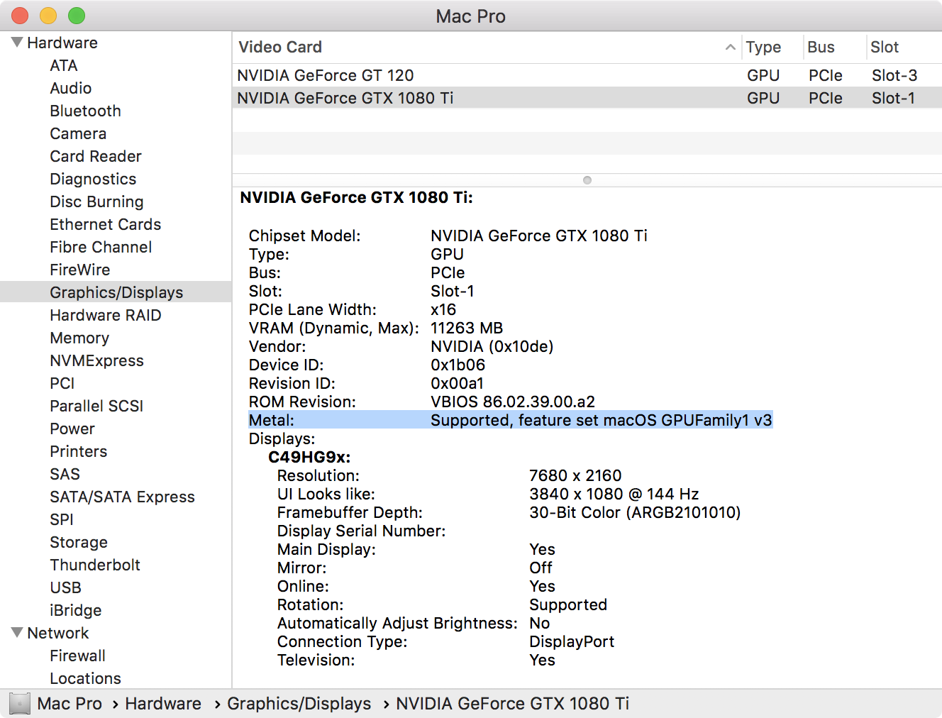

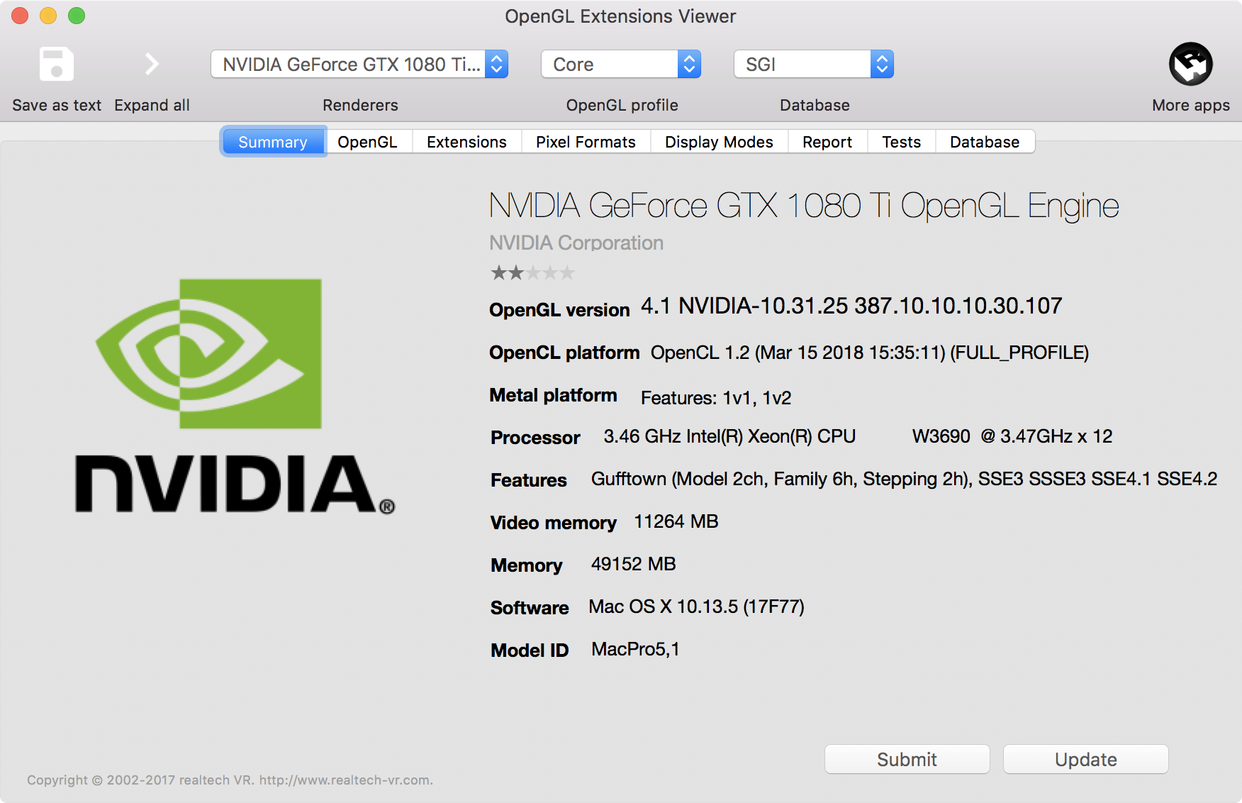

About Mac - Graphics & displays (or similar), you'll see metal support.
For Mojave, please do what the installer says.

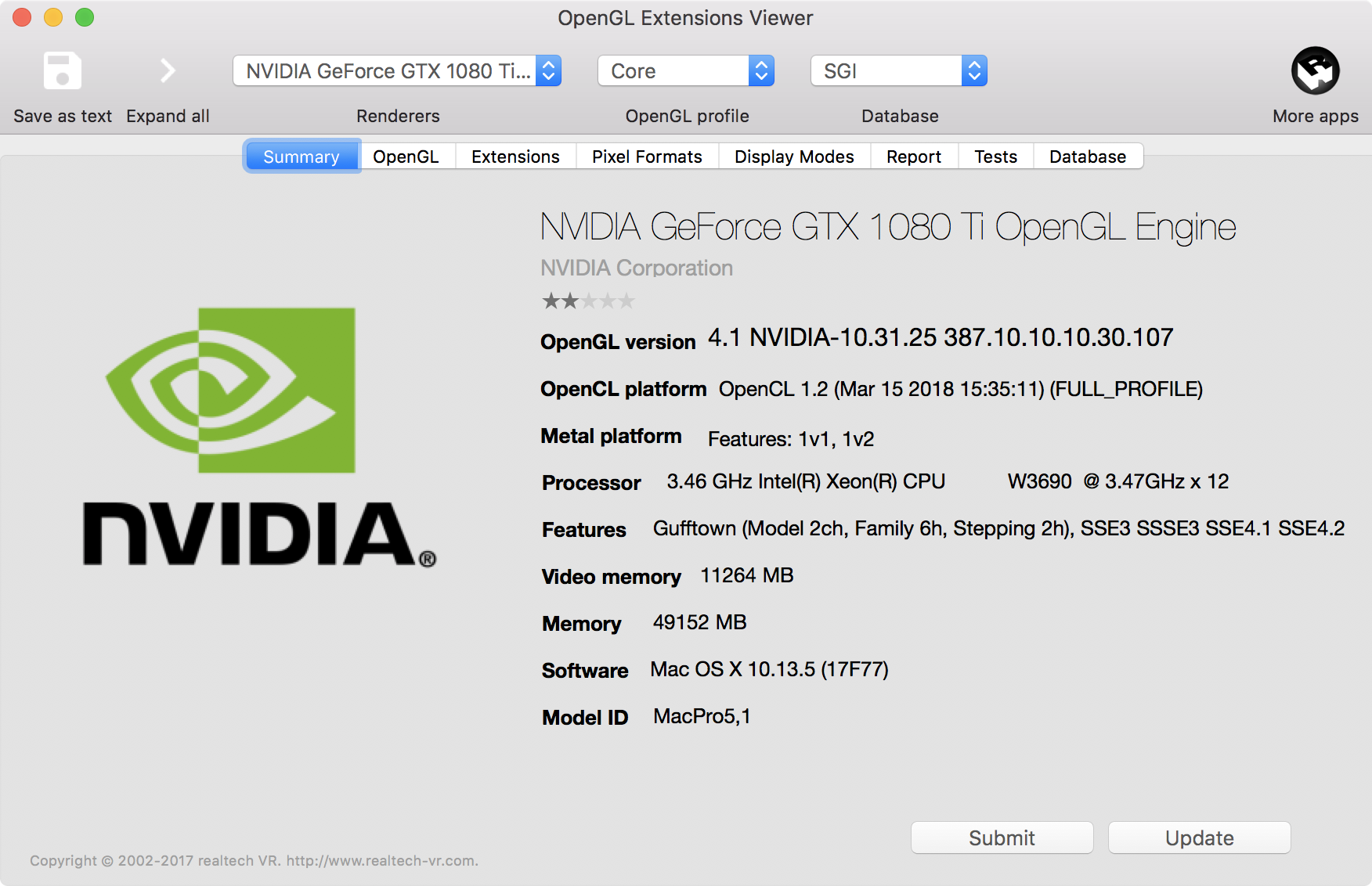

AFAIK, NO. I can run the 10.14 installer in the native way with just my 1080Ti installed.

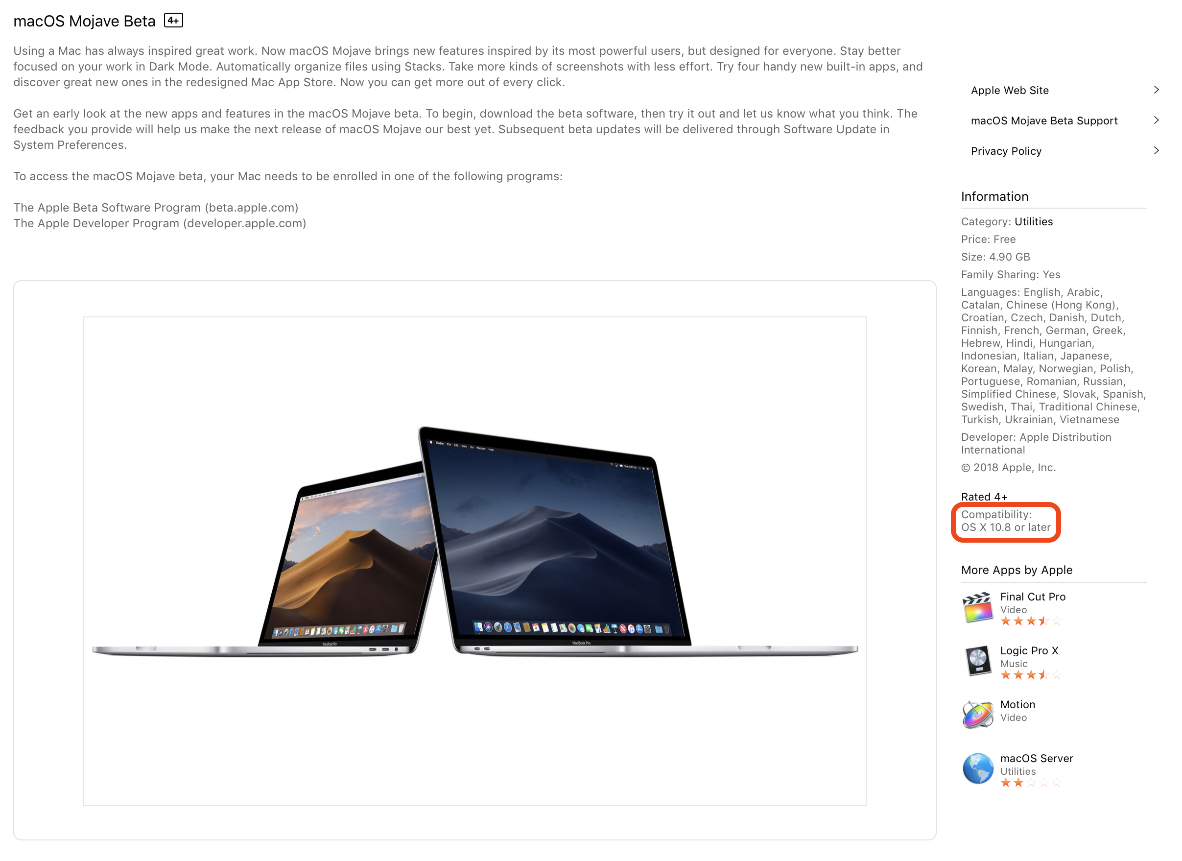

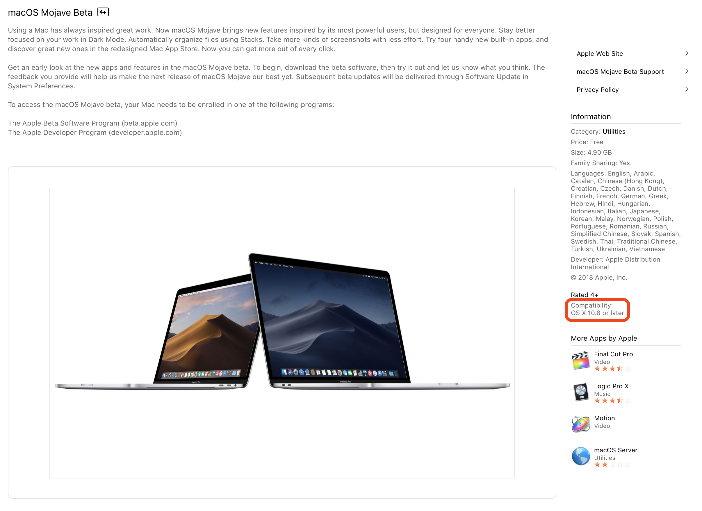

I had to upgrade to High Sierra in order for Mojave Beta to install. I was running Sierra. I think it's because there is a firmware upgrade for Mojave that is only in the High Sierra installer.
I know where to find it. I had replied to another thread where someone was looking for the firmware. I only found it in the High Sierra installer.
AFAIK, there is always a firmware for the cMP in the 10.14 full installer. The earlier version has the 0085.B00 firmware, and the latest are the 0089.B00.
Did you download the full installer from Appstore?
Reactions: crjackson2134
yes I have kept all my installers and made bootable USB drives with them. I checked all the way back to Mavericks and only High Sierra has the firmware folder in it. I even checked the raw installers as they are on my NAS. Not sure if it makes a difference but I downloaded all of the MacOS installers with the exception Mojave on a 2010 iMac 27" I7. I just recently went to a mid2010 MacPro 8 core dual processor machine.
For me, Mojave's full installer always has the cMP firmware included. Always at the same location.

If the card is a Kepler/Maxwell/Pascal and support Metal, yes.
No need of DP1/DP2 workaround since DP3.
