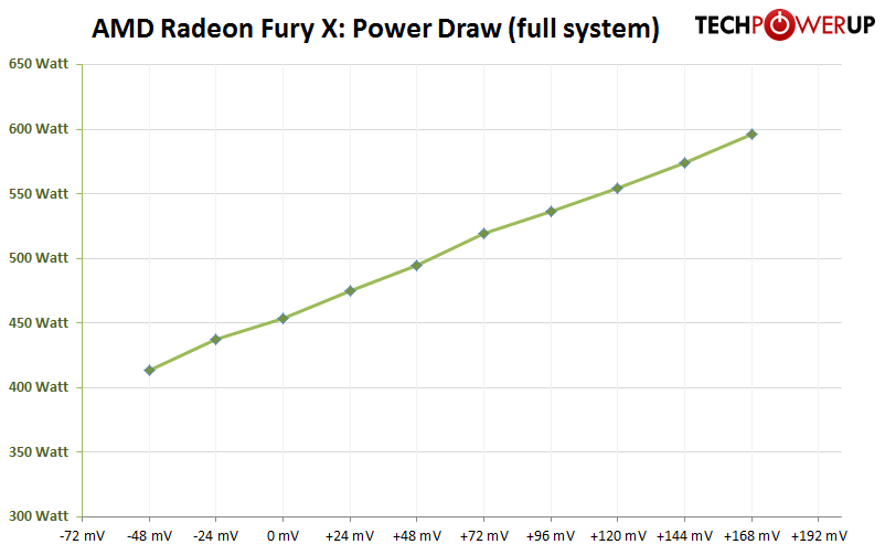

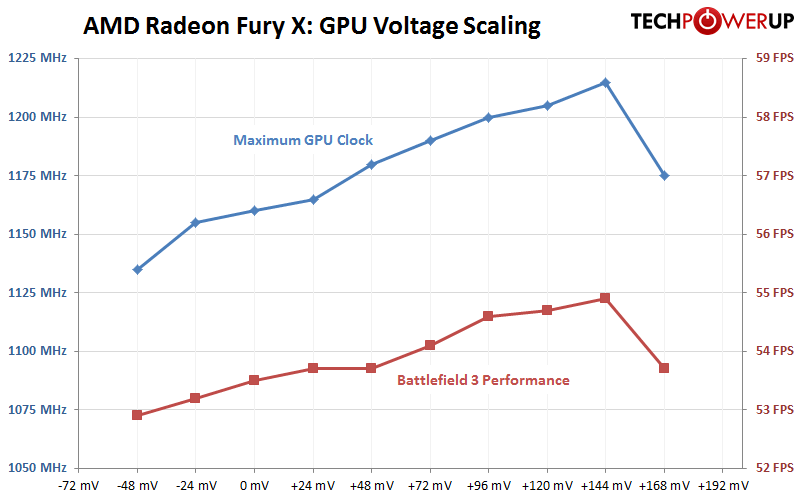

https://www.techpowerup.com/reviews/AMD/R9_Fury_X_Overvoltage/2.html
Note the under voltage: -48mV and compare it to Asus Strix Fury voltage and power consumption. 216W TDP, at 1000 MHz of core clock and 1.169V, exactly 43mV less than stock voltage on Fury.
At 1.169V the power consumption of Fury goes 40W down, at 1070 MHz(20 more than stock clocks).

One thing to note. Sapphire Fury that BareFeats used in their tests has 1.188V on core, and uses 29W of power more than Asus Strix Fury.
Edit: After this post I looked at this:
So to run the GPU at 925 MHz you need under 1.1V on core.

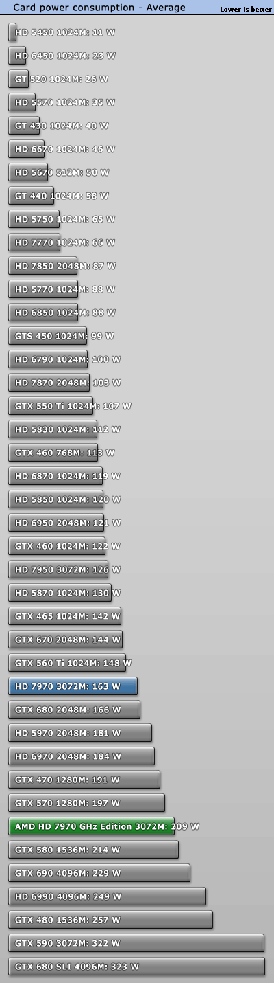

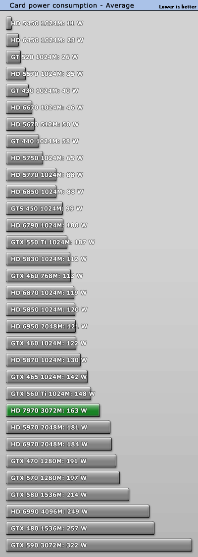

HD 7970 at 925 MHz had 163W power consumption 😉.
What happened when they increased the stock clocks by 125 MHz to 1050 range? 😉
So it was possible to put HD7970 into 129W thermal envelope 😉.
But Apple not only down clocked the GPU, but also undervolted it.

It is possible 😉
