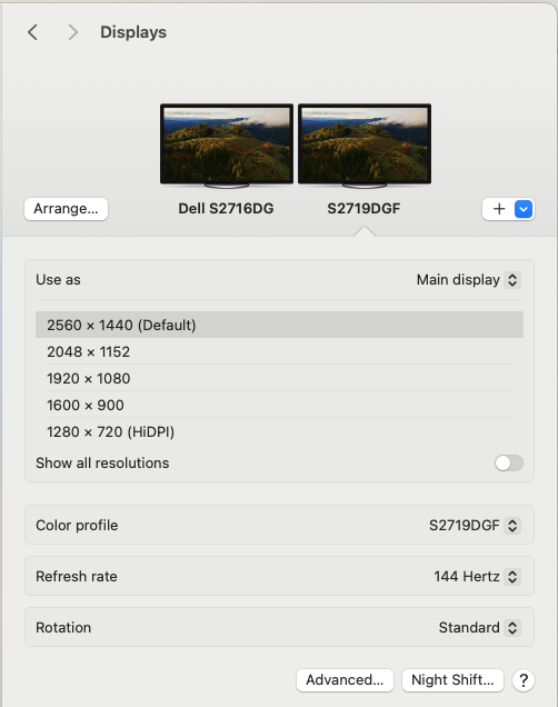

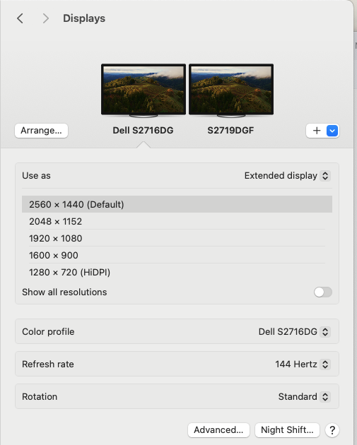

First off I have a 16" M1Pro but here you go:
Individual USBC cables to the monitors, one is USBC --> Displayport, the other is USBC --> HDMI, the reason for that is at one time I shared the S2719DGF with my gaming PC and the only way to get a higher refresh was through Displayport (GSYNC).
Thank you for the detailed reply.
I too have GSync monitor, with two HDMI and one DisplayPort with the DisplayPort being occupied by my gaming PC.
None of the specs mention 2K at 144, the HDMI port and all cables just say 4K at 60. I suppose 4K60 implies 2K120.
I think I’m just going to order some usb c HDMI and DisplayPort cables and plug them in and see what I get. I may have to use DisplayPort to get full resolution and refresh.
