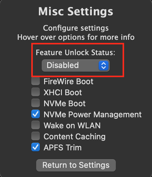

I tried. I adjusted the settings to partial (to disable sidecar) and rebuilt OCLP and reinstalled. I saw it say it was set to disable sidecar in the build log before I installed it. But when I loaded it back up, the was still enabled. Do I need to completely uninstall OCLP first?
Make sure that the FeatureUnlock kext is no longer in your EFI partition and is removed from the Config.plist. Reset NVRAM after that.
Mounting EFI and resetting NVRAM instruction https://dortania.github.io/OpenCore-Legacy-Patcher/UNINSTALL.html
You can edit Config.plist with any txt/plist editor or with OpenCore Configurator https://mackie100projects.altervista.org/download-opencore-configurator/ or OpenCore Auxiliary Tools (OCAT) https://github.com/ic005k/OCAuxiliaryTools
found this site also advising disabling sidecar, but my OCLP reverts back to enabled after I rebuild it without it and install over my current installation. droidwin.com/command-arrow-button-crashes-ventura-on-unsupported-mac-fix

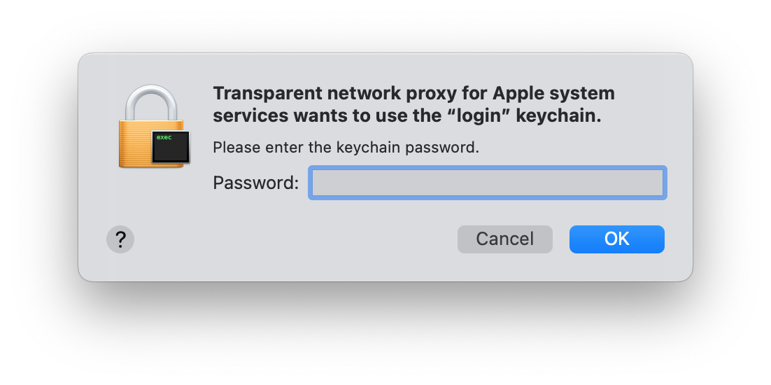

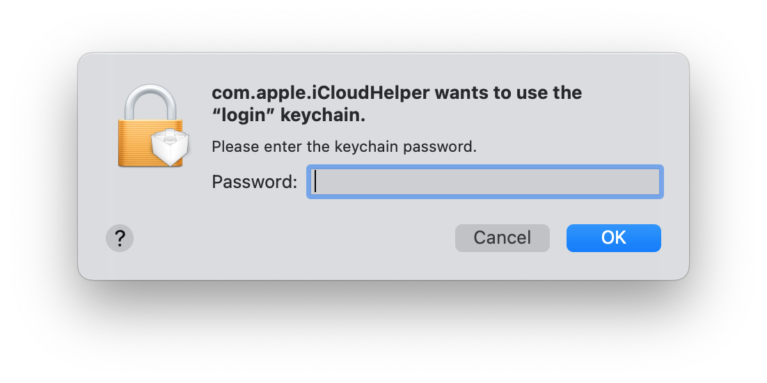

Adding to my msg just above, about every 15 or so, a dialog will pop up to ask for permission for some internal macOS service or utility (as if some process died and various processes are restarting). Two examples shown below.
(Guess this does point to something like SIP issues, even though the direct app crashes are all related to direct keyboard or mouse input 😉)
HTH,

ETA: Disabling Sidecar via OCLP seemed to work so far, but other report that this issue goes away for a while after a reboot. I do know that my Displays control panel now opens while before the change/reboot it didn't load at all (all others did).

I first tried to disable sidecar and noticed that my "Display" menu in Settings was not loading at all. I shut down the mac, rebooted and then I was able to access the "Display - Advanced". Turned off the sidecar option and now it's not crashing anymore.
I'm not sure if the problem will return, but it seems a Sidecar-related bug. I didn't rebuild or reinstalled OCLP. Just rebooted, went straight to Display settings and turned off Sidecar.
Another positive vote for @murdock1234's suggestion in note #19. Tried it on my MBP 10,1 running Ventura 13.2 (22D49), with OCLP v0.6.1 and the "crashing on arrow keys" problem has disappeared (reported in my note #13). Kudos to @murdock1234.
