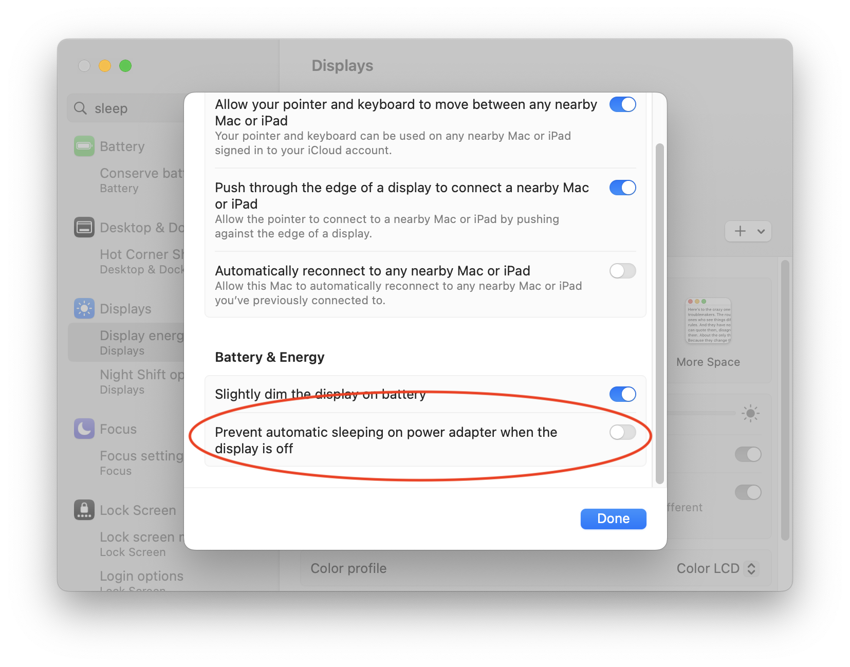

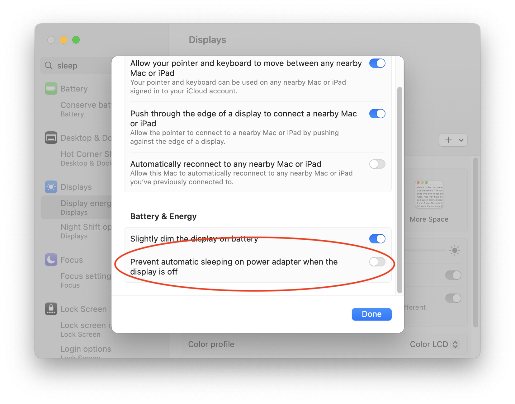

It's not unusable. Try setting the MacBook Pro to never sleep when connected to the power adapter. Use a hot corner to put turn off the displays or just let them turn off after a set time.
Yes I have that setting enabled. I found it through trial and error that reduces the occurrence of the problem - but it does not eliminate it entirely.
