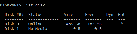

When I run command prompt and list the disks I see that the ram is freed up.

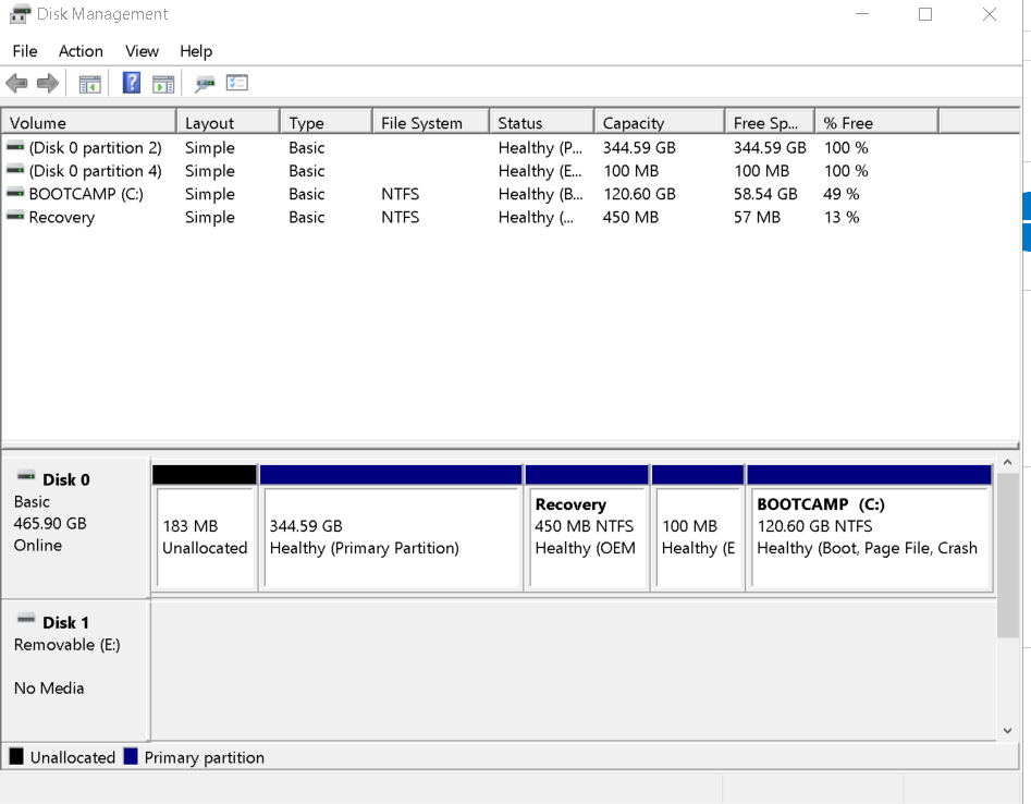

[doublepost=1534035490][/doublepost]Because when you have to make a bootable flash drive from bootcamp, it asks to add Bootcamp utilities, and also it asks how big you want the partition to be. and When I installed windows, I selected the smaller 120gb partition to install it on.
[doublepost=1534043149][/doublepost]Seems as if it is empty since its 100% free... Do you think installing a new MACOS would resolve anything? Or do you think its a bug from windows end not being able to properly read macOS files, because I tried Internet Recovery or w.e Command R -> brings up mac features & bar so I dont know what to think right now.

The 183 MB partition should be your macOS EFI partition which contains the boot info.
The 344.59 GB partition should be where macOS is installed.
The 450 MB partition should be your macOS Recovery partition. You normally should be able to boot to this by holding down Command + R.
The 100 MB partition - I don't know.
And lastly, the 120.60 GB is Windows.
I hope someone can figure out how you can either reinstall macOS or if it's still there, get it to boot.

Well, I'm not an expert in partitions, but this seems odd to me. If the 450 MB partition is MacOS recovery, why does it have NTFS as its File System? NTFS can only be read by windows. Macs have to format such drives (I'm not saying that you should do this! Once again I'm no expert)
I too noticed that the partition labeled "Recovery" was formatted as NTFS. A Recovery partition on a Mac should be formatted to a Mac format. Which again leads me to believe macOS was overwritten during the Boot Camp process.
I believe member "Meghz" is probably going to have completely wipe that drive and reinstall macOS. That will mean a loss of data but without a backup there's not much else one can do.
The issue im having is, I never formatted the 350GIG, the recover I may have deleted when windows wouldnt allow me to click next for install. I thought there were too many partitions. I am positive I didnt delete the 350GIG portion of it.
