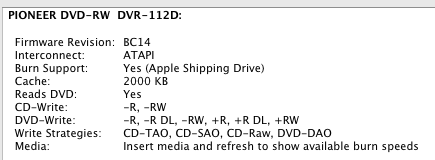

hey guys running in to the same issues:
19-25 min dvd backups just is not cutting it!!
i have the pioneer 112d
picture below!!
where do i gt the stuff and how do i eflash?
thanks!!
this will be way better ... i hope!🙂
picture below!!
thanks!!
bumpp...
and by the way, i tried to flash under windows and it did not work!!
i need to be able to rip dvd's in under 20 minutes!!
please assist me in the flashing !!!!
thanks
And can the flashing be done in Fusion/XP?
