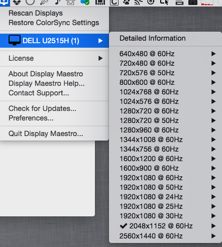

2. All resolutions are recognized as "TV" resolutions. Why?
If I try to set the resolution to the maximum of 2560x1440/60 Hertz the monitor goes black (no signal).
Actually I'm running 2048x1152, which is fine.

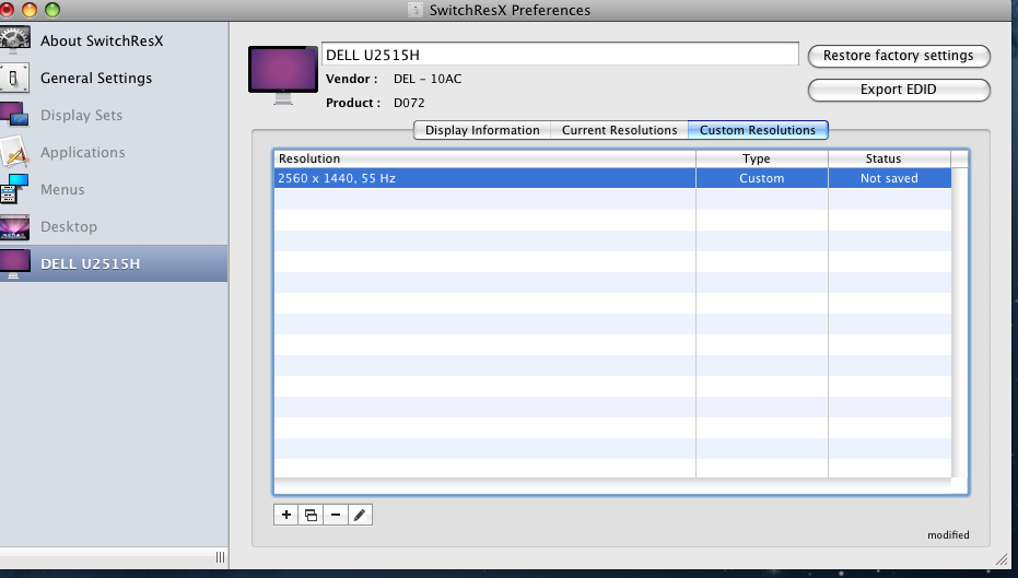

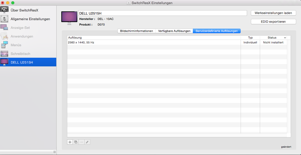

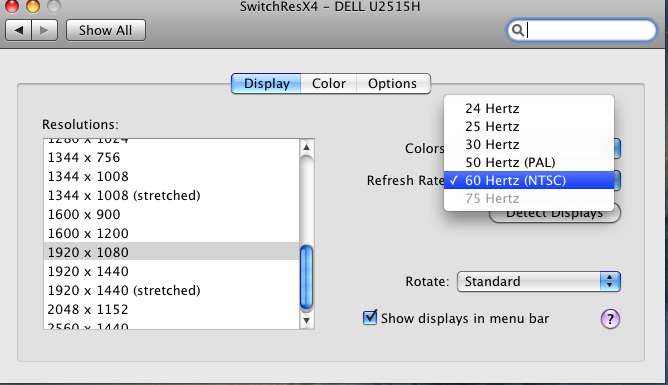

3. Now. I'm trying so set a resolution of 2560x1440 with let's say 55 or 50 Hertz, but I can't activate the resolution with SwitchRes.
I have only the Demo for the moment
Does one know how to activate a custom resolution in SwitchRes? It says "not installed".
