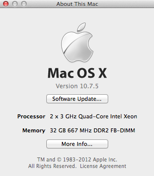

I can confirm that I have successfully upgraded my MacPro with Intel Xeon X5365 @ 3.00 GHz 2 processors, 8 cores 😎
Following this HowTo on Youtube it was a bit of struggle here and there (especially with front fans removal and getting it back in place) but at the end Mac booted with 2 new CPUs 😱

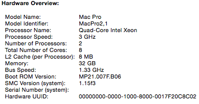

here are some screen grabs with new CPUs

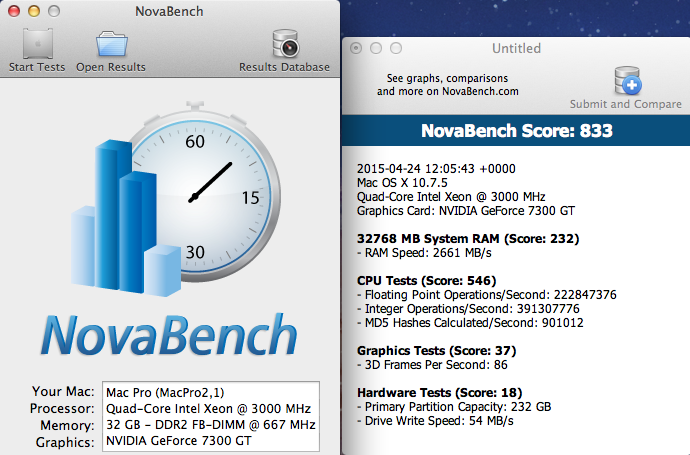

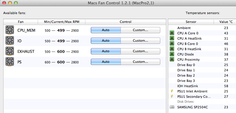

I also run small benchmarks Geekbench and Novabench just to see what temperatures will be before and after benchmarks
BEFORE BENCHMARK TEMPS
AFTER BENCHMARL TEMPS
please do tell me is it normal for CPUs to have different temps (3C difference !?) or it's too early because of the paste that didn't started to do it's job? 🙂
I have also read somewhere that just to be safe I should kick fans to a minimum of 800 RPM ... just in case ... should I?
and here are benchmark results
Geekbeench
3 degrees Celsius = 276.15 kelvin
?? now i am confused 🙁
Sorry to confuse you, it was meant as a difference, not absolute temperature. 10 Kelvin is just the difference between 30 °C and 40°C, for example.

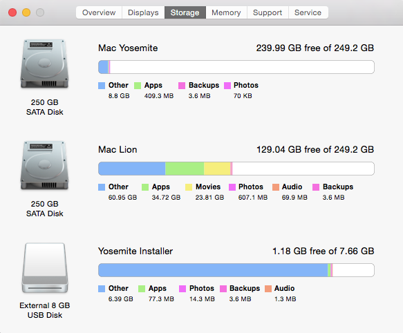

now here is the hint ... as 7300GT is not supported in Yosemite I did next thing
I have created bootable USB with pre-patched Piker-Alpha bootable Yosemite installer and I restored it to a USB flash drive using Disk Utility.
This is all nicely explained in other post by Mr. Zarniwoop so credit for this goes to him, as well as to other great people like Hennesie2000, Pike, Tiamo...

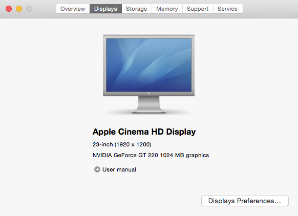

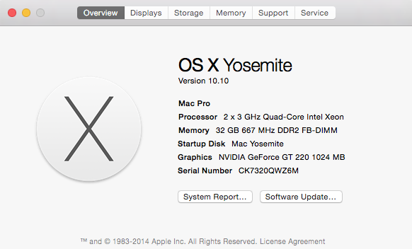

Then to be sure i restarted Mac and tried to boot to USB via holding ALT key and it is bootable. So i shut down Mac swap 7300GT with nVidia 220GT and booted to OS X Lion without boot screen and knowing that i won't be able to boot to USB via holding ALT key I simply selected USB as a startup disk:
:apple: > System Preferences > Startup Disk ... select USB and hit RESTART button
it was a long restart but after a while OS X Yosemite Installation screen appeared and after 20min things are looking like this now 😎
OS X Yosemite is successfully installed and is working 🙂

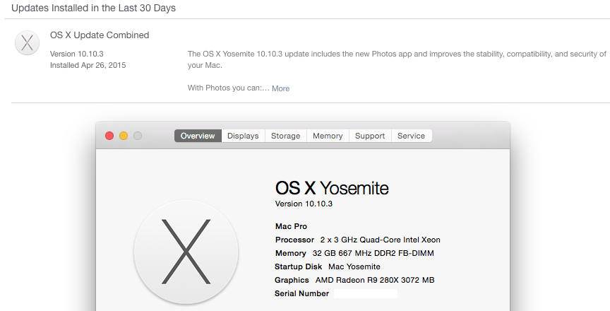

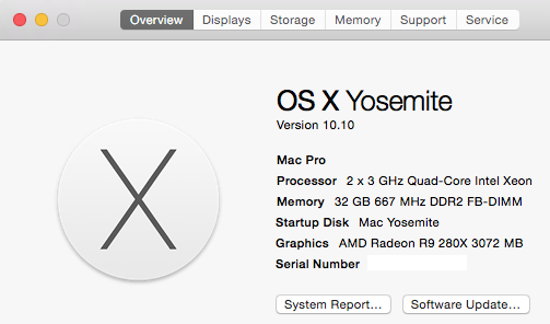

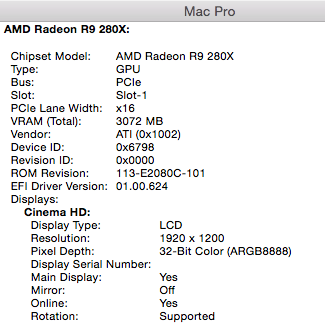

GPU UPGRADED and MacPro is equipped with MSI R9 280X
This GPU card is a big one ... no more room inside MacPro case as it used to be 😱
Anyway GPU in place, Apple logo and boot screen and here are some screen grabs
it looks OK so next day i will test it's performance and watch for the temperature

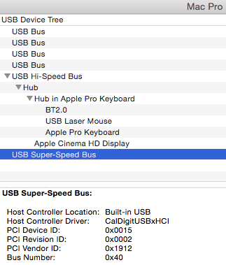

so i read somewhere that this cheap controler works on OS X using CalDigit kexts ... I acquired TS-PDU3, hooked it with 4pin MOLEX to SATA power cable from superdrive, used CalDigitFastIO.kext, CalDigitUSBxHCI.kext via KextUtility and one restart 🙂
it did somehow get recognised and is working
but I am not sure that speeds are OK or not

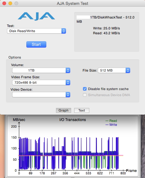

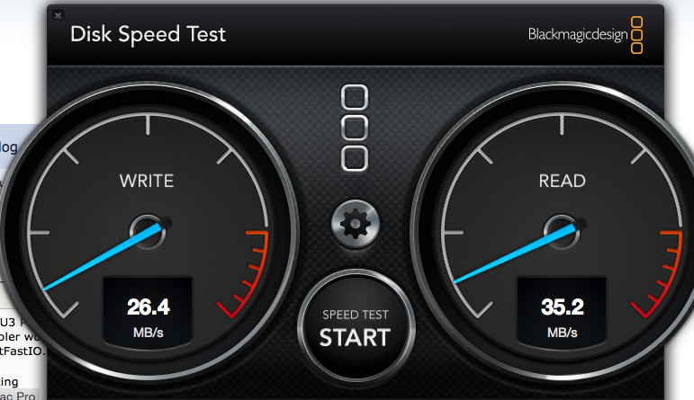

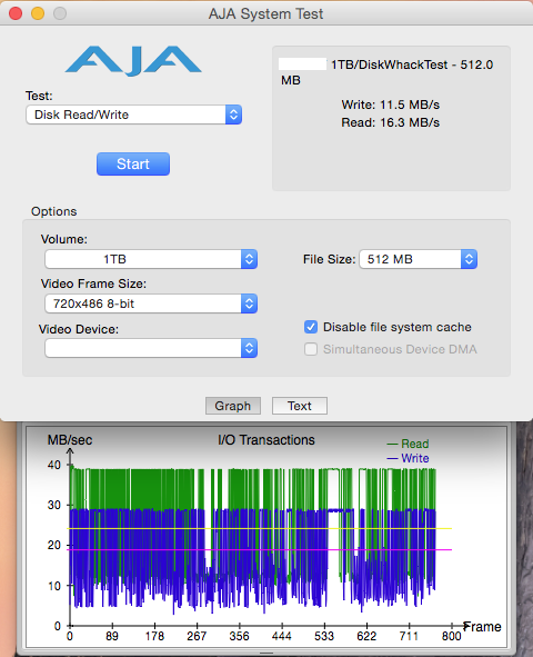

at this moment I only have one USB3.0 HDD so for test i run benchmark of disk speed via default Mac Pro USB2.0 port and same test with same HDD via Transcend TS-PDU3 PCIe USB3.0 so that i can compare results and this is what I get
Toshiba USB3.0 1TB HDD via MacPro USB2.0
Toshiba USB3.0 1TB HDD via Transcend TS-PDU3 USB3.0
it is faster but I have expected for read/write speed to be 70,80MB/s or more
I will have to test it with another USB3.0 HDD

OK ... so summer is starting, AIR temperature is 31C and first instabilities are shown
I did some heavy rendering from USB3.0 external HDD via TRANSCEND PCIe and when MacPro is full loaded (CPU&GPU intensive rendering at same time), inside temp is very HIGH (around 80-85C) USB HDDs start to click so I was scared and stopped rendering job ... had to restart MacPro and kernel panic showed up. As soon as I disconnected external HDDs from Transcend PCIe I could start up MacPro again while they are connected kernel panic shows up ... so I disconnected them again let MacPro chill down and everything is same as before, and I continued rendering again and again when temp are high enough scenario is the same ... HDDs are clicking and I have to chill down MacPro and disconnect USB HDDs so I can start Mac again.
strangely fans are at 500-600rpm even at full load ... no auto boost or I have to click something for that to happen ?
Also some GPU glitches are shown now and there ... any ideas?
When you know you are going to stress the system, just boost the fans to 1500 rpm before you begin. Try creating a few fan profiles to play with and test. See if you can keep under 65*C maybe 70*C - of course if the room ambient temps get warm just moving air alone isn't as effective.

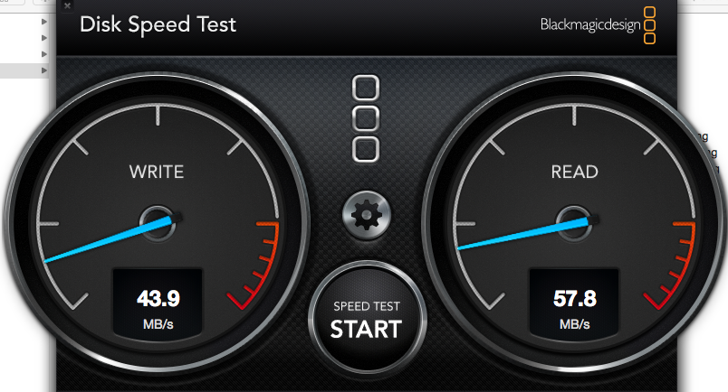

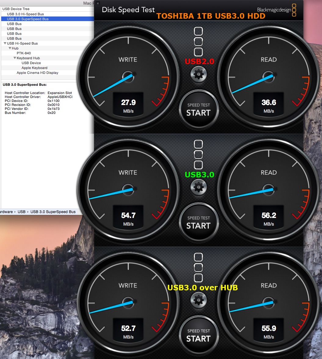

Here are some test results using my 1TB Toshiba USB3.0 HDD
Next thing that I will try is stress test ... I'll connect 3x USB3 HDDs and 1x SmartPhone and 1x Tablet and of course do some HDDs benchmarking while everything connected to HUB

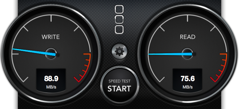

and here are some results with newer usb3.0 hdd WD Elements ... pretty satisfied 🙂
