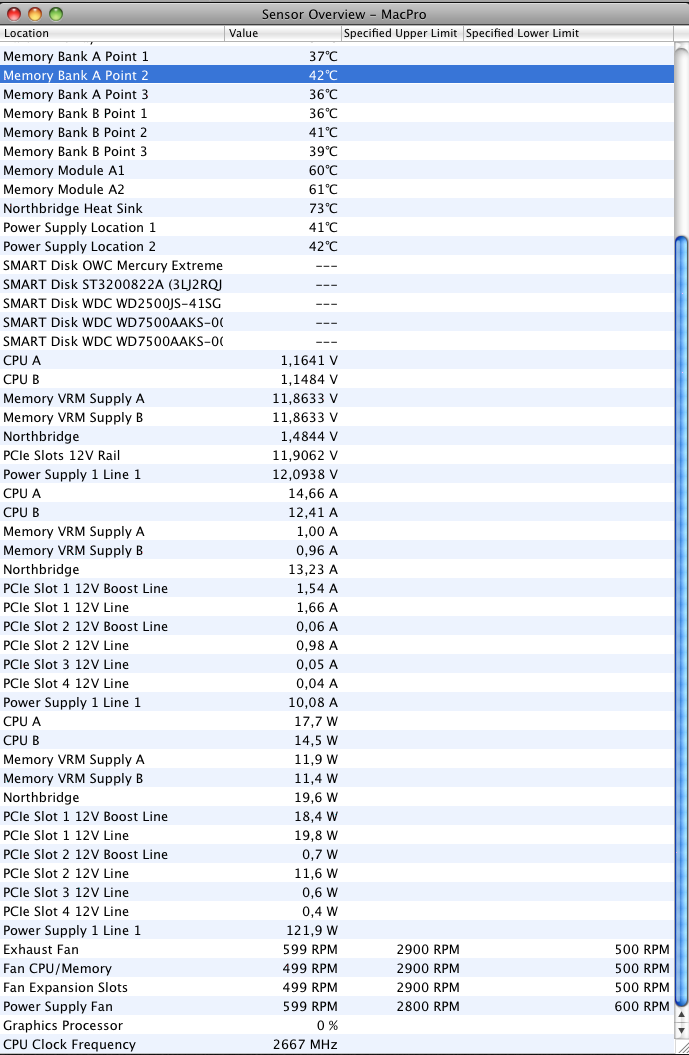

my MacPro shows consumption of app. 550-630W during idle. It is 2,66GHz 2006 model, with SSD disk as boot and 3GHz memory. Recently I installed ATI 4870 card, which seems to have increased the draw by app. 100W. Before it had the original Nvidia 7300 and the power meter showed app. 450W, which is still way more than reasonable, I think.
Attached is the screenshot from Hardware Monitor.
Any ideas where all the power goes? Whats wrong, this does not seems possible to me.

What are your energy saver settings in preferences? How long before your computer sleeps? How many hard drives do you have and what kind. How many pci-e cards and what kind? Many things affect power requirements. It may be normal for your system.

Hi,
its set to sleep in 15min, but it actually never does go to sleep mode, not sure what is the problem. There are two SATA HD, WD 750GB. NO other pci cards then the graphics.
I do not believe that is supposed to be normal, I have seen figures around 170w for idle MacPros, even on Apple pages.
Also I do not understand the reading from Hardware monitor, because it does not add up to such total. What is Power Supply Line 1 supposed to mean, I thought it it the total power going from power supply into the system, maybe less the fans?

How are you measuring idle power consumption. Nothing in your screenshot seems out of the ordinary to me... when i had an '06 Mac Pro, it never drew that much power when idle.
If I remember correctly, mine drew about 130w or so with the 7300gt measured on a kill-a-watt. When I added the upgraded ATI 2700xt ?? it went up by 50w or so.

Its digital plug-in meter, I guess very similar to what you call kill-a-watt.
Your numbers seem much more what I would expect. Thats why I am so confused where all the power goes.
Your CPUs are drawing power equal to about 30 % load. I have 2.66 too and when idle CPUs are never drawing more than 10 -11W, sometimes even below 10. Did you try to measure some other devices to exclude your power-meter malfunction?

test your power meter
Take your power meter and use it to measure the power of a variety of incandescent light bulbs you might have. Ideally you should measure 50, 100, and 150 watt bulbs. Then you will have a good idea of whether the meter is working.
Adding up the Watts displayed on the attached screenshot shows much lower power consumption than what your meter is reporting.
[edit] Also I think that recent Mac Pros have "power factor correction" in their power supplies. If the 2006 model didn't do that, then the load presented by the power supply will not approximate a resistive load. It's possible that your meter is confused by that.
The screenshot also doesn't seem to report power consumption by the disk drives. But that still wouldn't nearly account for the discrepancy you're seeing between the sum of Watts reported and what your meter says.
Thanks, your post confirmed my suspicion, that the number is simply wrong. I did some testing and investigating the power meter and it indeed measured way off, for 100W bulb showed 220W. So after setting the power meter straight, the MacPro now gives 215 W on idle, which is about what shall be expected with ATI 4870 card inside, I believe.
Also the values from Hardware monitor now add up to the value measured by the power meter quite nicely.
The power meter actually indicates the power factor value and for MacPro its about 96, so the PSU probably has some correction even on the early models. For compact fluorescent bulb its about 65, for incandescent 100.
Once more thanks for showing the path...
