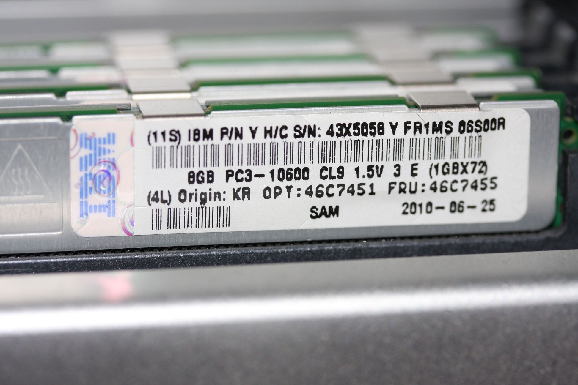

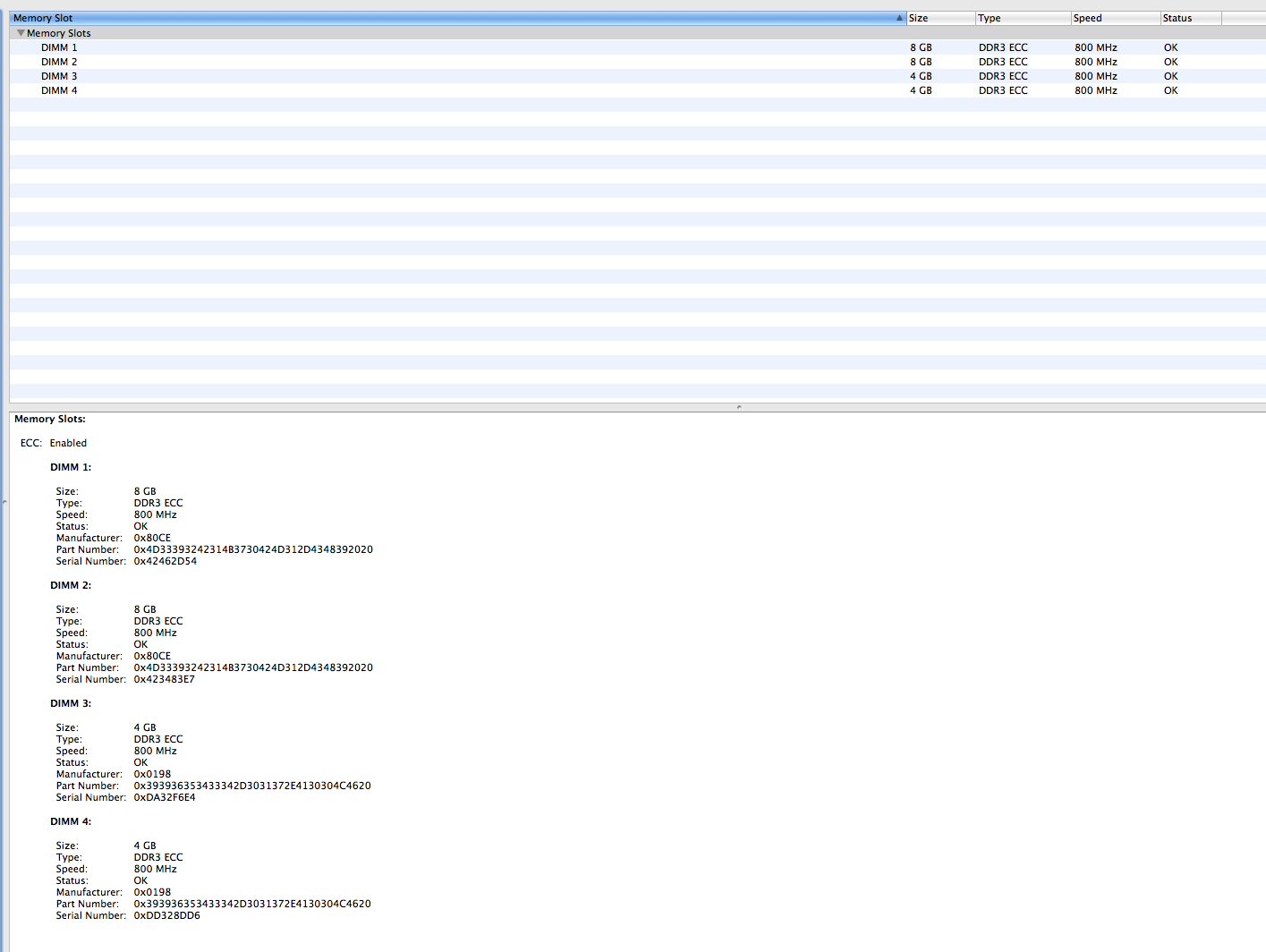

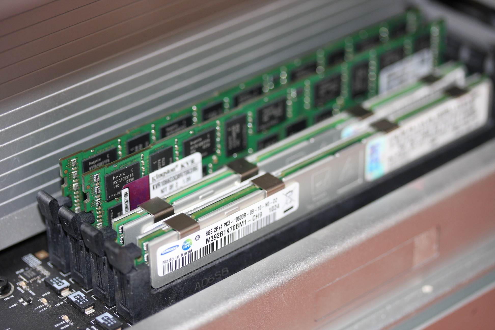

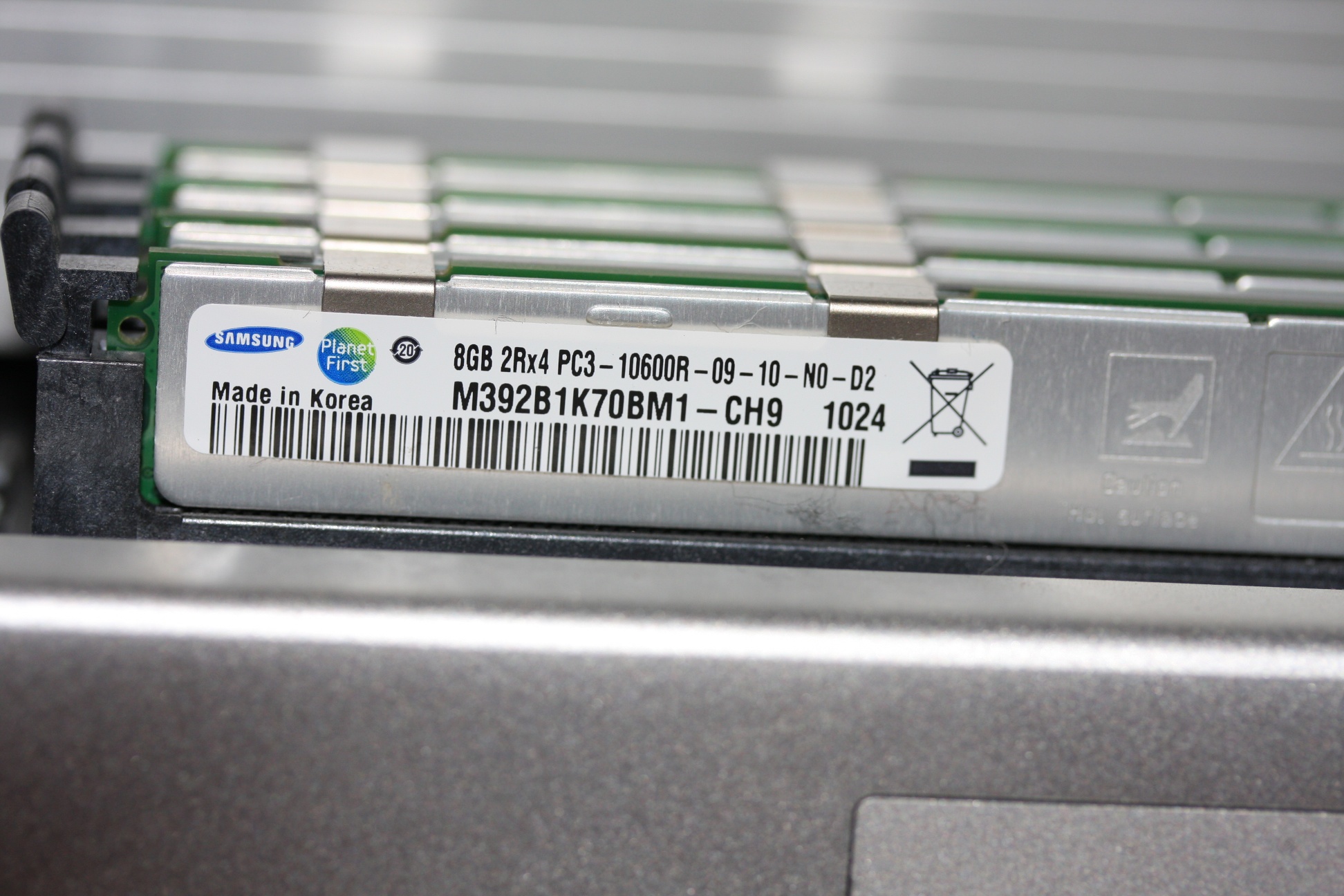

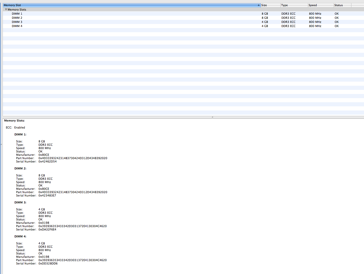

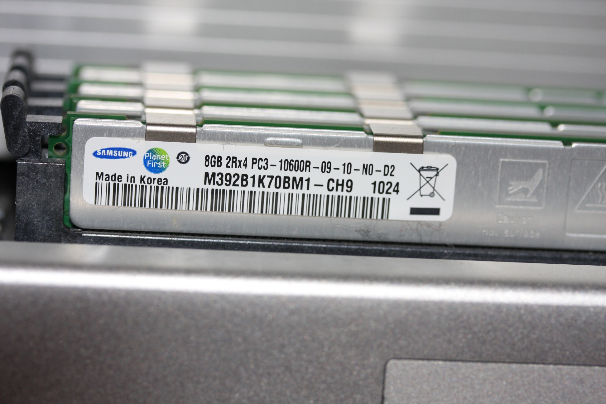

Hi Nanofrog I checked my modules and made some pictures for you to check the exact type of memory. Actually I was not aware there are different 8GB sticks around, so maybe I was just lucky buying these ...🙂
I like the IBM/Samsung sticks, they are for blade servers and are very low profile with a heat shield. I just got two more and I am running now 32GB. Although I think the 24GB was enough for me I prefer to run the same type of sticks 😱
I believe the IBM list price for those sticks is around 750 Euros per piece, but I could not resist to buy them for less than half of that on eBay.
Yeah you have RDIMMs. Your IBM 8GB DIMMs are quad ranked which enables manufacturers to produce them cheaper, but lowers the speed when a channel is populated with more than one DIMM (the 4th DIMM in a Mac Pro) as you see with your 800MHz speeds.
It's not with the 8GB modules you got lucky, but with the 4GB ones !
You should look into replacing the 4GB modules with one 8GB module to step up to 1066MHz.
