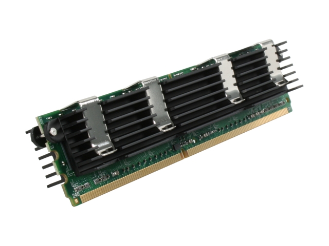

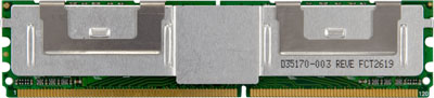

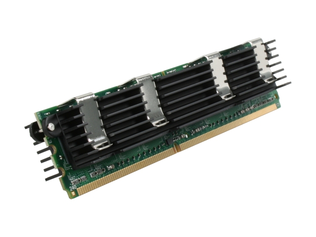

I've included some photos of my ram, hopefully you can all see.....
the 1st photo is a sample of the 2x4gb 667Mhz. ? unacceptable heat sink spreader for MPs
the 2nd photo is a sample of the 6x1GB 800Mhz.
thank you.

I have no idea why IowaLynn & b0fh666 think that you have bad memory because you haven't. You have 2 x 4GB + 6 x 1GB for a grand total of 14GB as correctly reported in About My Mac.
I have a Mac Pro 3,1 filled with 8 x 4GB 667Mhx parts for a grand total of 32GB & it's great for Premiere Pro, Photoshop, FP & other RAM intensive applications.
In your situation I would get at least 2 & preferably another 6 x 4GB 667MHz RAM sticks. Unfortunately the 1GB parts are of little value even if they are 800MHz.
The 667MHz parts run cooler than the 800MHz parts so don't need such big heat sinks which are in any case typical Apple over-engineering.
There are plenty of cheap used 667MHz parts pulled from Xeon servers. Unfortunately apart from Apple almost no other manufacturer used the 800MHz parts which is why they are more expensive.

Server FBDIMMs would have different RAM spreaders, and even some of those (but not 100% of em) work and don't exceed safe thermal levels.
Make sure that you can have even 30 days to know - and try them alone, not mixed with other DIMMs you have, first. The price is good.
AHT was good at checking FBDIMMs and Risers for hardware issues like parity test. So if you have the OEM DVD or a service disc try that too.
Get those 6 sticks from that guy, price is good. With a little fiddling you can transplant "big" heatspreaders to them from 1GB sticks, if you worry about temps. But it isn't a must.

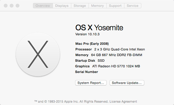

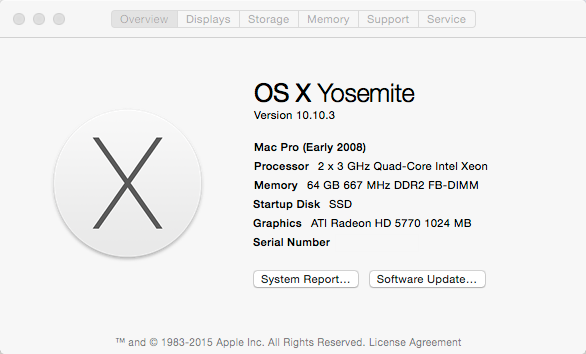

I have a similar setup but with 64GB 667-MHz Crucial server-grade memory modules and Premier loads in 4 to 5 secs... my boot time is anywhere between 15 and 19 seconds, from the chime, due to the initialization of the areca raid card ARC-1882IX-12. Boot/App drive is an encrypted Crucial M550 drive hooked up to a Sonnet Temp Pro SSD card.

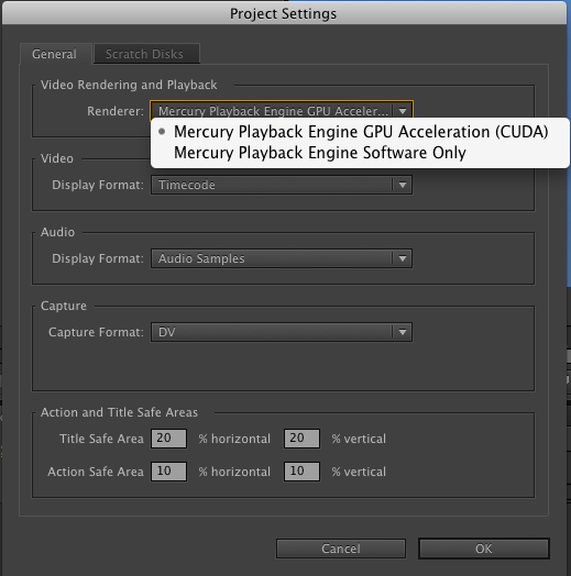

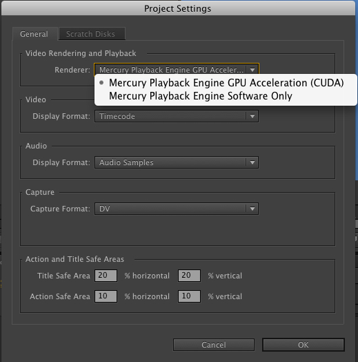

Since you have this video card, switch to use CUDA in Premiere Pro and see if the "performance" differs from that of the "32GB 667 Mhz" ram.
I will definitely do that.
so, do I also have to install the CUDA driver as well? so far, I just installed the web driver for the gtx 750 ti, instead of using the native OS X driver.
