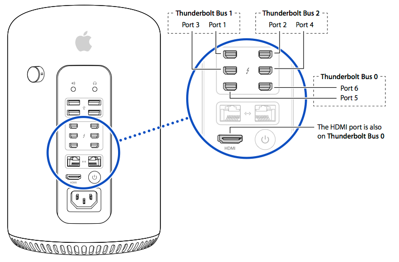

On the 6,1 the HDMI shares the same bus as the two bottom Thunderbolt ports.
Do you have both current monitors plugged into both of the bottom Thunderbolt ports?
On this page: http://support.apple.com/en-us/HT202801
It shows this image, which describes which ports are part of which bus.
Note that for optimal performance, Apple suggests you put each display on a different bus, i.e. 0, 1 or 2.
If you still have problems after shuffling your displays around on the ports, I do recall a friend of mine with a nMP that said he had problems with setup similar to yours. I can ask him what he did to resolve it. Let us know.

Hdmi was on lower bus.
