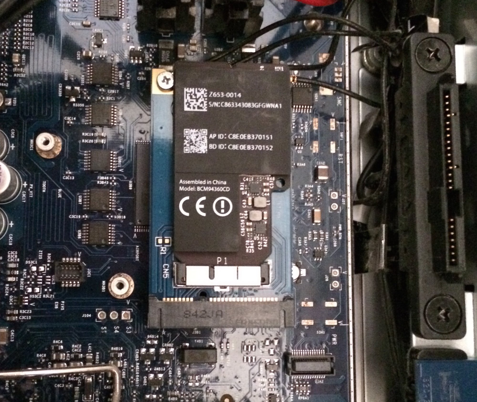

The 3,1 has USB in the mPCIe port as required by spec.
Apple chose not to follow that spec for 4,1/5,1 and those are the ones that need you to run extra cabling.
You might have a bad / fake card (or bad adapter), or you neglected to remove the original BT card and there is a conflict.
This is from my 3,1 ... the only thing connected are the 4 antenna wires.

Ok thank you. I’m leaning to bad fake card as I have removed existing BT card and as per your picture mine is installed accordingly. Thank you.
